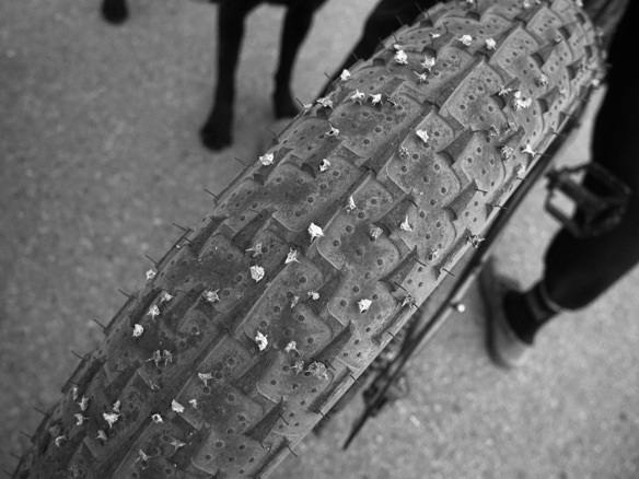

For some reason we have maturing yellow star thistles all along paths and where everything else has not developed RoundUp resistance. The thorns have microscopic barbs and they break off inside the rubber of the tread only to continue the one-way journey unseen.

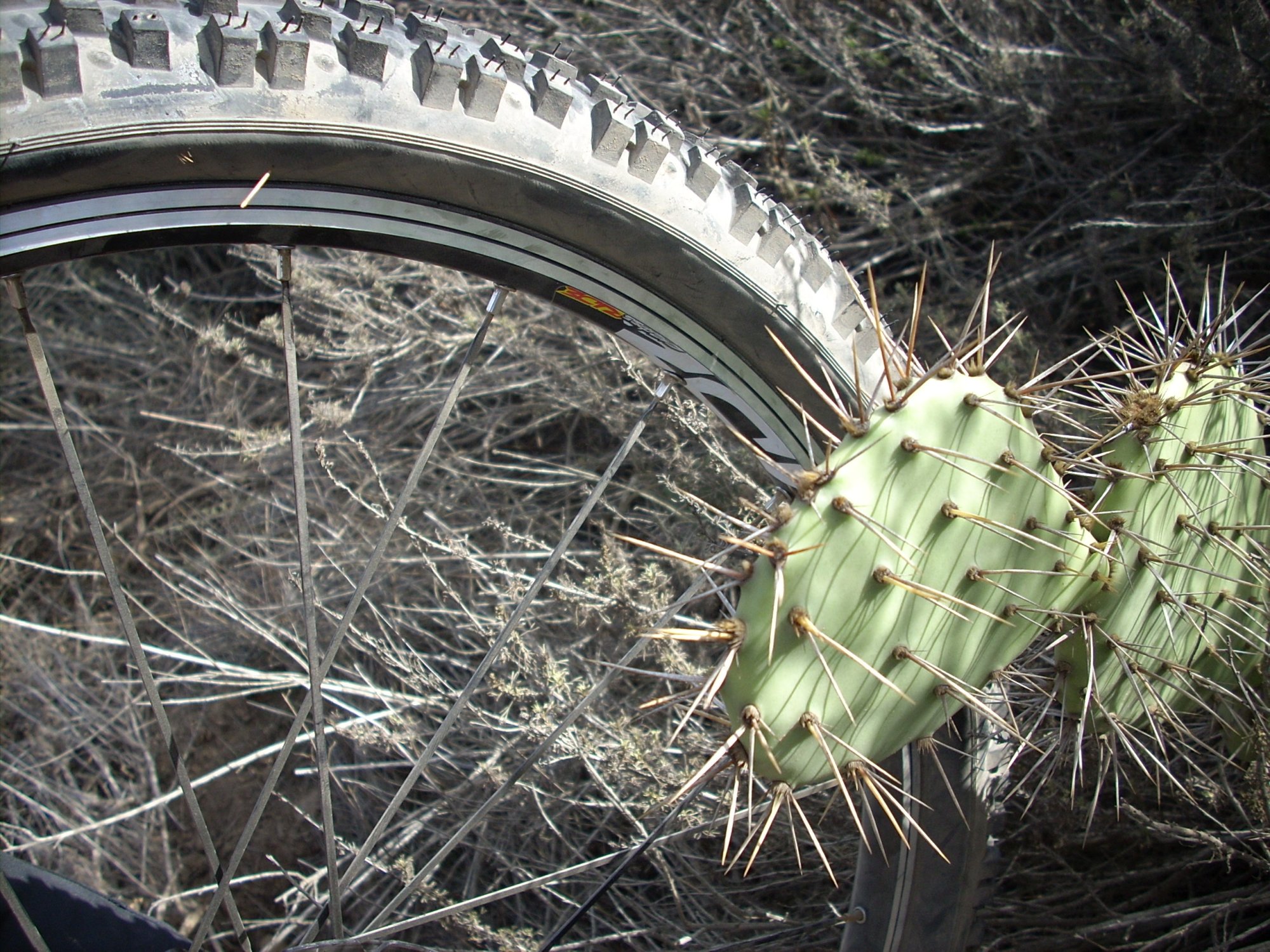

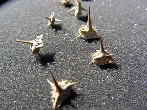

I haven't seen the Bull Thistle where I ride in central NM? We have a lot of goat heads and low to ground paddle cactus hiding in the tall grass/weeds being high desert (+5000 feet):
Internet photos below and the reason I like some type of liner and/or sealant. Can be a lot goat heads even on paved bike only lanes and unpaved improved bike trails.
