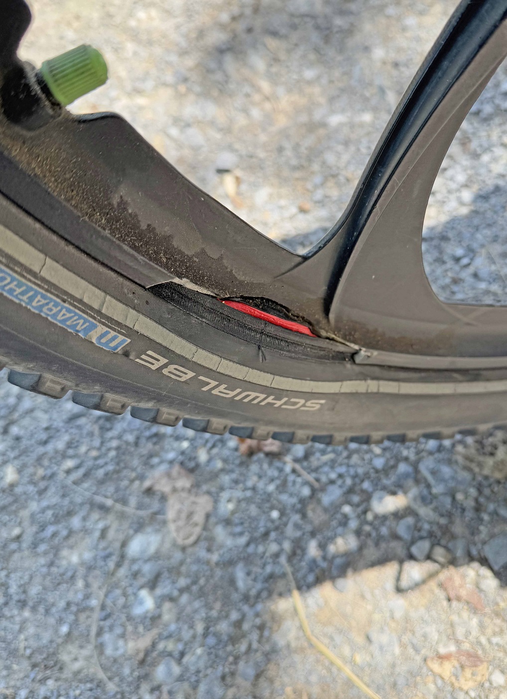

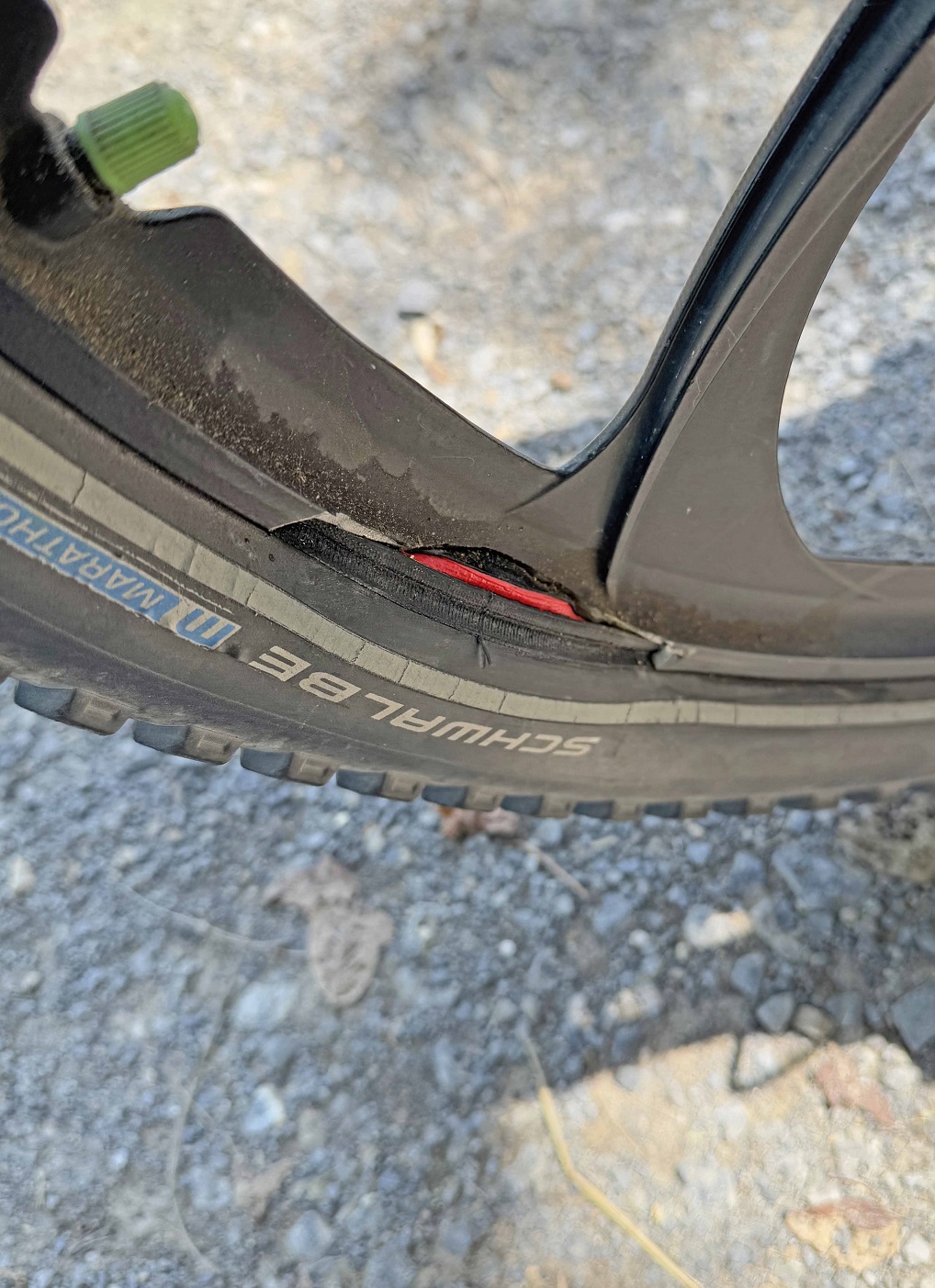

Yeah, I hate to give up on the Tannus. 5 seasons, two bikes and 15K miles without a flat. It did save my bacon recently when I hit a rock and broke a chunk out of my mag wheel rim. If it weren't for the stiff sidewall on the Tannus Armor, the tube would have blown out.
Not sure why I wasn't able to get the Tannus on this time. It was the same bike, same tire, same rim, same size tube and the same size Tannus. I've installed four of them before, have the tools and know most of the tricks. I used an excessive amount of force trying to seat the tire bead this time. I was afraid I was going to snap the bead wire or damage the rim. It was like trying to install a 24" tire on a 26" rim.

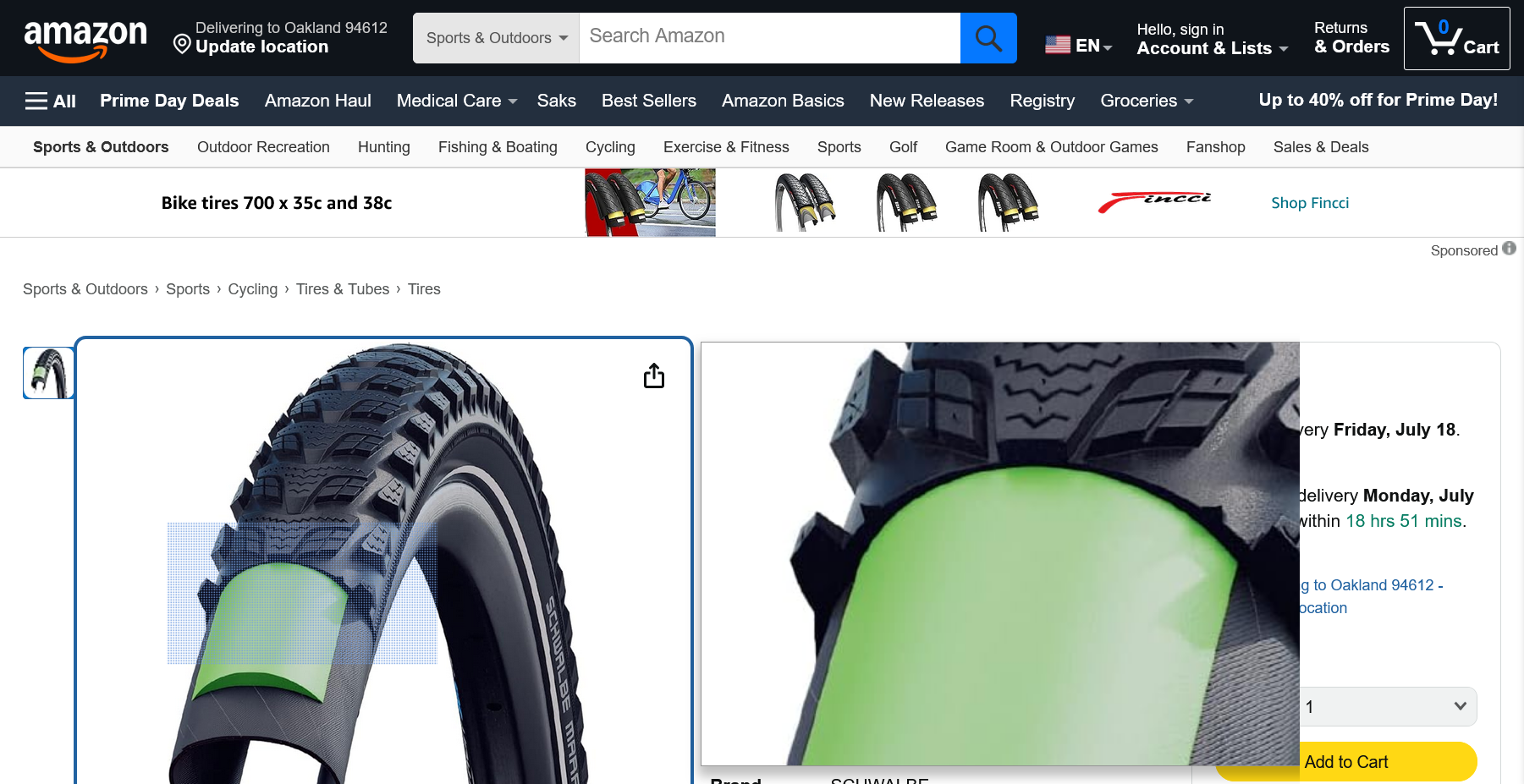

I will be sending a gravel bike to Mexico. It is getting these ones in 700 x 50.

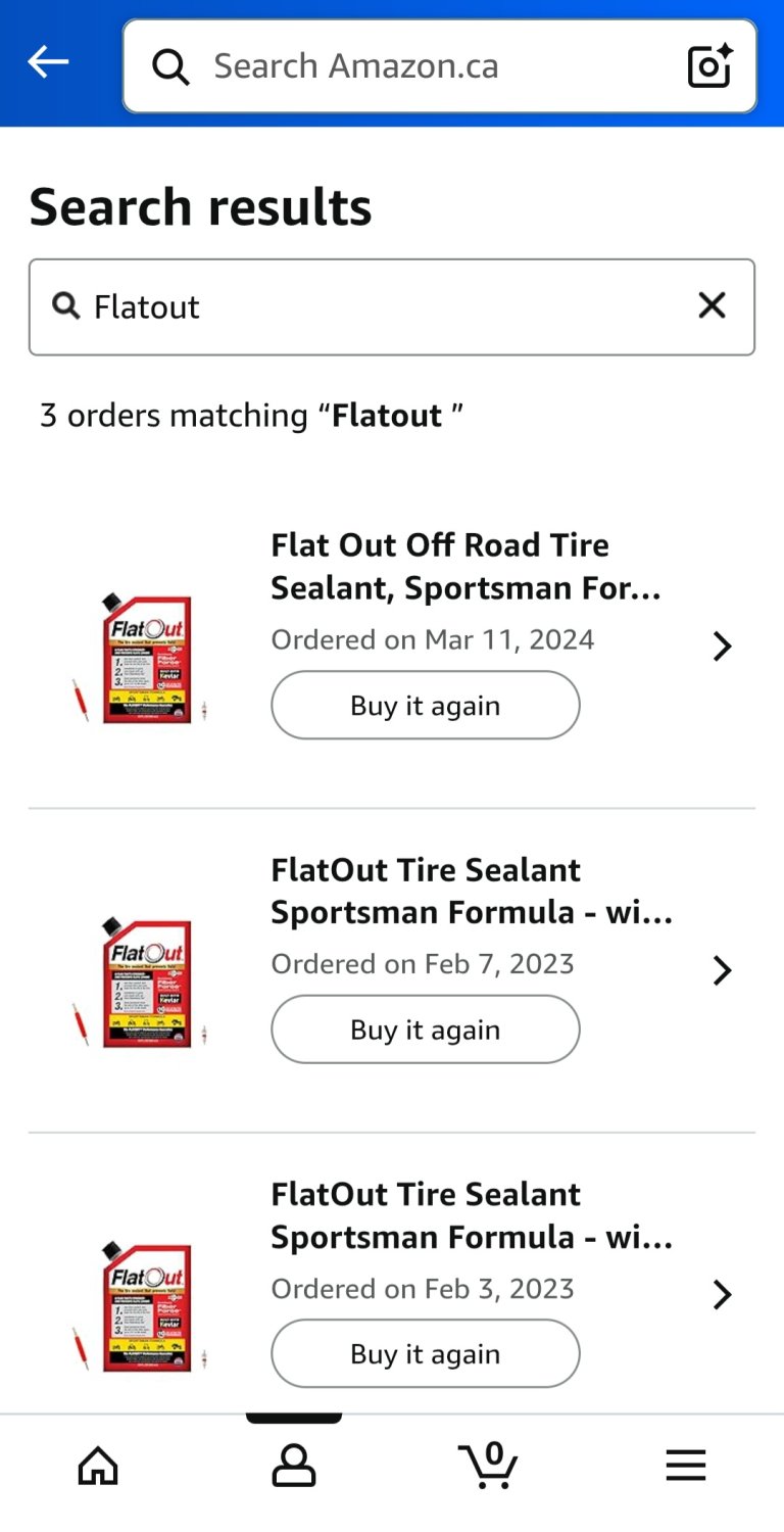

I've still got my $12 bottle of Slime on the shelf from 3 years ago then I found out about Flat-Out. (Sportsman Formula and Outdoor Power Equipment Formula)

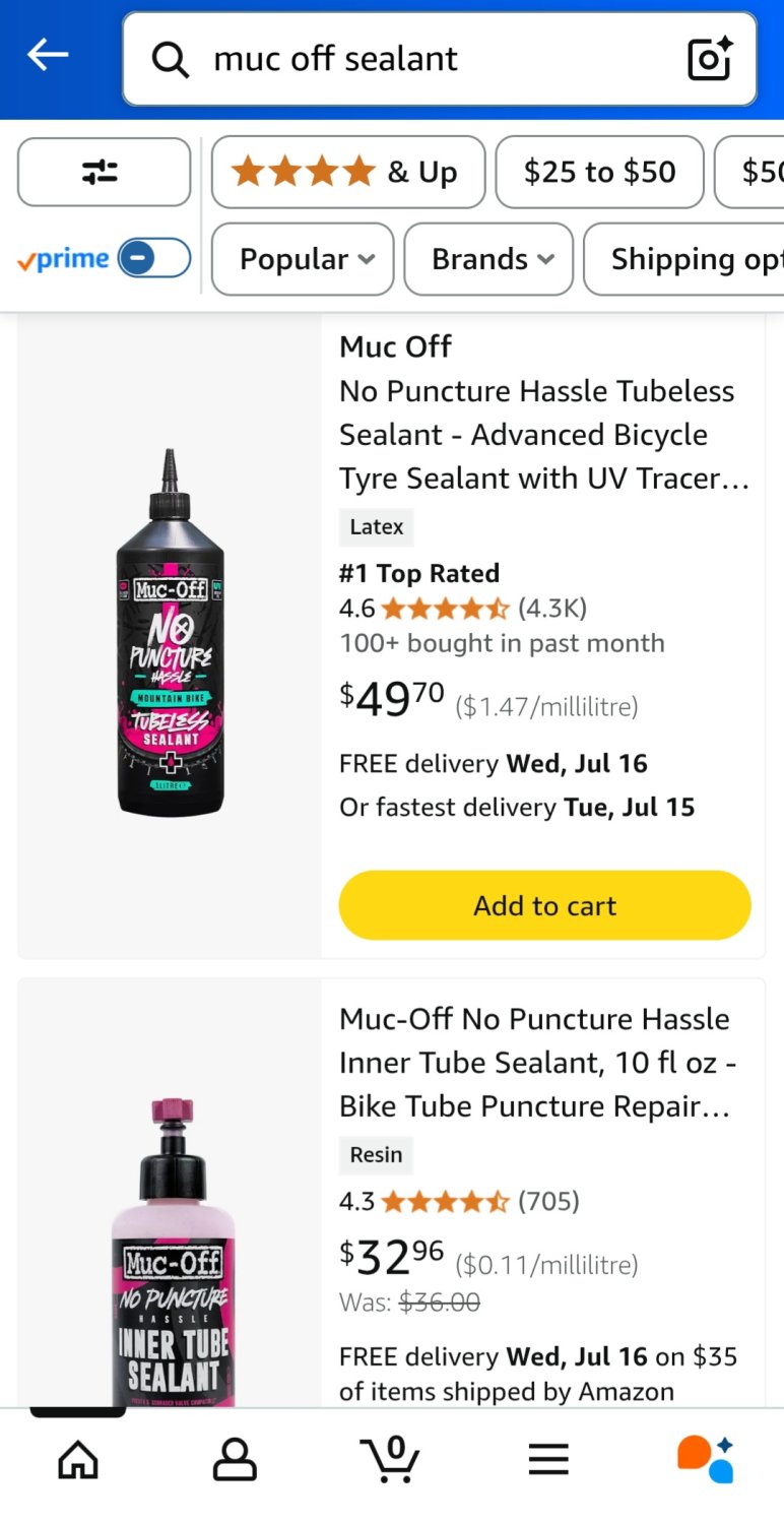

It cost me $50 CAD
The Mucoff sealant is the same price as the Flat-Out,..

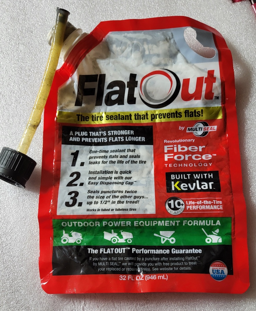

The Flat-Out comes in a bag now, and it works pretty slick.
You just squeeze the bag to inject the goo, so you don't have to invert a bottle.
It's easier to carry with you and takes up less space when it's half empty.
I use half a bag per tire.

I've had the Flat-Out in my first ebike since Feb. 2023 and it's been in my new ebike since May 2024.
I can still feel it in sloshing around in my new ebike's tires (27.5 X 2.80) when I spin up the wheel in the air. (I don't feel it when I ride?)
There's half a quart in each tube.
