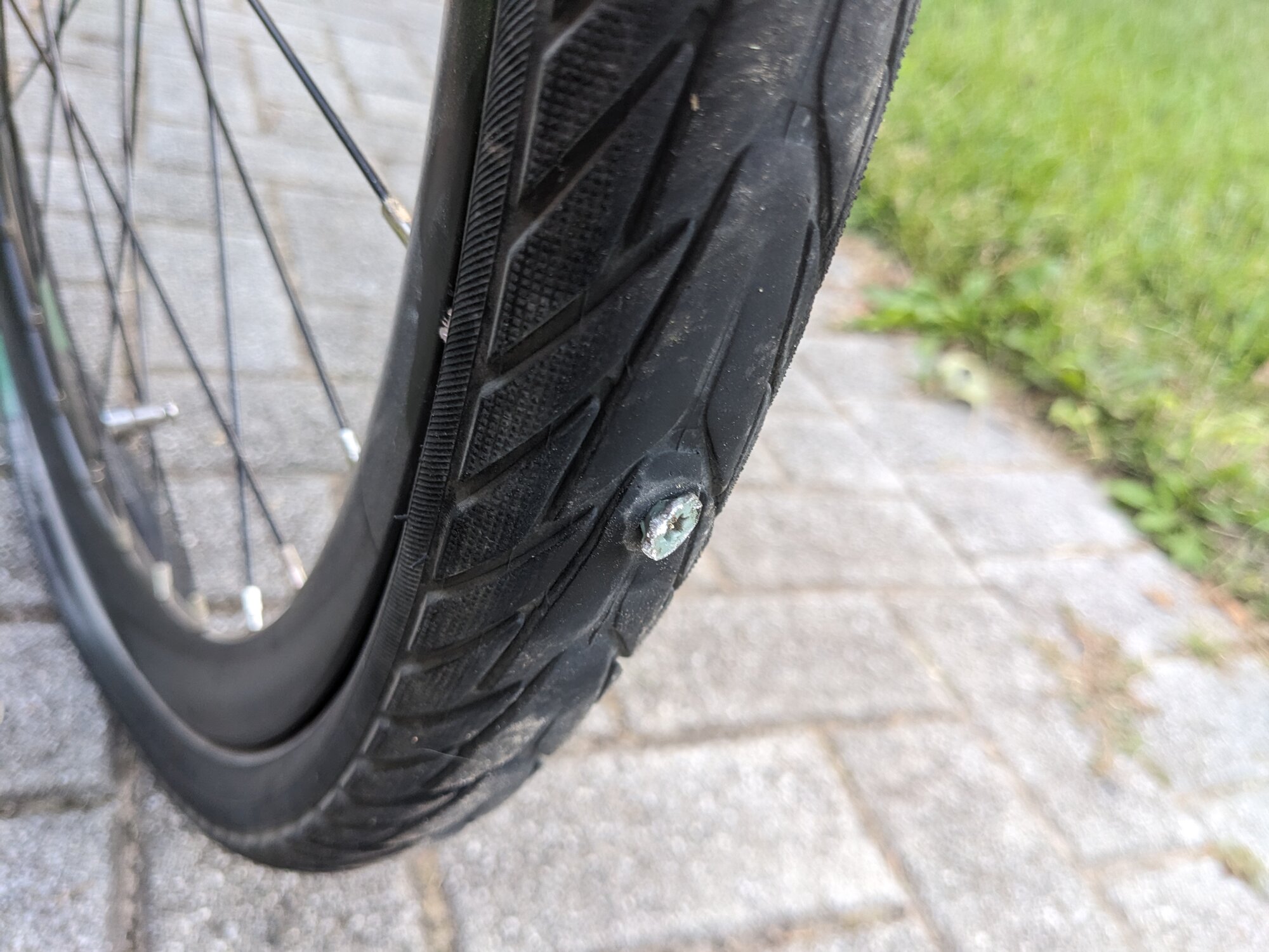

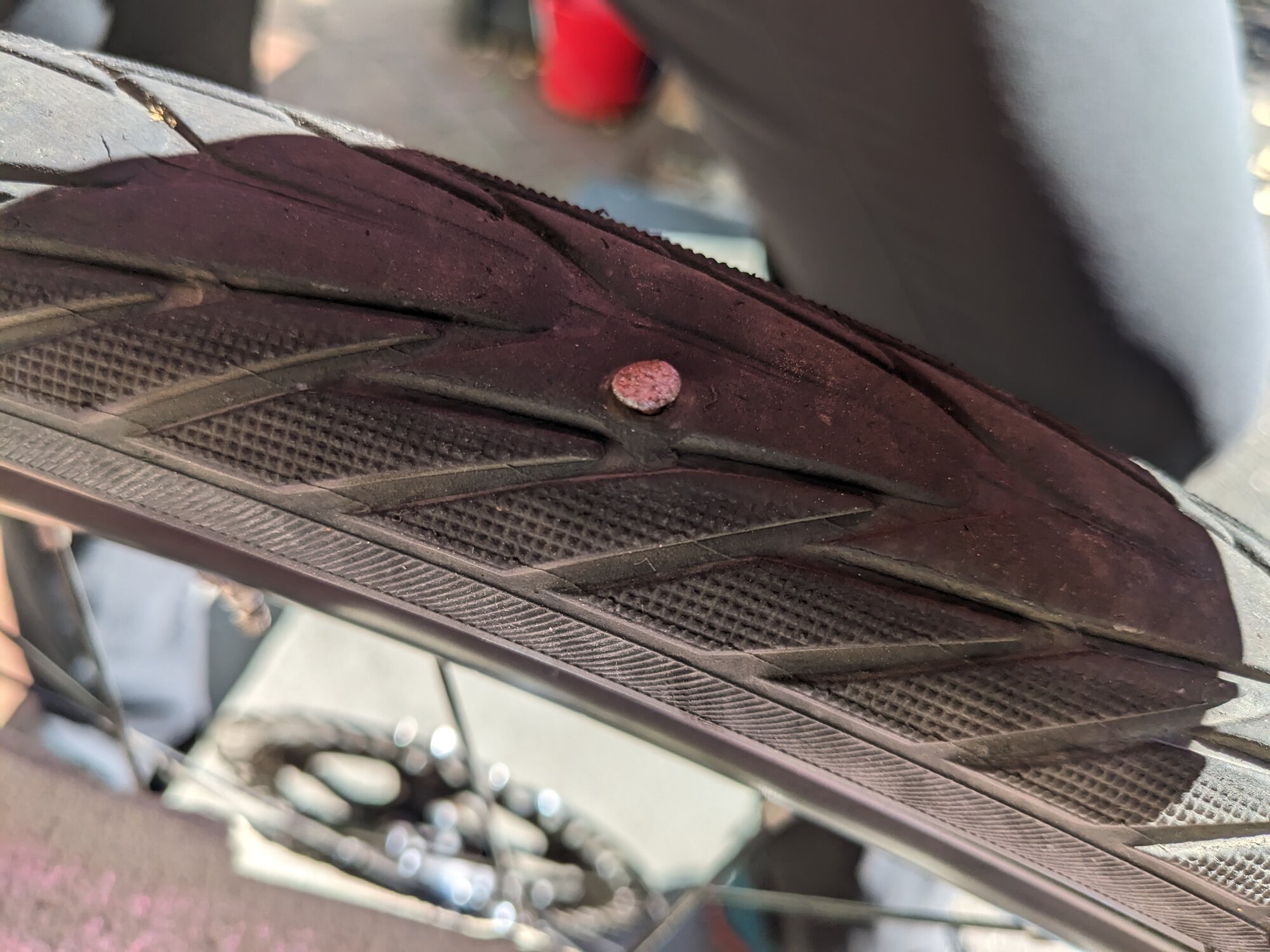

I probably spoiled by Schwalbe, but I don't know what small punctures are - it is either no puncture or it is pretty big! 🤣
Here are some photos of my last two - don't think tubeless will help here somehow...

Both of those could be fixed on the road with tire plugs, the one on the right might seal just fine on its own without much help.
View attachment 160088View attachment 160089
Left side is more tricky - the screw went out near rim, so there are 2 wholes and 2nd is very close to the rim. Also it damaged a rim a bit - I didn't notice it before and wasted 2 tubes, which got small holes damaged by the rim itself. May be this can also be patched easier with tubeless, but I personally will stay with tubes. It is probably more labor involved, but familiar and easy to do if you are prepared.
i can’t tell what the object in the second one is, but it’s entirely possible that a tubeless setup would not even have deflated below usable pressure until you removed the screw / object… at which point a couple plugs and a quick reinflation would have kept you rolling.
