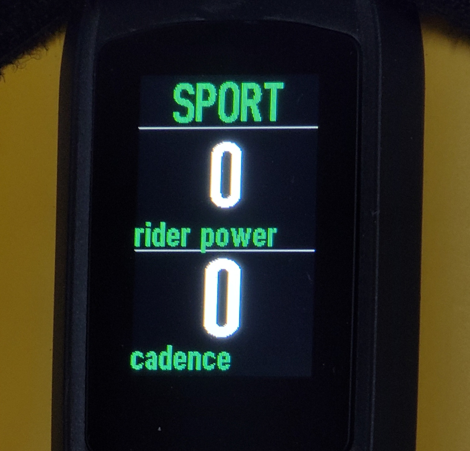

And how on earth does tire pressure affect cadence? Well, my own power maxes out at around 92 rpm these days, but only when I can keep the pedaling smooth.
Easily done above 90 rpm when the tires are below ~45 psi. But at higher pressures, the rear end of the bike starts resonating with my pedal strokes at these high cadences. Smooth pedaling then goes out the window, and power drops.
Weird, I know, but it's a totally reproducible phenomenon confirmed by the bike's display.

I do this for both ride quality and cadence. If there's a rolling resistance penalty, I don't notice it, and I often ride in OFF. But I do notice when the pressure gets down to ~35 psi.
