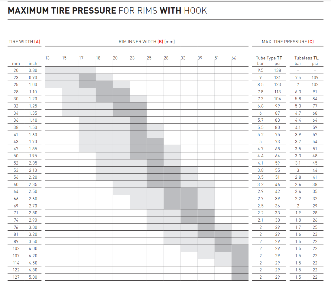

There's also a factor you seem to have overlooked. Each rim has its internal width (such as 25, 27, 30, or 35 mm). The rim is designed for a very specific tyre width so the latter works at the proper profile. Put too a narrow or too a wide tyre into a specific rim, and such a tyre gets improperly deflected, leading to poor performance and premature wear, especially for the side wall.
Bear in mind the bicycle wheel consists of as many as four components: the hub, the spokes, the rim, and the tyre, and each of these components affects all other!
Here is what DT Swiss recommends:
Your Trek wheel with a given inner rim width is designed for a very specific tyre width range! (It is probably a 30 mm rim).
Yes but I also want to go tubeless. 2” tires work great 3mph faster 8 extra mile range and a softer ride over 2.4” tires.
And later you wonder your rim has cracked.
Foofer, there's a notion called "engineering". Please do not try outsmart engineers :)

I'd go for the thicker rotor as the larger wear range is pointless if it fails prematurely due to abuse.

Just logged in here after a bit of an absence. Funnily enough this morning I was replacing the rear wheel on my Allant+ 8 - because I had discovered cracks exactly like those pictured. 10 spokes affected, all drive side. This is after just 3000 miles, but a fair bit of that was touring (with a tent - carrying 25kg plus me). The rim is an Alexrims MD35.
I have only ever had 1 other rim suffer from cracks, and that was about 15 years ago on a Ridgeback Panorama tourer. Guess what - Alexrims then too. And I was doing a lot of touring then - in fact I was on tour in France when it went.
My Allant is over 2 years old, so no warranty. I couldn't find any compatible wheels that had anything like 35mm internal width - in fact the widest I could find were Bontragers with 20mm internal width. The Super Moto X 2.4" tyres look a bit odd on that rim, but they are within the ETRTO limits so should be OK. we'll see.
My takeaway is avoid Alexrims (at least on the back) if you like touring; and if you need to change rims expect to get something a lot narrower (at least here in the UK - may be different elsewhere).
Must say I think 3000 miles, even with the touring, is a very poor showing indeed.
ya I dont want that wide of a rim. but a velocity cliffhanger can handle the bigger tires. I think I will go with the same as my other bikes some dt-swiss rims.
