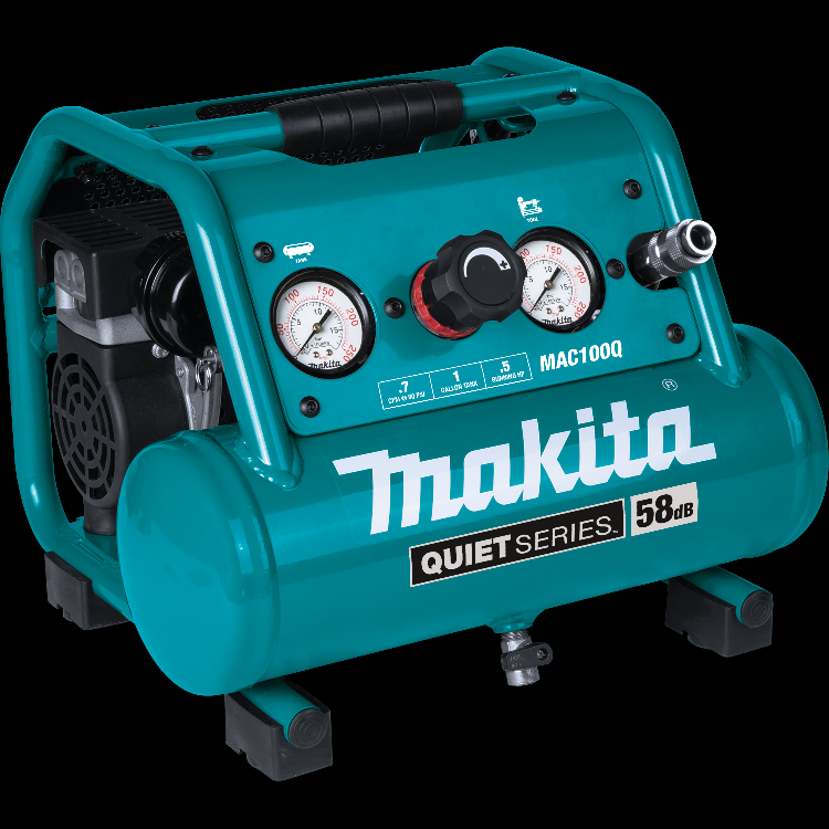

And man, I don't see how anyone gets by without a compressor. I use mine daily.

Most of my tires I can get seated with just my Makita inflator. You can also use co-2 or get one of those bottles you pump up and then use. Or a tube.
