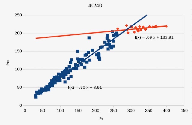

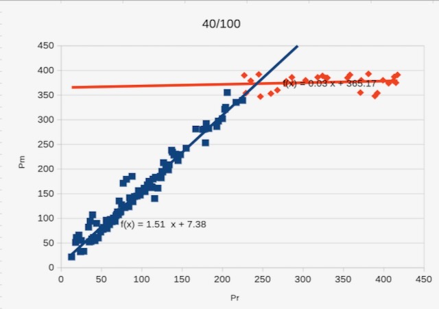

A new trial, a little longer and with more rider effort to more clearly define Pm saturation values. I just did 40/40 and 40/100.

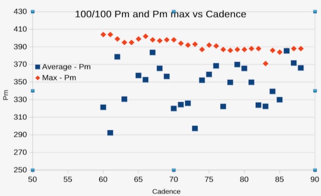

Q: Just to be careful, your cadences on these trials?
Again, strong confirmation that Pm really is linear in Pr before saturation and almost flat in Pr after. So that part of my simple Pm model holds fairly well. And that makes our reverse-engineering task much easier.

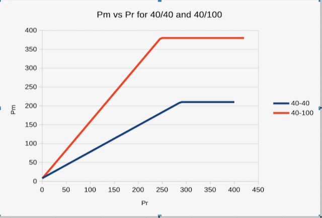

and my comparison plotting the functions together:

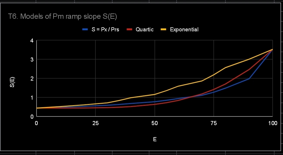

Excellent! Writing an assist mode as E/M, let
Pe = electrical motor power
Prs = rider power Pr at the saturation point where ramp meets flat
Pes = Pe at Prs
Pex = Pes at M = 100
S = ramp slope.
Took the S values below from the .FIT file linear regressions and visually estimated the Prs and Pes values from your summary graph.
For Ride 1 at 40/40, Prs1 ≈ 285W, Pes1 ≈ 210W, and S1 = 0.7
For Ride 2 at 40/100, Prs2 ≈ 245W, Pes2 = Pex ≈ 380W, and S2 = 1.51.
In principle, we should get S1 ≈ Pes1 / Prs1 = 210 / 285 = 0.74 and S2 ≈ Pes2 / Prs2 = 380 / 245 = 1.55. And in both cases, we get reasonable agreement. So far, so good!

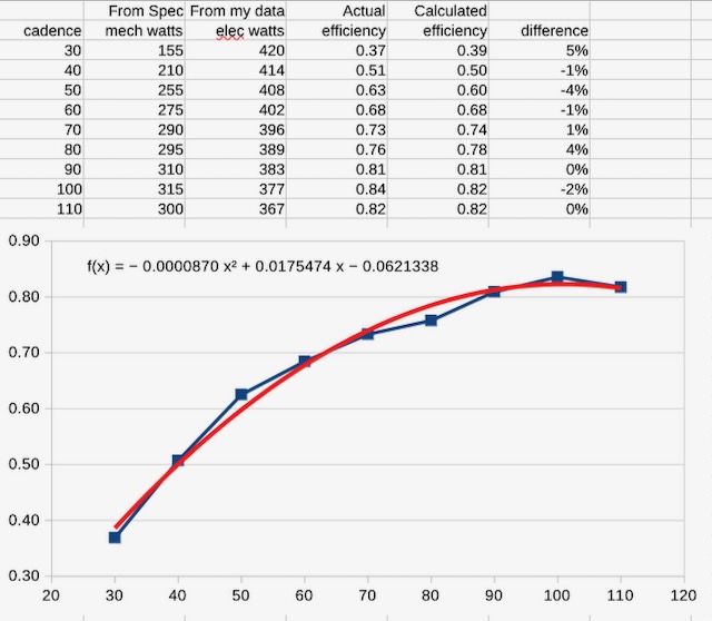

So Pes must be more complicated than the simple model assumes. Efficiency variation via cadence could be involved.
