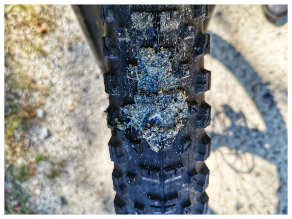

I do not say tubeless is absolutely wrong, no. I was very happy with tubeless on my former e-MTB. The setup saved my bacon on a ride in a West Pomeranian wilderness in summer 2020. A piece of quartzite made a hole in my front tyre. I even had no tubeless repair set with me! Eventually, the "milk" could seal the hole, I could reinflate the tyre and continue my ride. Owned I an e-MTB still, I would certainly maintain it tubeless. I simply see no reason to fight with the tubeless on 42 mm gravel tyres.
