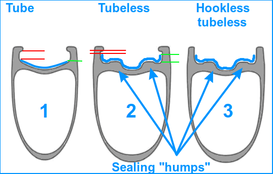

One easy way to see how well a tire will seat is if the bead sits on the center of the rim, it will be hard. I have some Schwalbe tires that the bead is as wide or wider than the tire, and it seals with just a regular pump, but it makes it harder to get on as the first side likes to come off while trying to get the second on.
