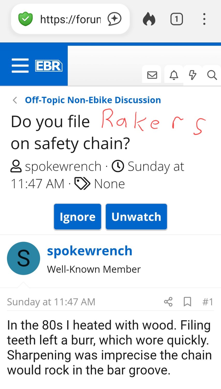

Rakers is a much better word.
I fixed the original post,.. 😁

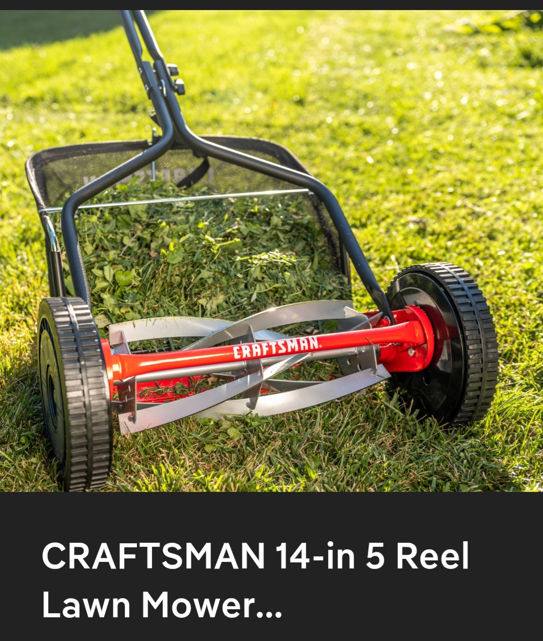

I went to work at a golf course in 1969. For greens we used walk-behind reel mowers.
Was it powered by an engine?
I remember those manual push reel mowers.
They were a lot of work, and I kept having to "wind" the thing up with a back and forth motion to get the reel spinning fast enough to cut.

real exercise,Reo used to make a powered "reel" mower,most golf courses around here use "gang" mowers of the "reel" variety( my 6th grade teacher used to try to teach us the "Virginia Reel",she said other countries were jealous of this dance) really?

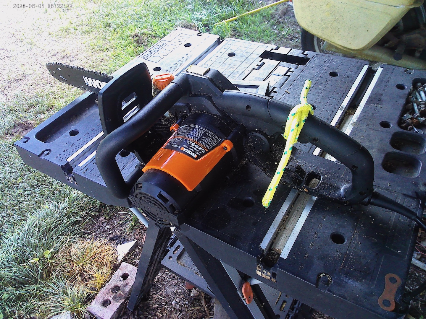

After I filed the depth gauges and it made little difference on stumps, I ordered a chrome-plated chain. I haven't used it. Before it arrived, I discovered that I hadn't gotten the old chain properly sharp. Near ground level, stump wood can be like steel. A wafer 1/8" thick can be incredibly heavy, stiff, and unbreakable. That old chain is incredible!
When I sharpen, I tie the trigger so the chain will turn. I usually used a shoestring. This time it was a black velcro strap. When I finished sharpening this time, I applied some oil to the bar, then plugged the saw in so I could spin the chain to distribute the oil. Whizzzzzzz! Yikes! I'd forgotten the strap on the trigger.
This time, the chain wasn't resting on anything. Another time, I might not be so lucky. Now I keep a piece of highly visible rope in my saw sharpening box. The leg I save might be my own!
Most of my Ryobi tools have a safety switch that has to be pushed before the trigger will work.
I taped the safety switch on my weed eater and grinder because I've been bit by those tools a few times, and it ain't that bad. Lol
My chainsaw and circular saw kinda freak me out though.
I ain't never been bitten by one, and I don't want to be. 😁

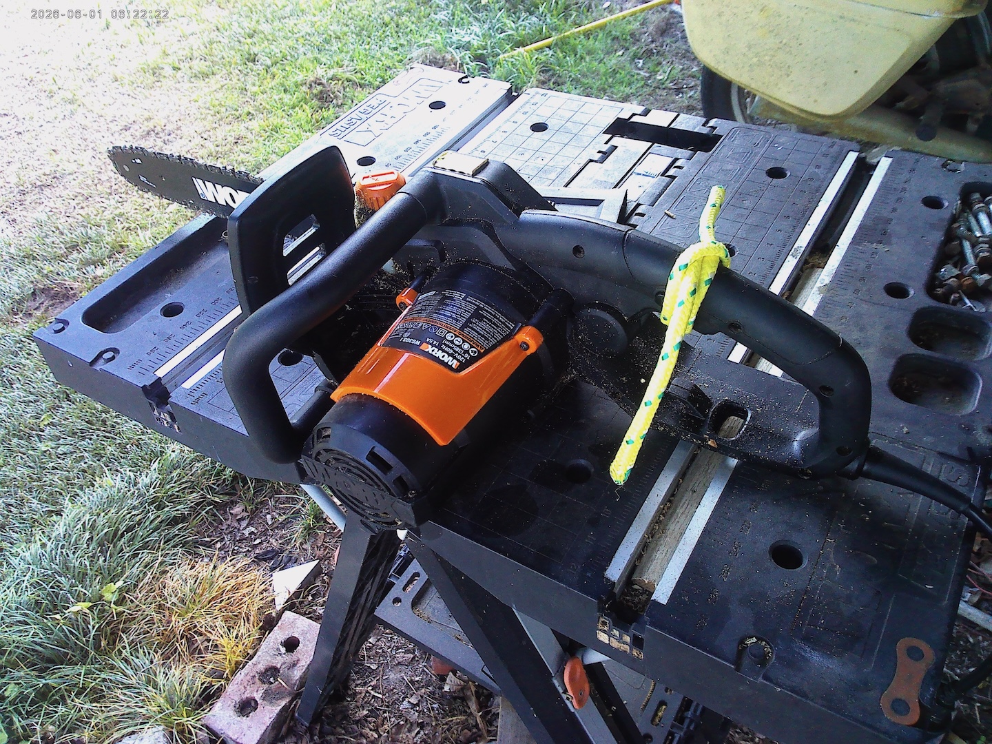

I have seen stumps petrify in various type of soil,usually the rain splash imbeds sand into the wood.

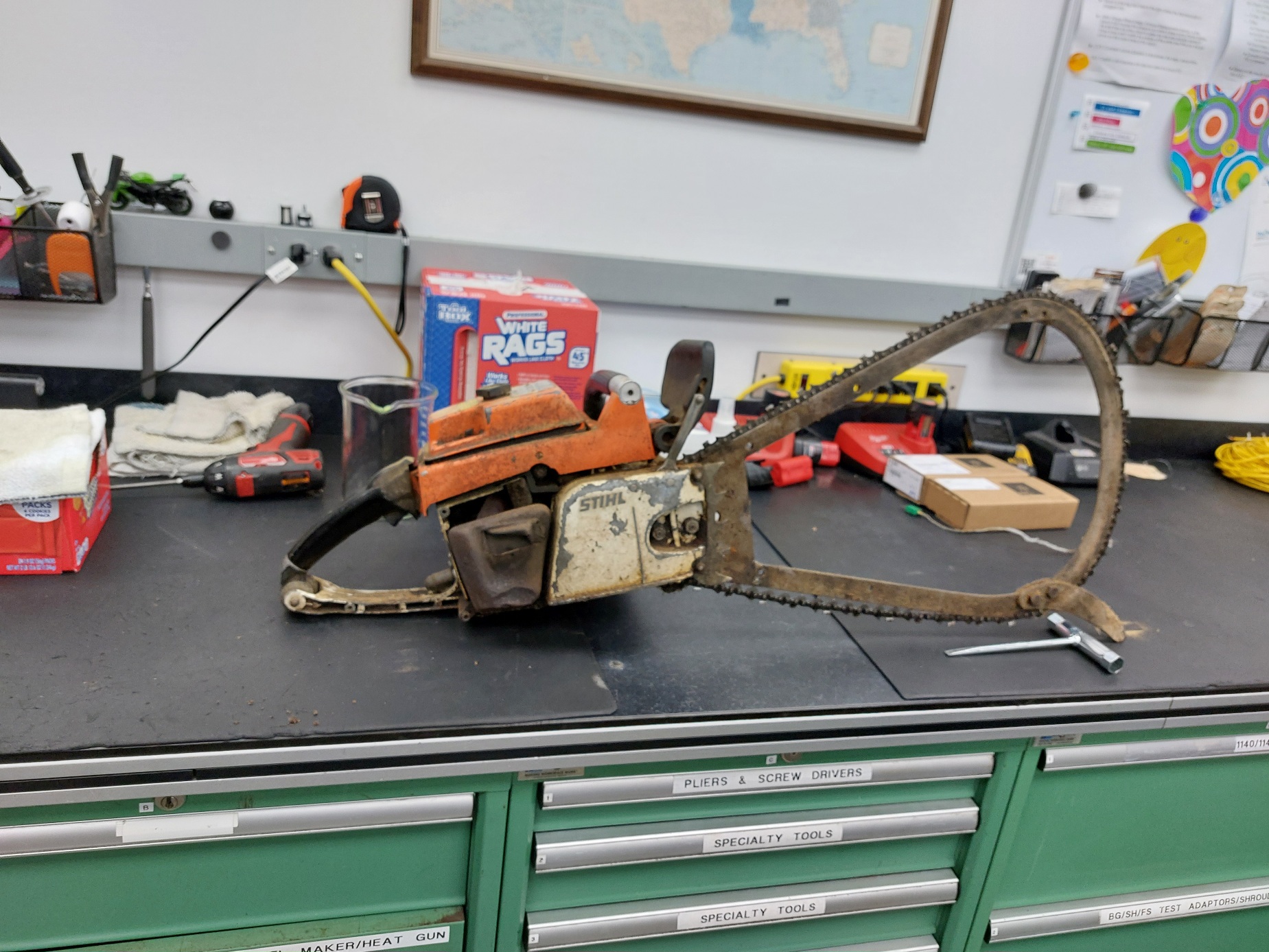

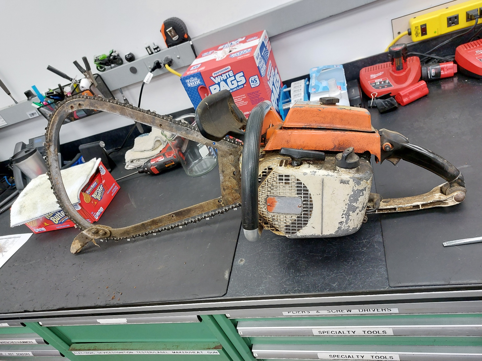

Co-worker got this from a family member. It was his dad's (who passed awhile ago) and the saw "vanished" from the shed. It was found and recovered. It starts and runs but needs a serious tune up. Parts are on the way!

I don't get it??
What the point of the hollow Hoola Hoop bar??
Does it cut circles? Or wiggly lines?

I don't get it??
Used for smaller trees on the ground; easier on cutters back. I think this one is missing a guard.
