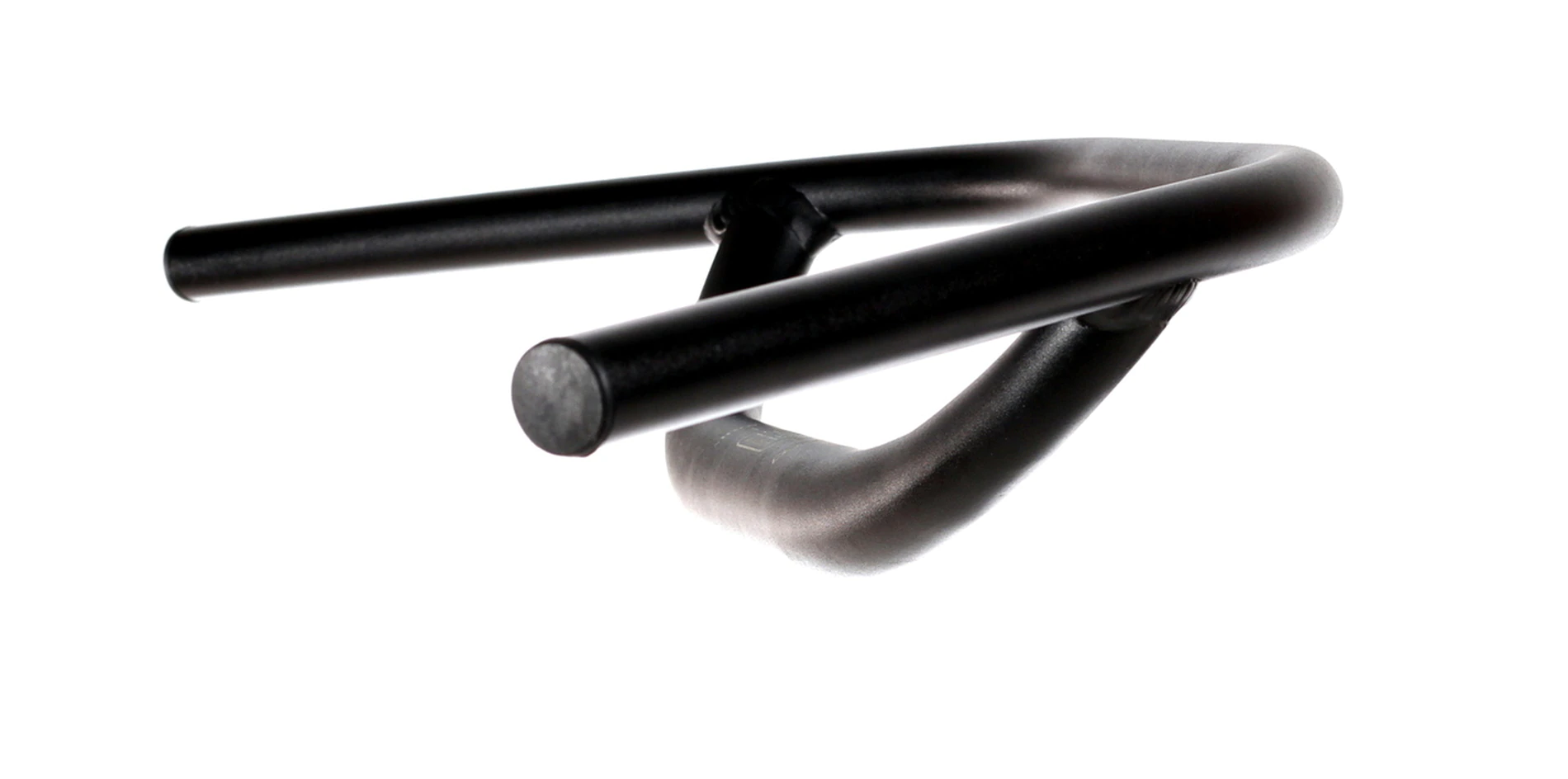

Has anyone found the height or reach of the bars on the CC an issue? Is this just a short person issue? What were your solutions?
One of the Frey CC models has swept back handle bars.
I'm sure you can replicate that?
You could possibly also change the head stems for a shorter one.
Have you tried moving the seat forward on the seat rails?
thanks. It has a short stem. I did not think to check seat position. Too much weight on my forearms and wrists. Those bars you showed would be better. I think they have gone to a mtb type set up for dual use. i have Jones bars on 2 other bikes. Their 2.5 riser bars might be the trick
When I get my CC, will most likely swap for Jones H bars
They actually have two CC models one more mountain bike type, and one a cruiser type with brown seat and brown grips and the swept back handle bars.
You obviously got the mountain bike type.
Good luck with some juggling you will make it fit your body style.
