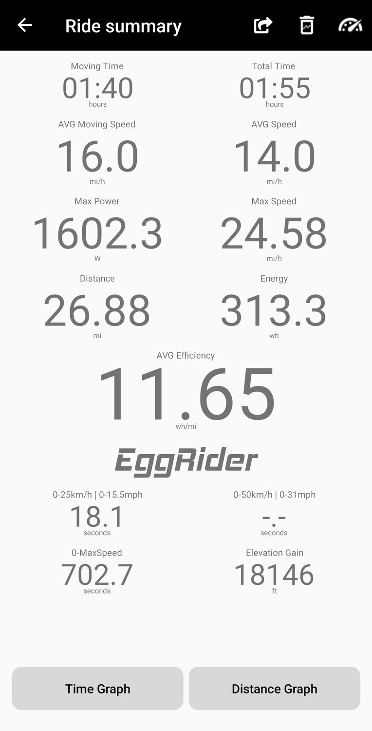

Results after the latest tune. From what I understand about the avg efficiency number, 11.7 is a good number. The ride was straight, really flat, with hardly any others in the way, and barely any intersections that we needed to stop. The battery is currently at 50.1v according to the cheap multimeter.
HOW THE F did I have a 18146 ft elevation gain?

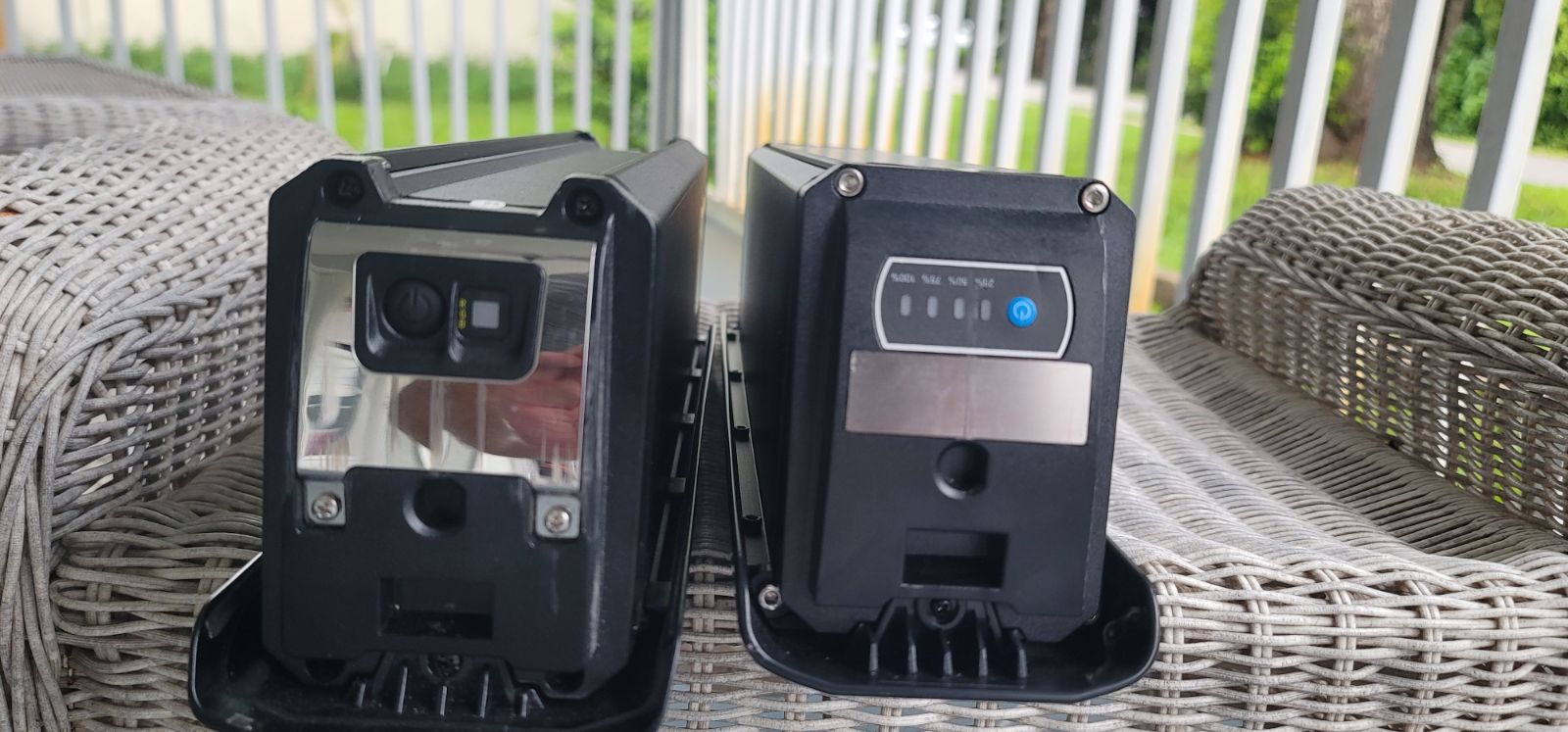

Had an issue with the battery process. The U.S. warehouse sent me the wrong "cover". I was supposed to get a metal rail like device that I need to install that replaces the plastic housing over the internally routed cables. As the picture attached shows, the original battery on the left has a valley that works well with the current setup. The new battery on the right is flat. I can get the battery in and hanging but not get the battery to lock. I have verified that the battery does work.
I ended up actually getting the outer plastic cover for the battery instead. After some sleuthing with Frey, the actual part I need is on the way.
I did do a ride with my 17.5 and 21 Ah batteries this past weekend. Decided to do a full power ride (sport pas 9) with the 17.5 Ah battery until it cut out. I rode in Sport PAS 9 for about 96% of the time. Trail etiquette was required in spots. The 17.5 cut out at 33.9 miles. Average moving speed was 20mph, with a top speed of 34.5mph (road). Taproom math after that ride figures I burned 1.9ah per mile.
So the rest of the dirty top power math (not verified yet) is I should get 40.5 miles on the 21 Ah battery and 57.9 miles on the 30ah battery if I rode the same course the same way. I wasn't doing completely flat riding. So things could change in the next test.
