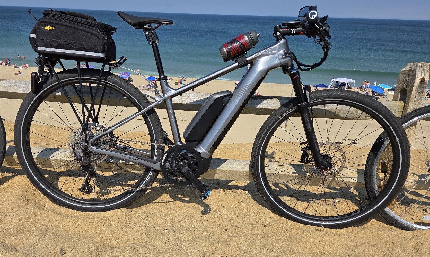

Today I added a used Cane Creek Eesilk + seatpost that needs rebuilding, a loaner saddle for testing, swapped the stem for a 3T 130mm -17 degree stem, and removed the dead horn which is being replaced under warranty. I would love a lighter bike with more modern technology, but this beast is so much fun to ride. It absolutely was built to ride fast.

I think your bike is pretty awesome. What more modern tech are you referring to? Just curious.

I also think my Tesoro is pretty awesome. The Bosch System 2 delivers everything it was designed to do. What's missing are more modern features that Bosch (to a degree) and other drive unit manufacturers provide, things like:
- The ability to tune each assist mode for assist level and dynamics
- An open data architecture that would allow me to get rider/motor data on whatever computer I choose
- An open electronic hardware architecture that would allow me install whatever shift system or lighting I choose
For example, the Deore M6100 is a nice mechanical system, but I miss my Di2. Sure, I can add a battery in the seatpost and install it, but I'd rather run it off of the main battery.
It's all small stuff that doesn't degrade the riding experience. I've always built my race bikes frame-up, so that I could choose the best available at the time, and upgrade as better stuff came available. When you're racing, you want your equipment to be perfect in every way, so that you spend every moment concentrating on racing. It's a mindset that's bred from competition. Masybe it's me that needs to evolve, I don't know. :)
there are options to runs electronics from the bdu, for BES2 you are limited to the frontlight powerport. For your bike this would be setup for 12 volt 3 watt. At least that is what I read in the containerfile for this model. Usually the dealer (you if you haveaccess to the service portal) to set it up a higher wattage. There are a lot of splitter cables for this frontlight system, so you can add the frontlight to the spilltter, splitter in de bdu, and an acc on the other end of the splitter. We have a few bike models riding around with BES2 with double lighting at the headtube and on the fork, there are units which are hardwered to the bdu for track and trace, and I;ve seen some USB female connectors for on the headtube/handlebar to keep the USB acc topped up while using the bike.
also for data logging, there are a few solutions there, which tap into the can-bus comms, but those are mainly targeted at the oems, to let us read out the systems while diagnosing them.
I was thinking does the new DI2 deore setup for e-bikes not be able to hardwire into the light output on BES2? with BES3 it would go on the low power output port.... so could be an option.
At the shop, we have two licensed computers with the Bosch diagnostics, and I've learned how to use them. My lighting port is already set up for high output, as the bike came with a Supernova M99 Pro Mini headlight (1300lm), Supernova horn, and a Supernova tail/brake light. I don't know if that maxes out the port or not, but it's gotta be close. So, as you say, I might be able to add Di2 with a splitter, but I won't be able to get the other things I mentioned as the BES2 is all done from Bosch's perspective.
If I was going to Di2, I'd go with the Deore M6260-12, as I don't want to give up the clutch. It works really well on the M6100. I've hit some hard stuff going pretty fast in the smaller cogs and the chain never budged.
