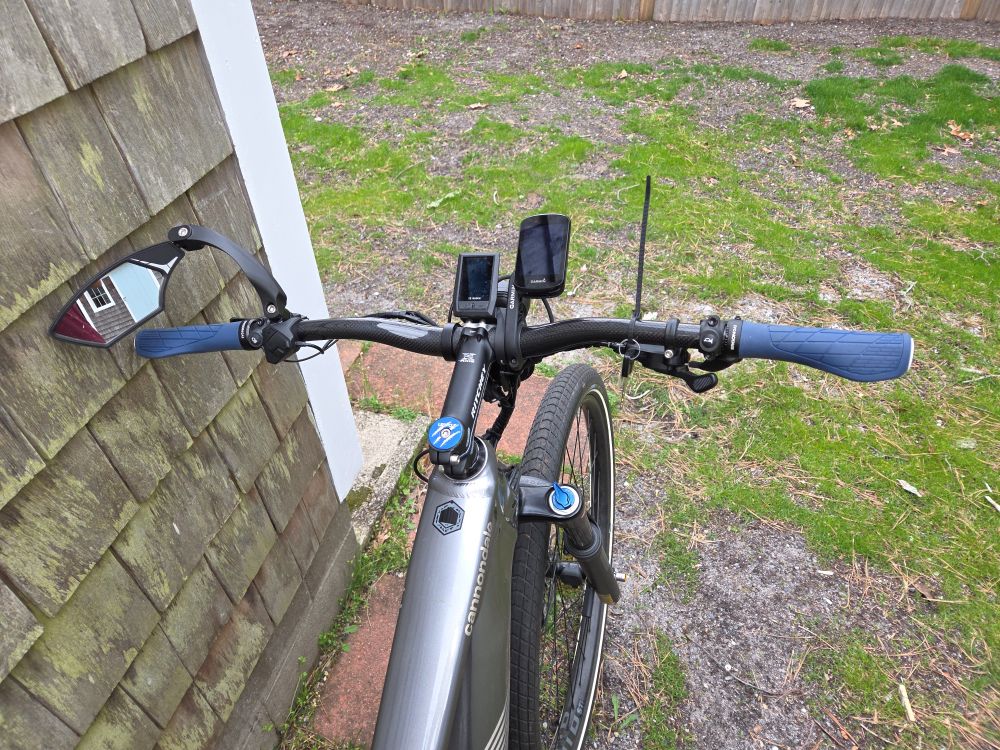

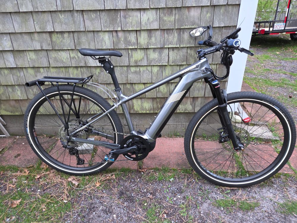

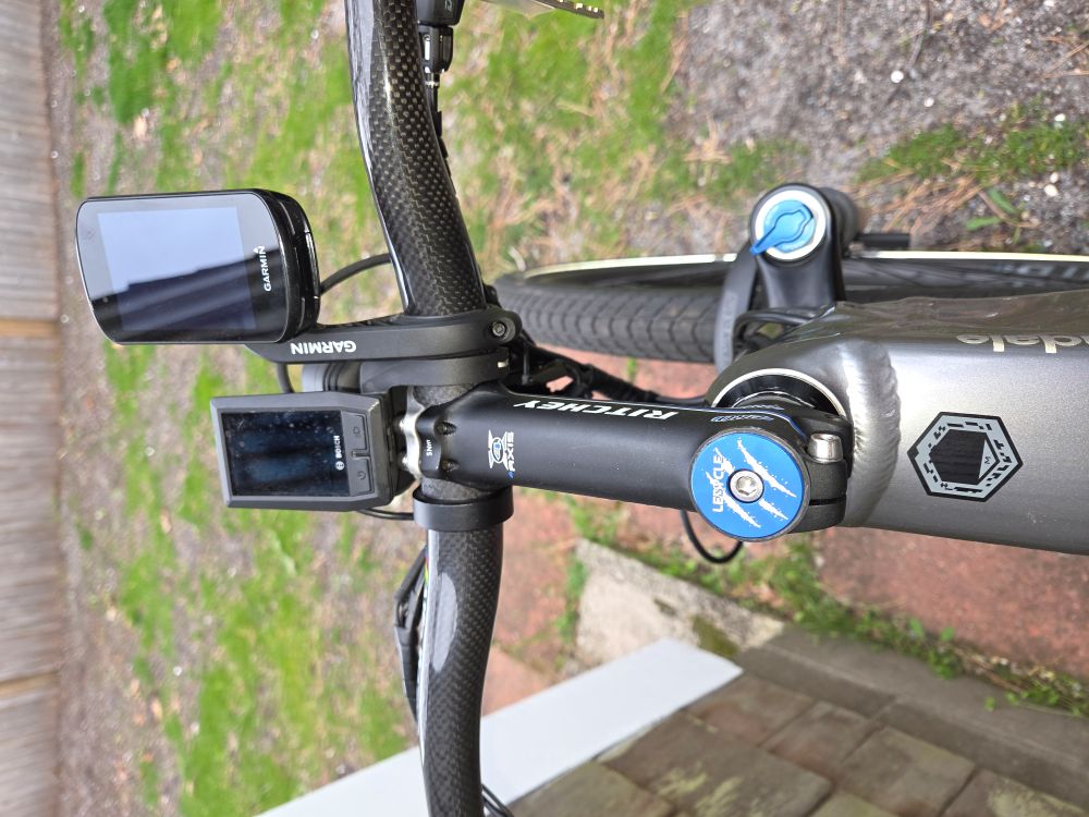

This is my first pass with the new cockpit. Road stem, 70cm carbon riser bars, Ergon small grips, Hafny mirror. It's off to the dealer for the Bosch upgrades.

Well, as you can see, I've already done a lot myself. I had no need for the clunky aluminum fenders and Hangtime rack. I prefer the Topeak MTX 2.0 system that I used to have on my commuter bike. It's a trunk bag that has panniers that fold out. I had to do some wiring to move the Supernova tail/brake light out to the end of the new rack. On the back of the rack, I cut down an old carbon seatpost and screwed it to the reflector boss. I mount my Varia radar and Fly6 video camera on that. It came with flat pedals so I added Crank Brothers Candy 7's which I use with my Specialized Comp MTB shoes. I can't ride too far without cleats. Up front, I swapped that horrific adjustable MTB stem for a Ritchey road stem that I had hanging around, along with a modified expander plug. Then I added carbon bars and Ergon grips to it, as well as a Hafny mirror.
The Bosch stuff I cannot do. I can't even get all of the parts, so I am having the Bosch guy at the local Cannondale dealer do it. He's going to mount the second 500W battery and enable it so that it shows up on the Kiox. Update all firmware. Set the headlight mode to off after 3 seconds so that I can control it manually. Finally, if possible, he's going to swap the Sport mode for the eMTB mode, which varies the assist from Eco to Turbo depending on pedal pressure and cadence, all in one mode. This is a System 2 bike, not a Smart System, so changes have to be done through the diagnostic.

My only comment to you is be careful with the fenders off. I don’t know squat about how Cannondale does this, but on my bike taking off the fenders exacerbated a weakness in the design which allowed contaminants to get in my battery (and cause a fire, ruining the battery in the process). You don’t want any wet crap getting into your electrical system. I.e., make sure all that stuff near the bottom bracket is well sealed and not vulnerable.
That's a really good point. There are a couple of threaded holes in the "bottom bracket" that held the rear fender on. I'll put the bolts back in with Loctite blue. For the front, I'll make sure to remove the PowerTube periodically and clean any gunk out of there. The connections are at the top near the head tube, but point taken. Thank you.
