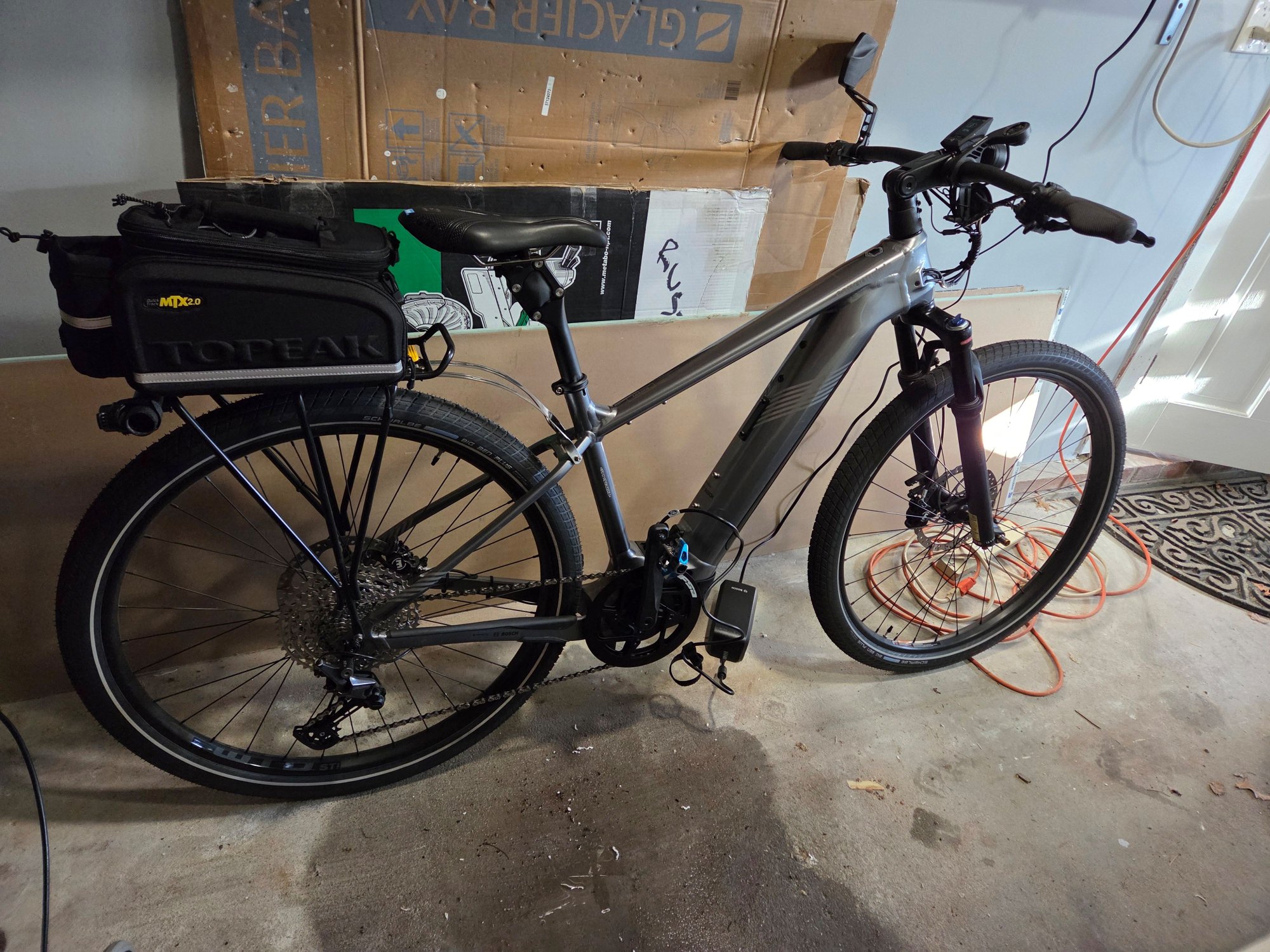

I bought my first e-bike about a month ago. It's a Cannondale Tesoro Neo X Speed in Medium. I bought it on closeout from Mike's Bikes in Colorado. It's the first bike I've bought whole in decades, as I usually build my own. Right away, I knew that there were going to be modifications required.
The first thing that I did was remove the aluminum fenders and Racktime rack, and install my preferred Topeak MTX 2.0 rack and trunk bag. These have panniers that unzip and fold out when needed. The top also expands. I also added my Garmin mount and fitted Crank Brothers Candy 7 pedals. For my Varia radar and Fly6 camera, I cut down an old carbon seatpost and attached it to the back of the rack. I also moved the SuperNova taillight to the rack reflector mount. It fit perfectly.

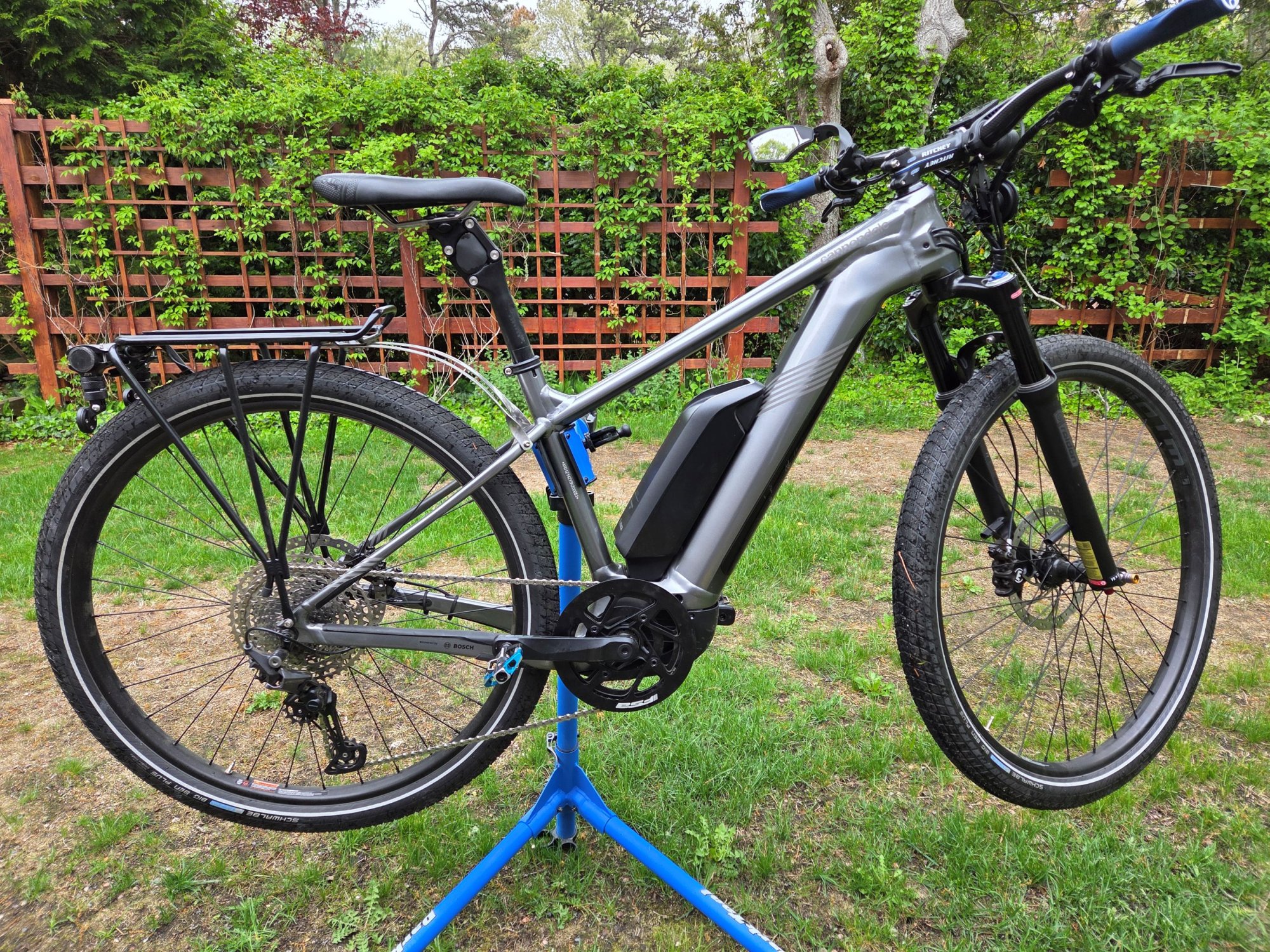

The dual battery upgrade was completed yesterday. I took it home and took a quick 30 miler on it. The bike feels a bit heavier with the added battery, but I didn't notice it much when riding in Mode 2 (Tour) for the 30 miles. I also did not notice any difference in handling. It's the same big, heavy, ridiculously fast bike.
When I picked it up, the shop owner had taken it for a ride, and said "This bike is a beast!". I've always named my race bikes, because whenever one let me down in a race, I refused to beat on it because it would be personal at that point. Weird, I know, but bike racers are weird. So even though I'm not racing anymore, I'm going to call this one The Beast.
The motor is a power hungry Bosch System 2 Performance Line Speed. Class 3, 45km/h, speed pedelec motor. It came with a PowerTube 625. I've added a PowerPack 500 frame battery, the largest supported by the System 2 dual battery system. So now I have 1125w/h of power onboard.
Since the bike is only 2 months old and under warranty, I decided to let my local Cannondale dealer do the complete upgrade. I could have sourced the parts and figured it out myself, but it still had to go to the Bosch dealer for firmware upgrades and programming. I did source a brand new PowerPack 500 battery on eBay for under $400. These are in the $750 range retail, so that saved me some coin. All in all, they shop did me a solid because they had never done one before, so it ended costing me around $1100 for everything. This included setting the headlight to "save last state" so that I can shut it off. Unfortunately, that shuts off the tail/brake light as well, but at least I now have the option.

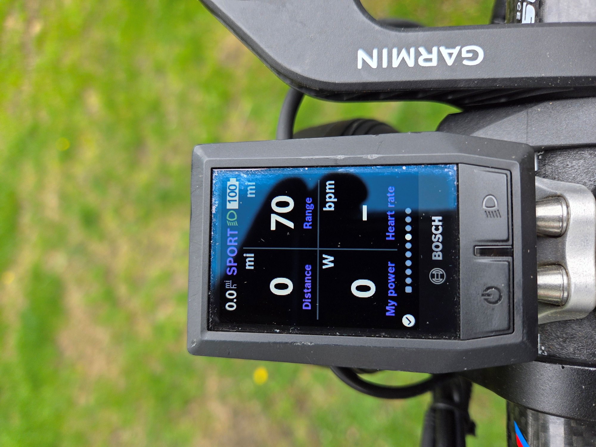

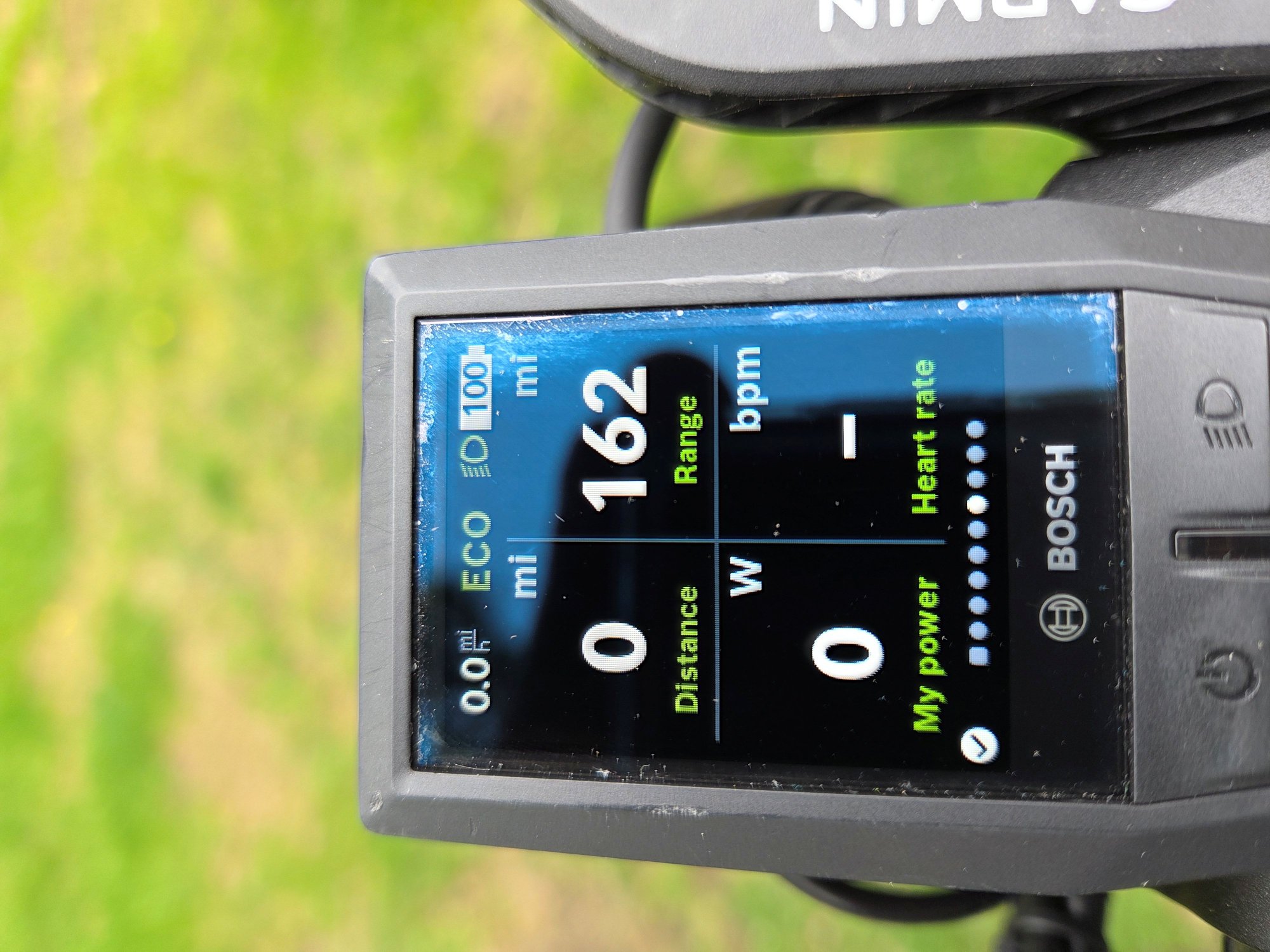

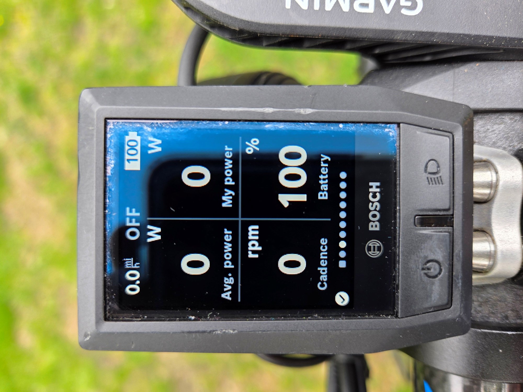

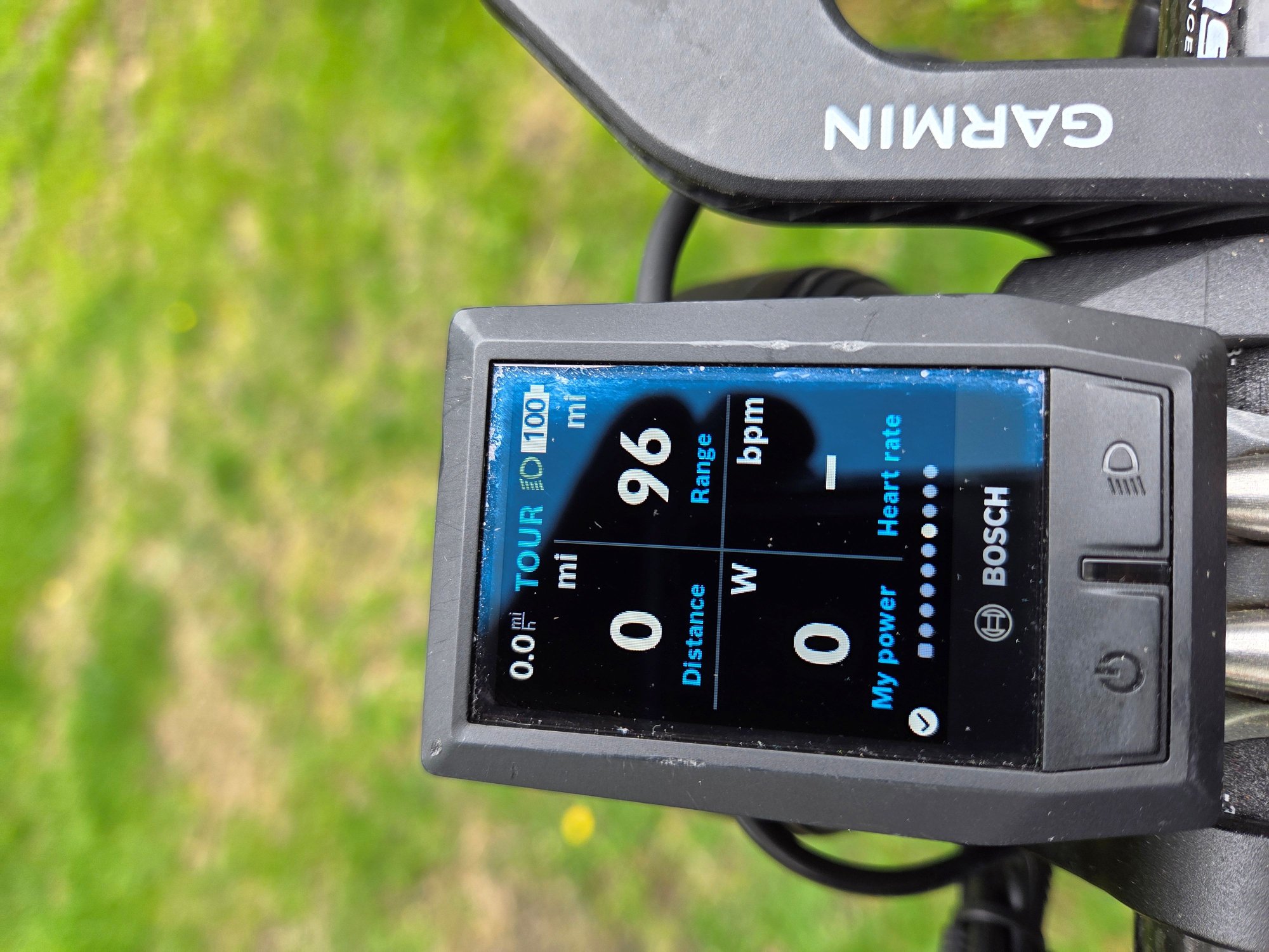

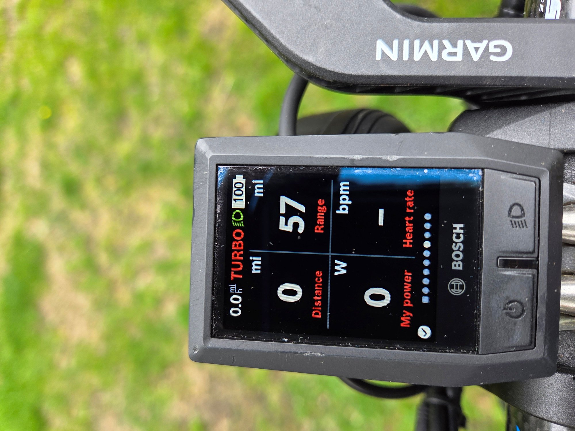

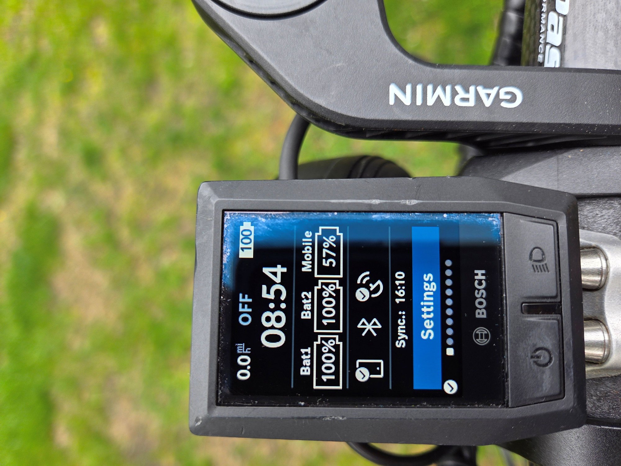

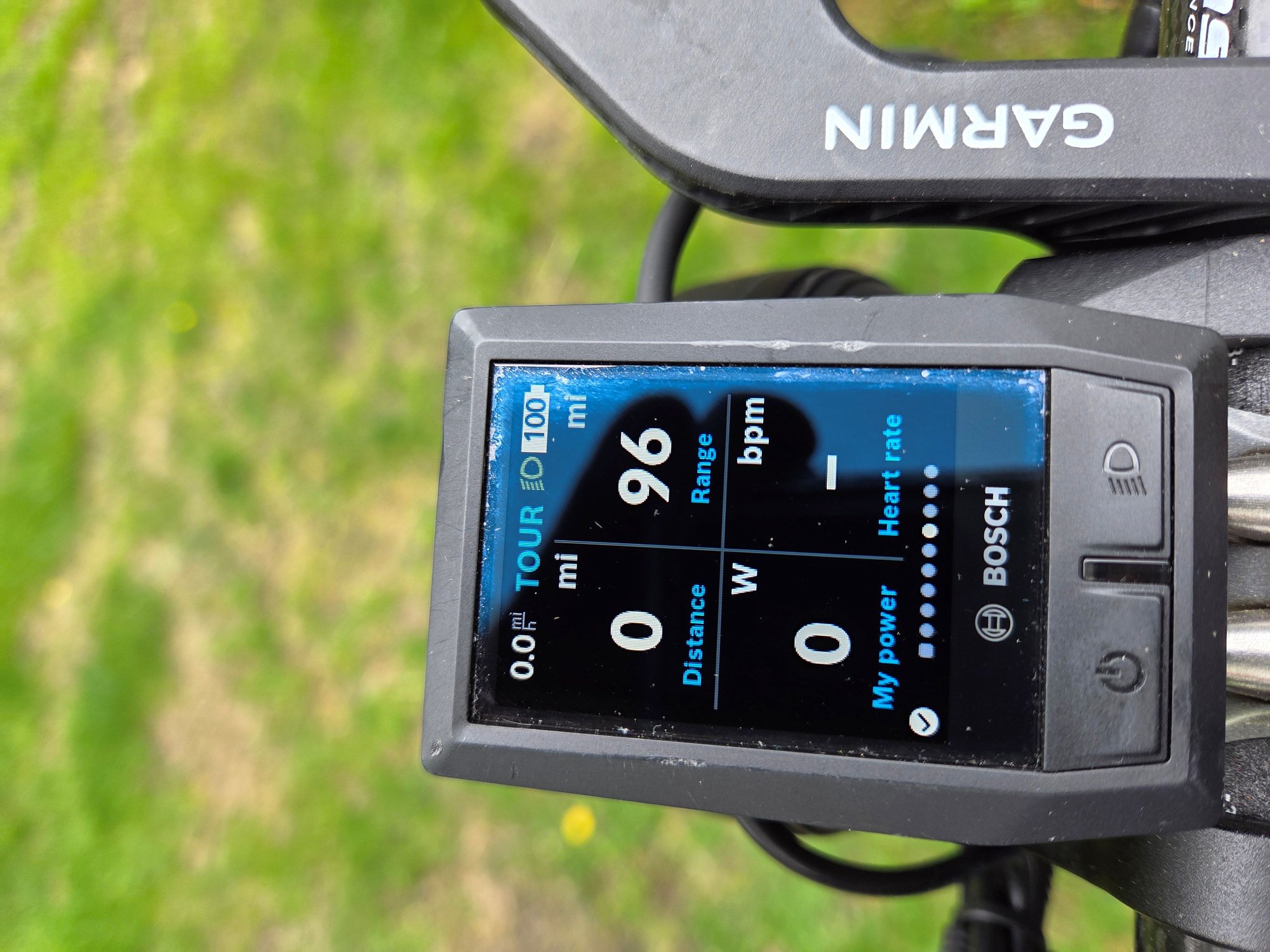

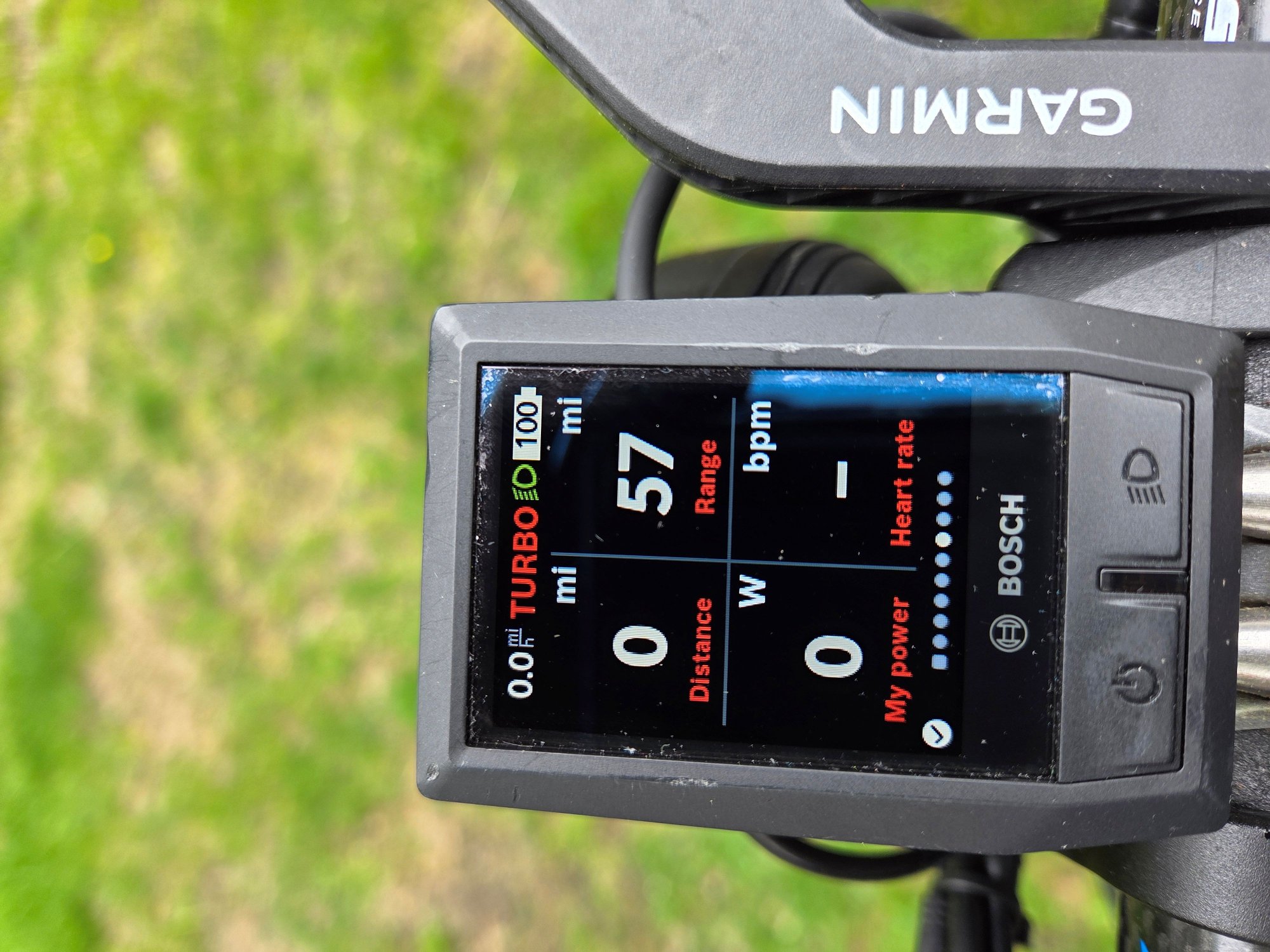

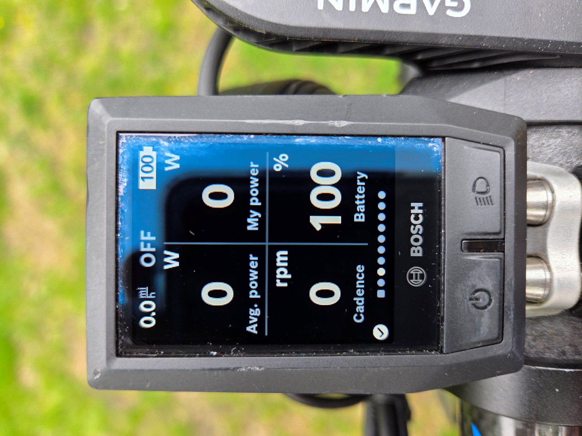

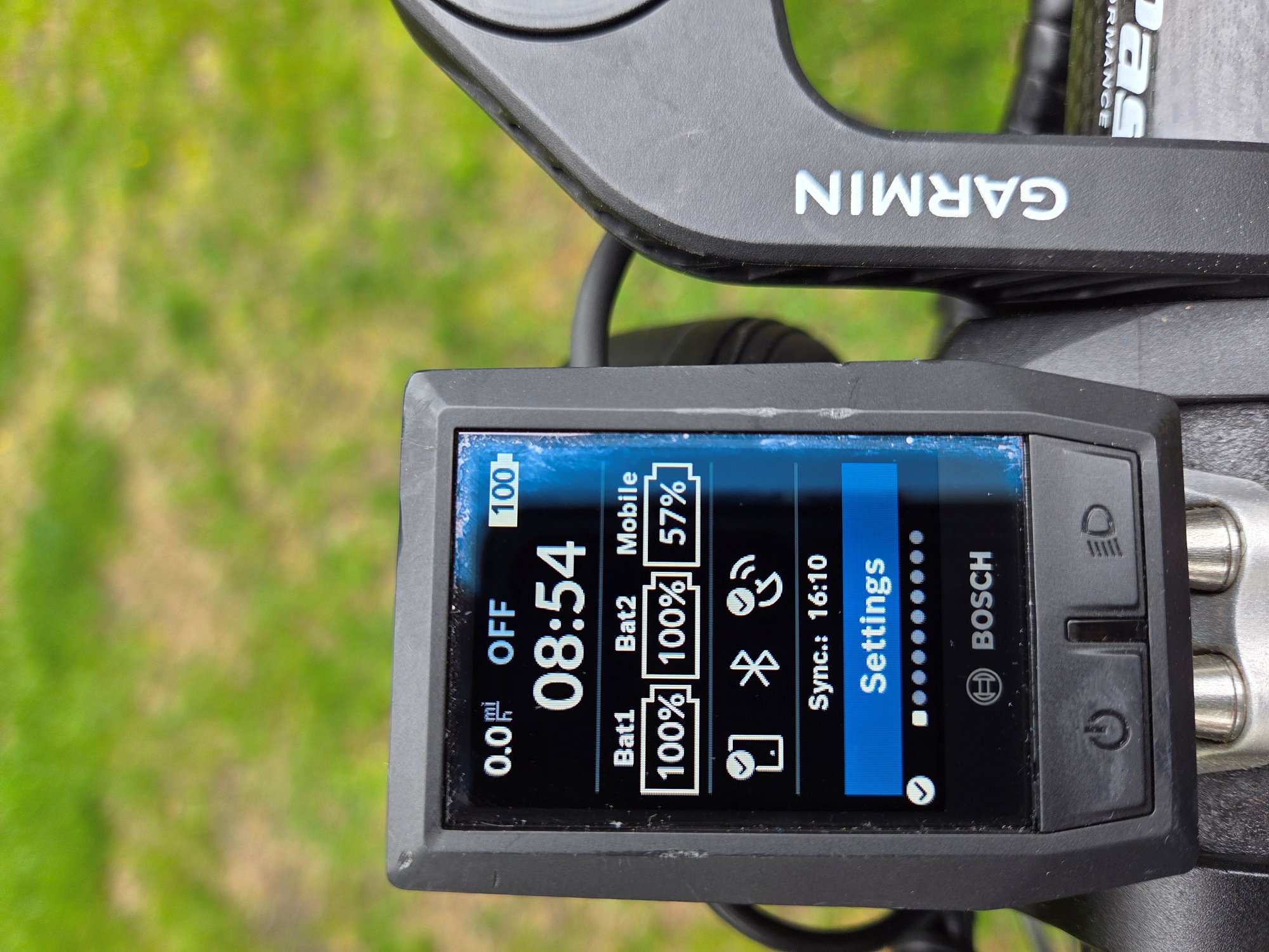

The Kiox when powered on shows the total battery state of charge. The system switches between batteries during discharge to even things out.
Switching to the Settings screen, it shows the state of charge of each battery.

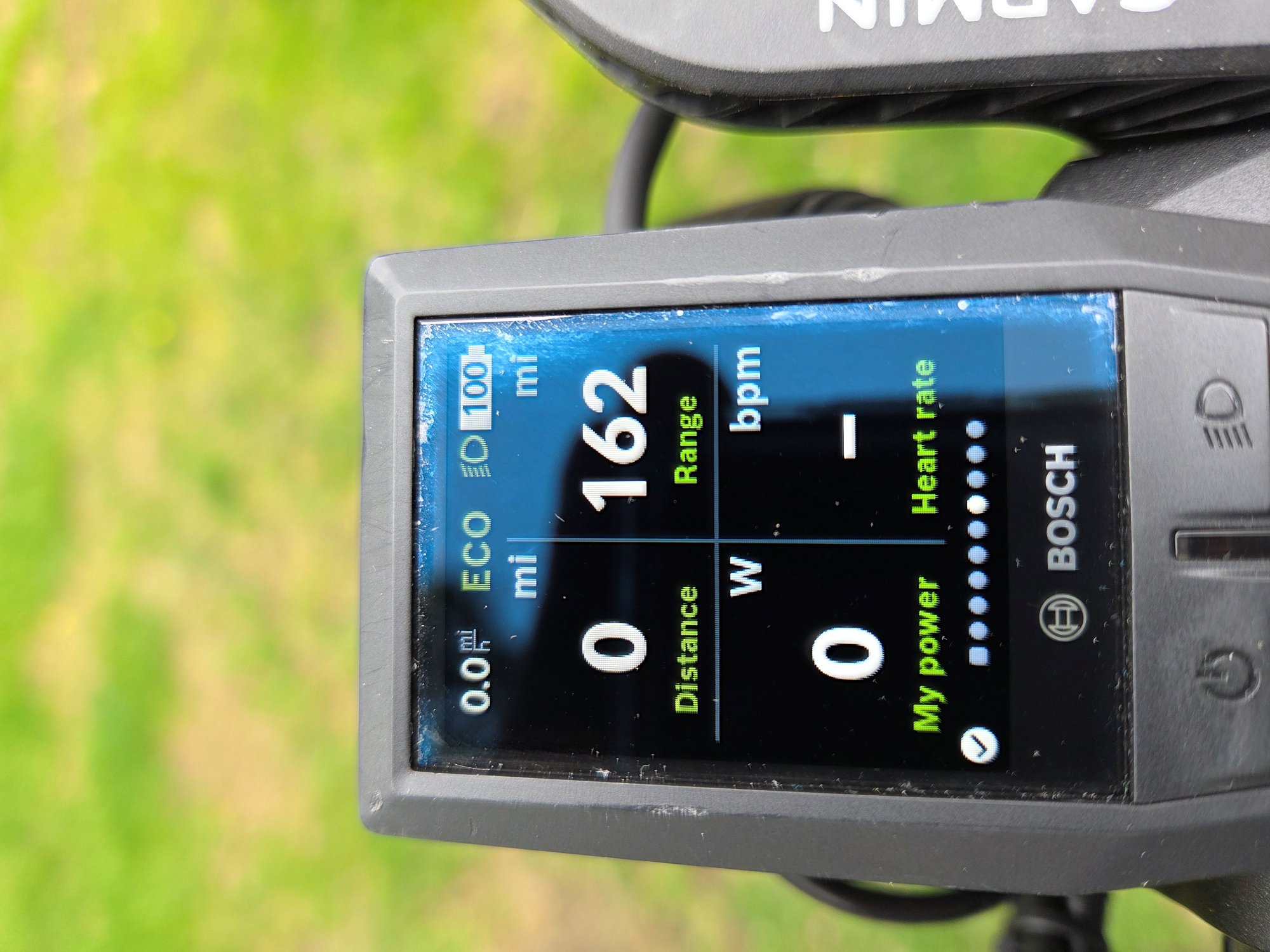

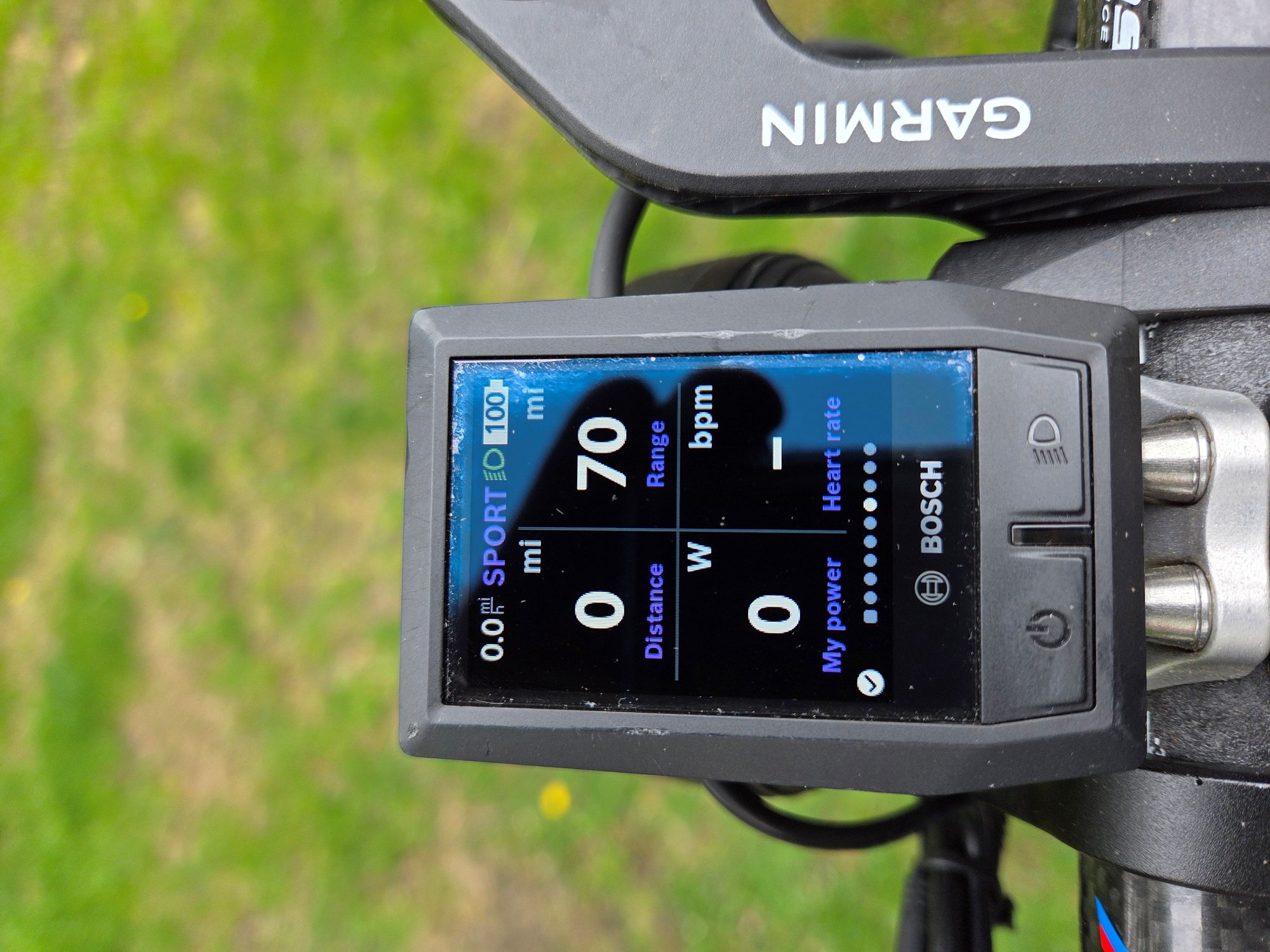

These are now the ranges for each Mode.
The goal was to be able to ride 75 miles round trip without battery anxiety, using Modes 1 and 2.

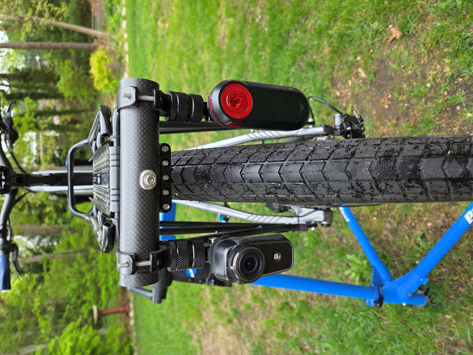

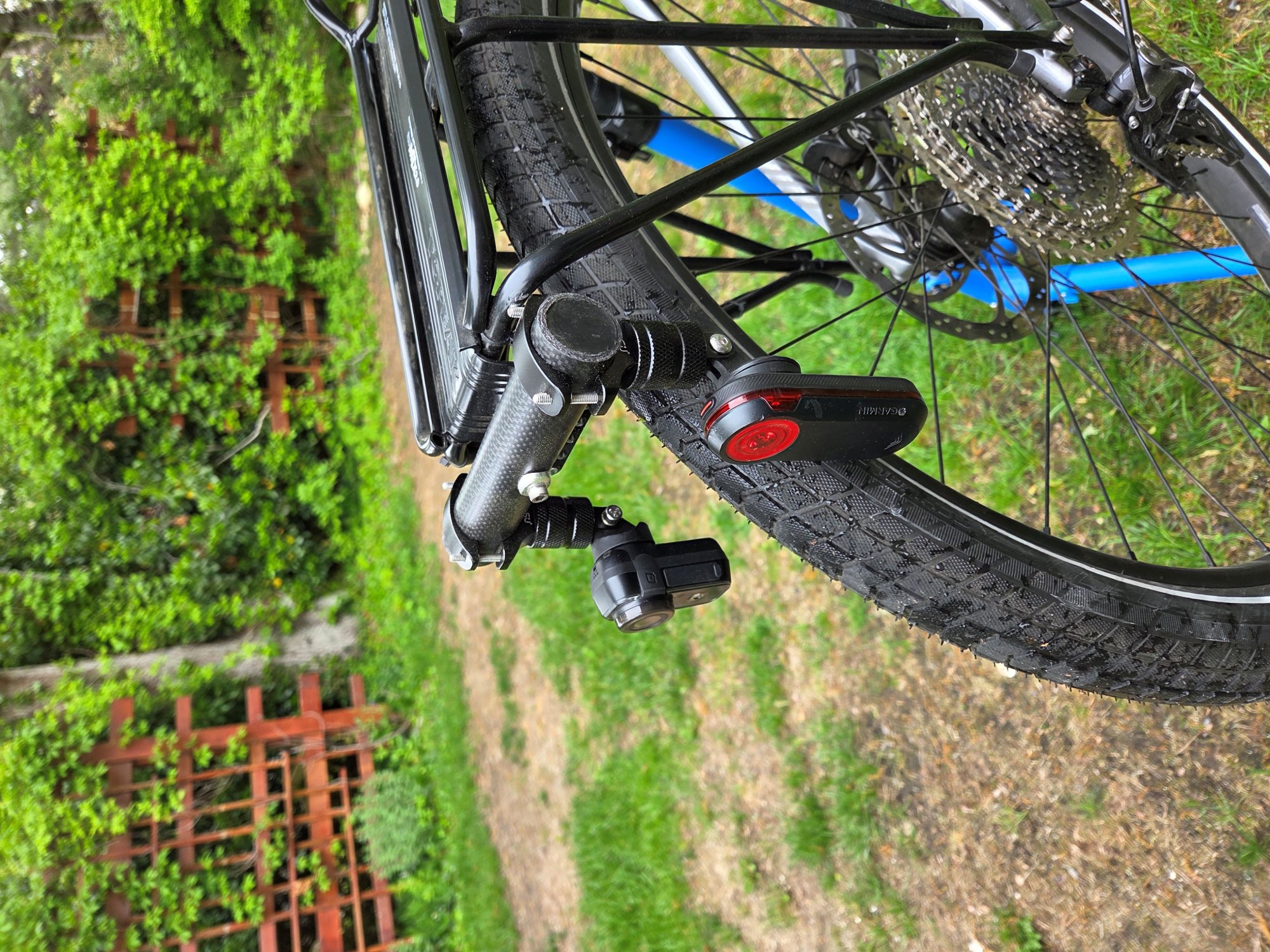

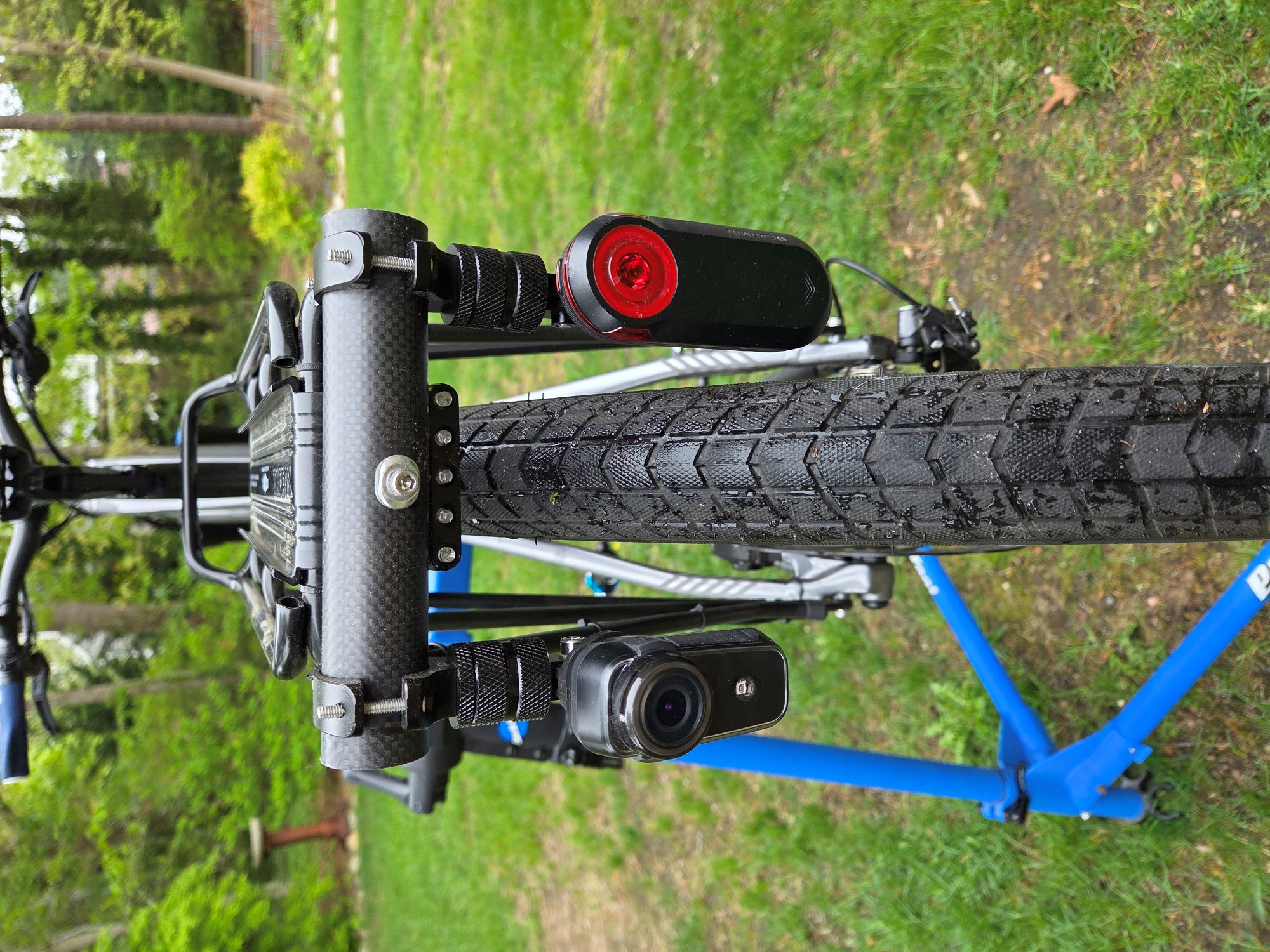

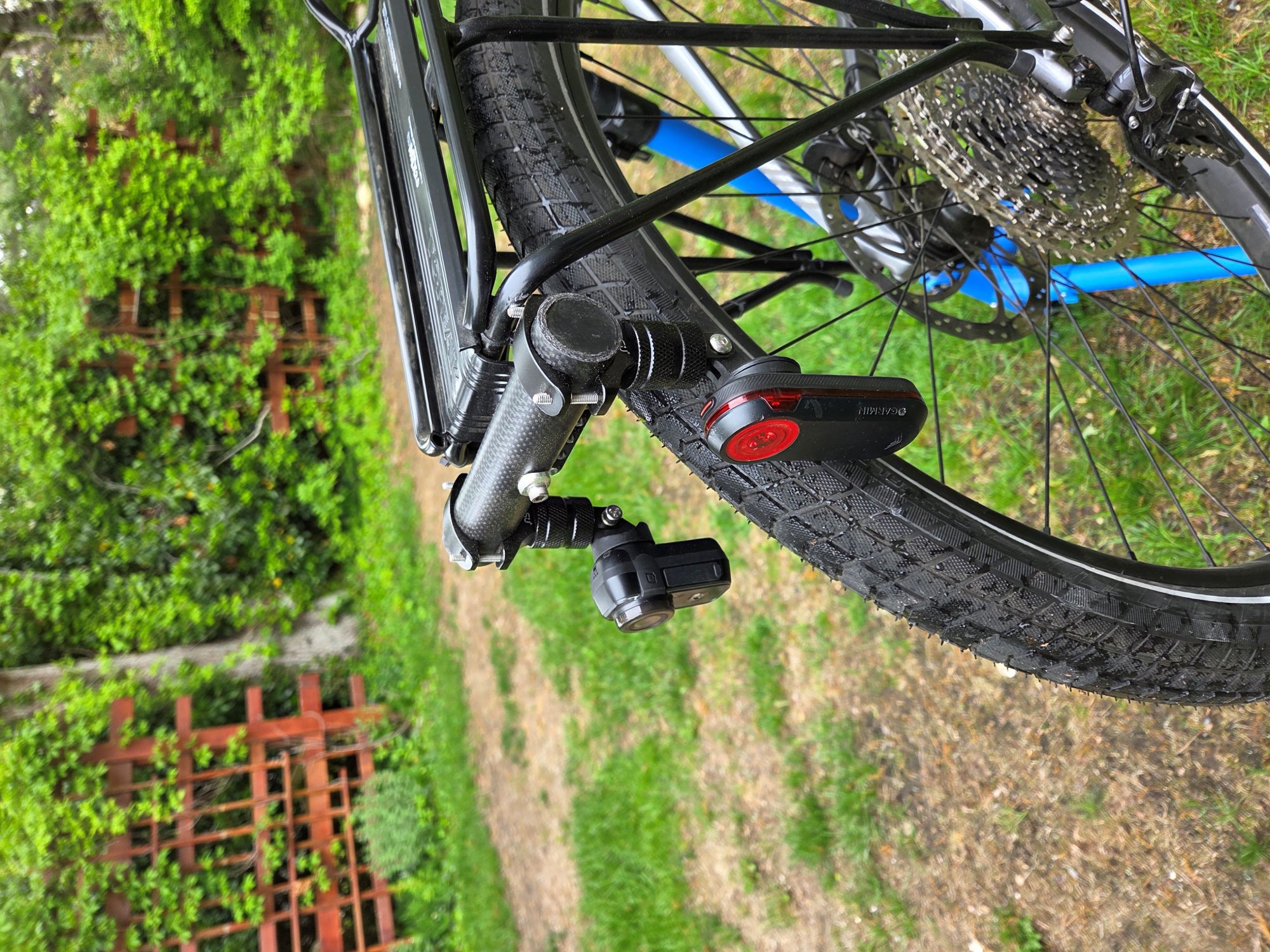

Here is some detail of the tail section I built previously, which holds two things I never ride without, my Garmin Varia radar, and Cycliq Fly6 CE rear video camera.

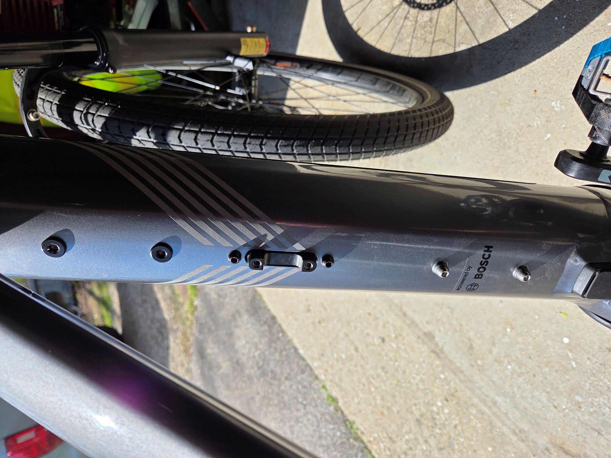

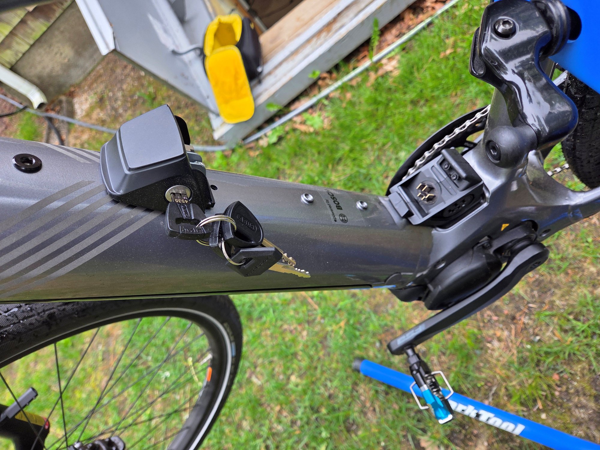

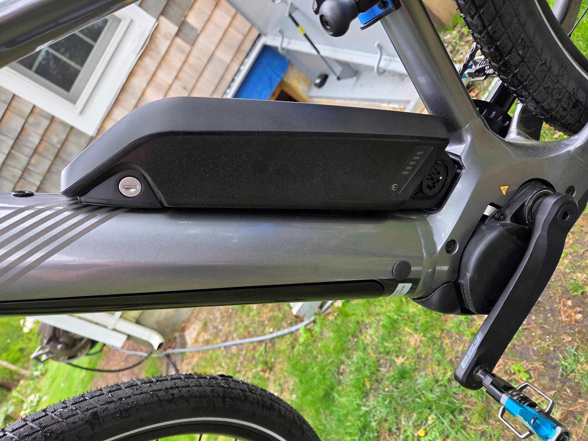

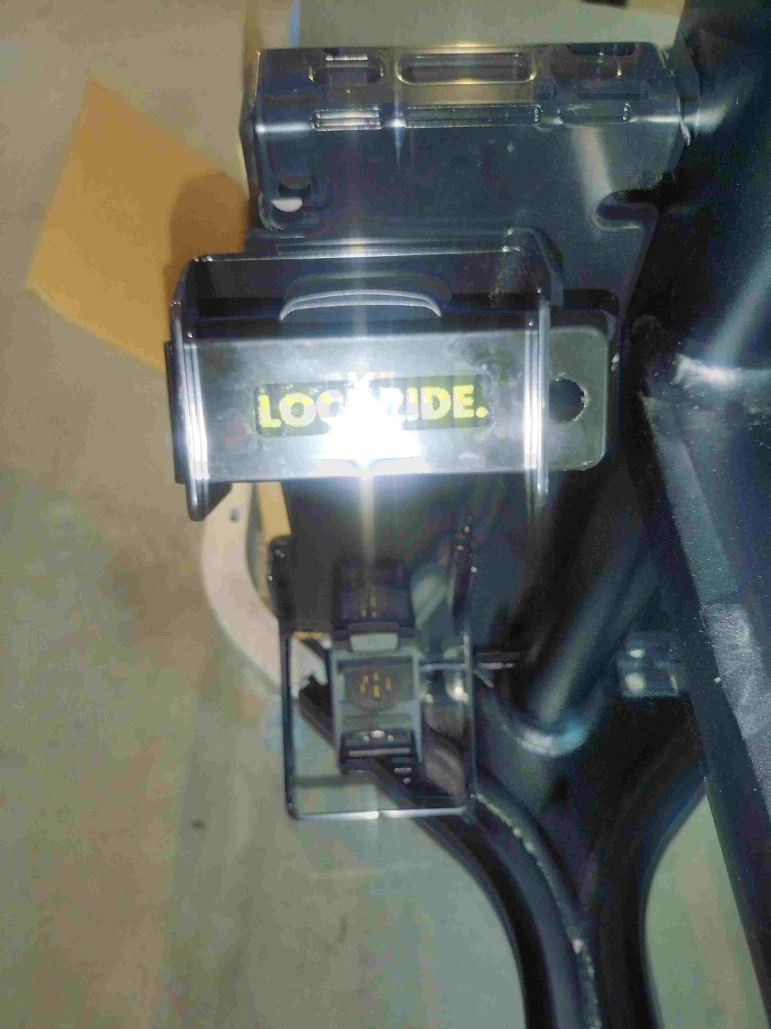

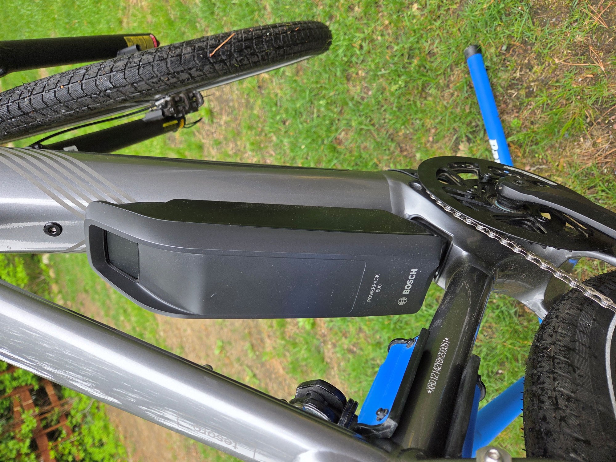

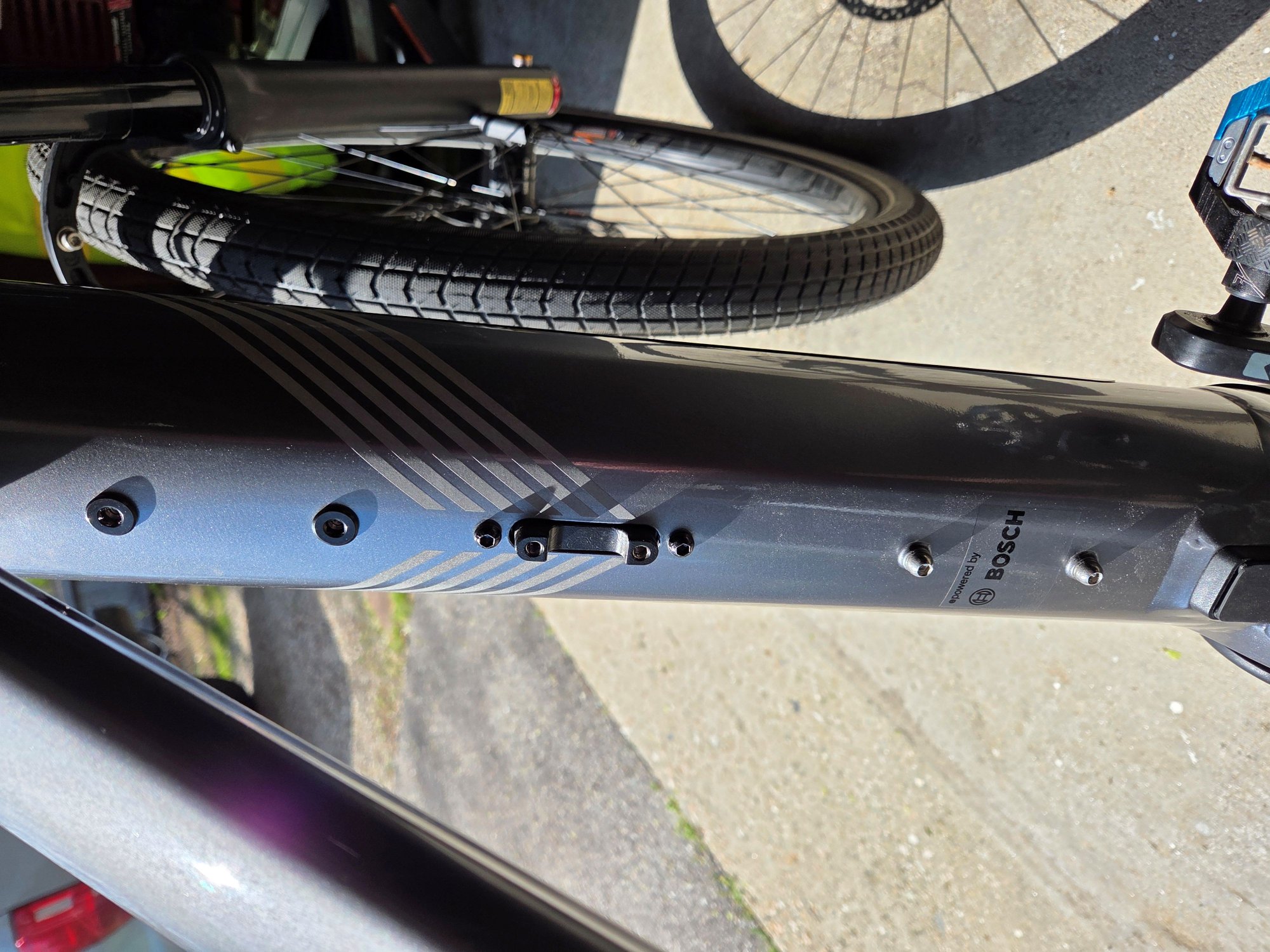

The OEM PowerTube 625 lives behind the black panel on the outside of the downtube. The second battery is mounted on the top of the downtube.
This is the top of the downtube before installation. The top two round bosses hold the fastening clips for the PowerTube on the other side. The rectangular plate below comes installed the other way around, as a flat plate. To install the dual battery, this plate is flipped around into the position shown, with the threaded holes facing up. The lock cylinder will attach to this plate. The bottom two water bottle bolts are also removed for battery clearance.
There are certain combinations of batteries that will work with a dual battery setup. Which setups will work with your bike depends on the system type (System 2 or Smart System), and the original battery setup on your bike. My Tesoro allows a Power Pack 400 or 500 Frame battery as the second battery option.
The mounting system is the same that is used for any bike with the Power Pack Frame battery. The only Cannondale specific part is that rectangular plate, which comes with the bike. The new charge port is at the bottom of the frame battery mount. When plugged in, the system alternates charging each battery until they are both charged.

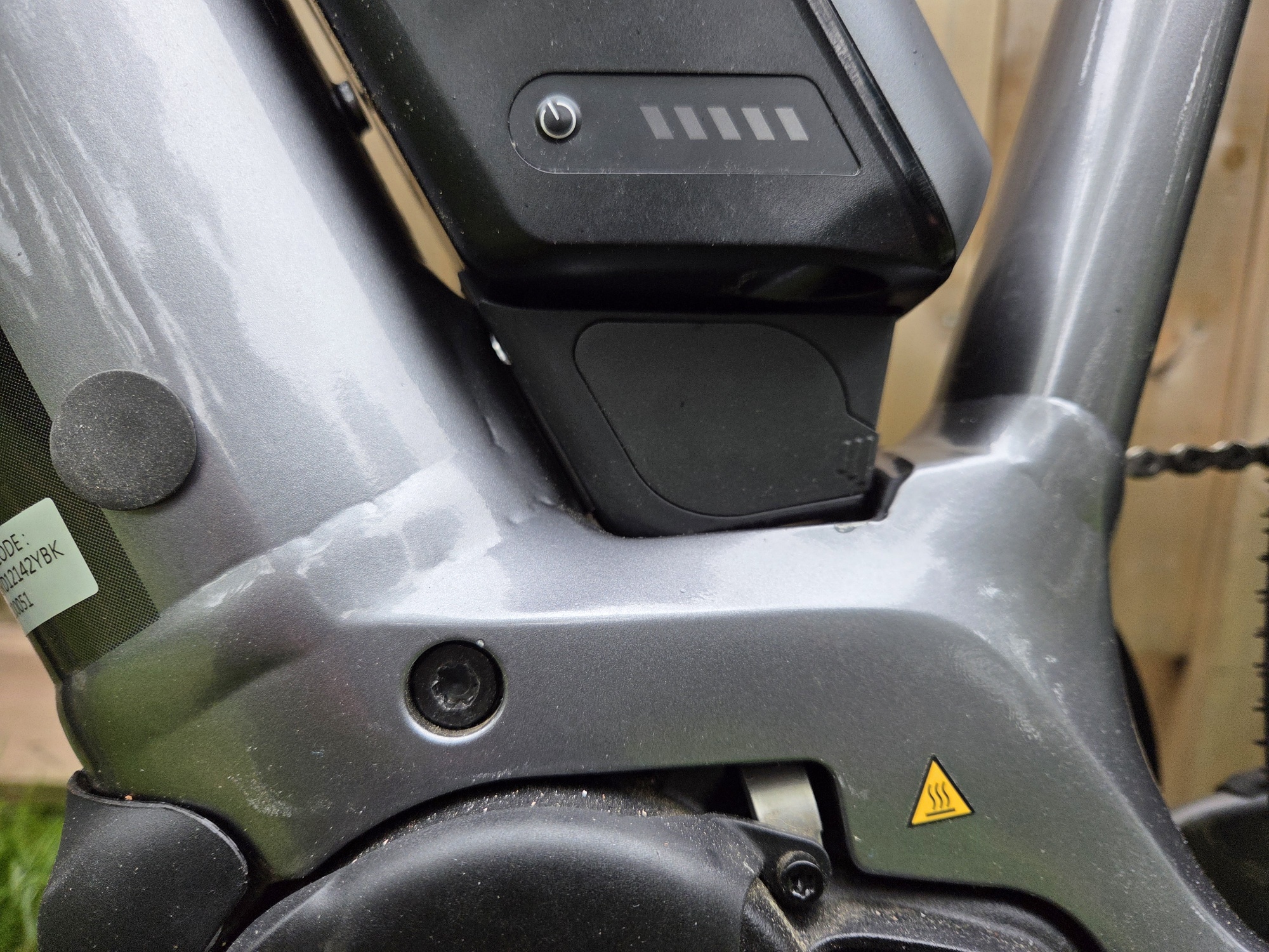

Here is the dual battery system with the second battery removed. The lock assembly mounts to the rectangular plate. At the bottom, the OEM charge cable and cover are replaced with a Power Pack battery mount, cover, and a Power Pack Frame battery cable. Underneath the motor, stuffed up into the seat tube, is the dual battery Y-cable, which connects the PowerTube battery cable and the Power Pack battery cables together on one end, and into the motor on the other. The final piece is all software. Both batteries and the motor need to have their firmware updated to the latest, same version. Then a request has to go to Cannondale for the dual battery upgrade. If approved, Cannondale gives the tech a code which is in turn given to Bosch support as part of a service ticket. The Bosch tech then remotely logs into the bike and turns on that dual battery capability. This way, both Cannondale and Bosch have my bike's serial number registered with them as having a dual battery that is warranty supported. If it blows up, they own it.

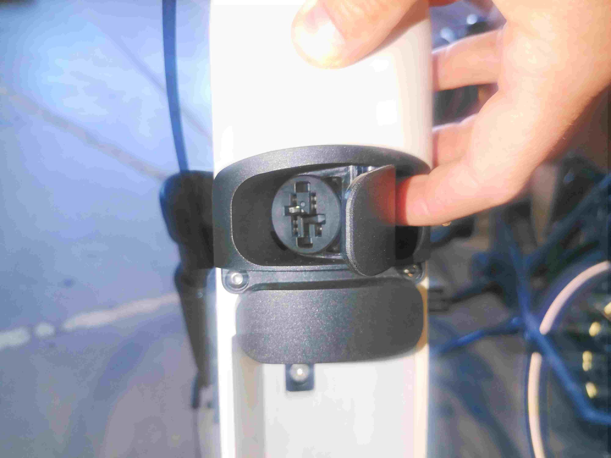

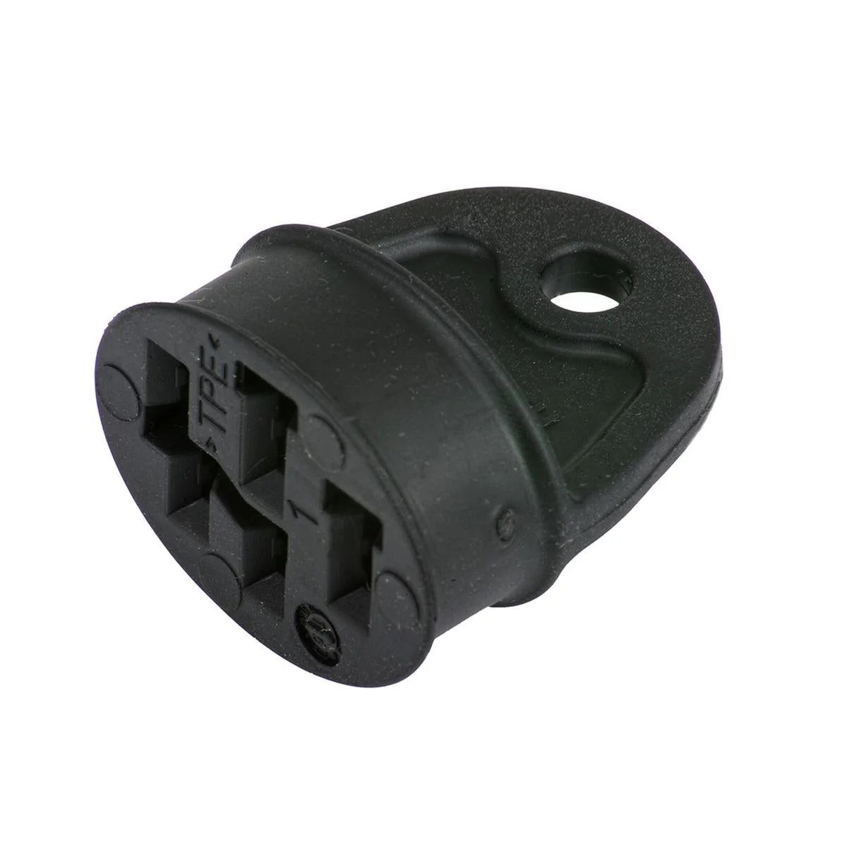

Two things the shop missed. First, the bike came with a rubber cover for the frame battery charge port, which they misplaced. I ordered a replacement. They're $7 so no big deal. The second thing is that they could have matched the Abus key codes so that I could use one key with both locks instead of two. Again, no big deal.
The radar is a Garmin Varia. It's a rear blinky light that has a radar system built into it. It senses when there is a motor vehicle behind me. The range is about 200 meters. It emits a beep and draws an approaching dot on my Garmin 830 screen.

Oh, and my (last piece of) advice… Cover the charging port with electrical tape for the time being while you ride until you get the rubber cover. Where that is located, it is badly exposed (as I’m sure you already can see). Also, look over every inch of that battery to make sure there’s no components/connectors/edges exposed to the elements. Also, I hope that 5-prong battery connector at the bottom bracket seals with an o-ring or something when the battery is attached. If not, there might be some electrically neutral flat ring you can use to make sure it seals when the battery is placed in.
Fondest wishes. — C

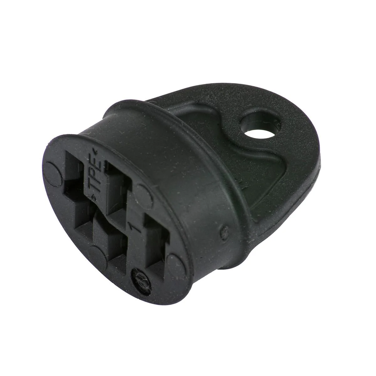

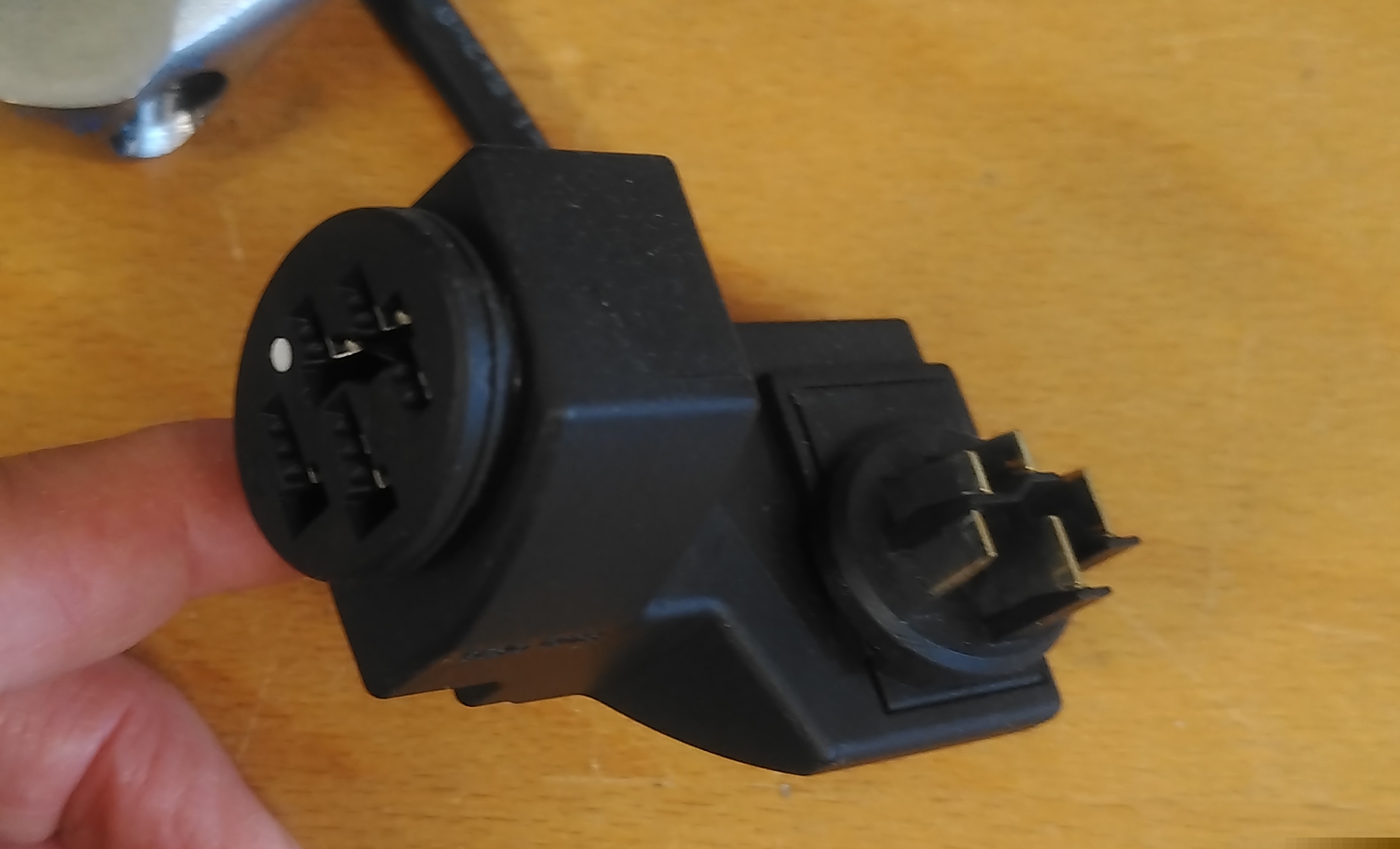

looks great indeed. If you are worried on the contacts... loads of bikes here lost the rubber connector protector and still have to see a fault resulting from it.
You could also use one the 4047025643092 to cover the battery connector pins.
And just do not forget to take of the external battery when parking the bike. it tales 3 seconds and a small flat screwdriver to get a Powerpack from that system. (and yes, used that method a few times when the consumer did not send the battery keys in with the bike for the expertise center)
I got a couple of those for use when I'm walking with the battery or I'm not using it.
I added the charge port cover. I had to remove the bottom cover in order to attach it. It has to be pulled into the cover from the inside. I have a spare one in the bin.

Just for S&G's, I weighed it.
52 pounds rack/Varia/Fly6 and main battery
54 pounds with trunk bag and tools added
62 pounds with second battery added

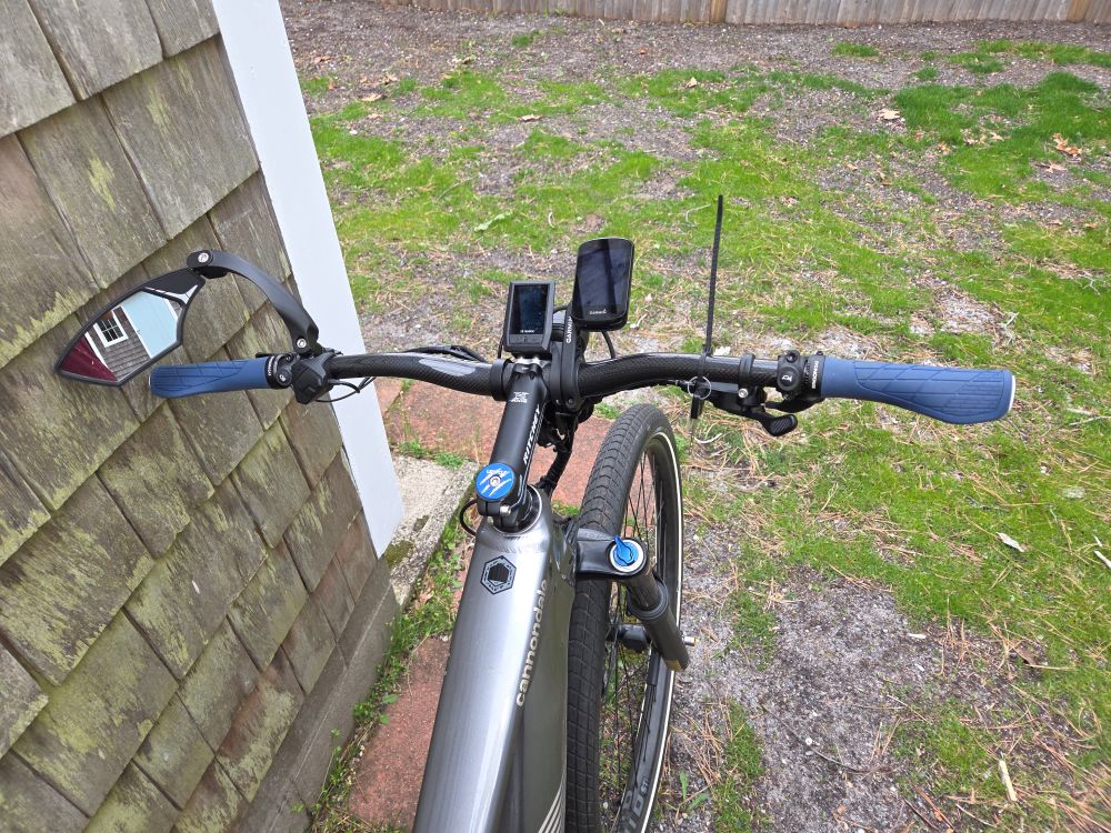

First, I upgraded my Garmin Edge 830 to an 840 (battery only). I put my 830 up for sale, figuring that it would take a while to sell, but it went so fast that I had to order the 840 from Amazon (next day) so that I could keep riding with the data I enjoy. I mounted it on the stem for now. I'll see how that works. I have two OutFront mounts in case I don't like it. In the picture, the Kiox cannot lay down any further with the stock mount because the headlight (Supernova M99 Mini) won't let it.
With the dual battery, both water bottle cage mounts are blocked with the second battery installed. I don't need the battery all the time, but I don't want to swap a bottle cage off and on with the battery for short rides. I found this interesting mount made by Twofish that has a rubber back. It's designed for round top tubes, but it flattened out nicely, and seems to stay in place. I installed one of my old Arundel carbon Sideloader cages on it. I'll check it out on my ride tomorrow.

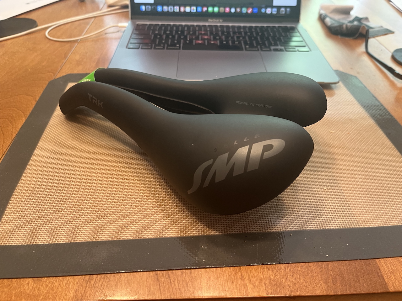

Finally, I've been working on my fit. I swapped the saddle for an ISM 3.0, which is more of a comfort seat. That helped, but it's still not there. I'm OK for a couple of hours, but my butt starts to hurt in hour three. Some of that is lack of fitness, but I do feel cramped up front. Definitely not neutral. I think the end game will be to swap the riser bars for flat bars, but in the meantime, I rolled the riser bars forward about 1.5cm, and repositioned all the stuff on it.

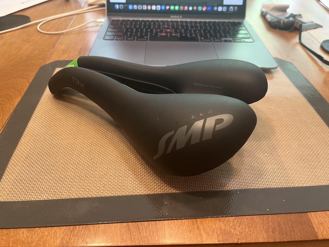

Chris, I haven’t ridden with it yet, but I just bought a Selle SMP TRK saddle. RabH rides huge hours on one of these and I’m hoping this increases my comfort level based on his (and others’) testimony. Anyway, just a suggestion. SMP makes a bunch of different versions of this saddle in case you’re looking for something sleeker or lighter...:
