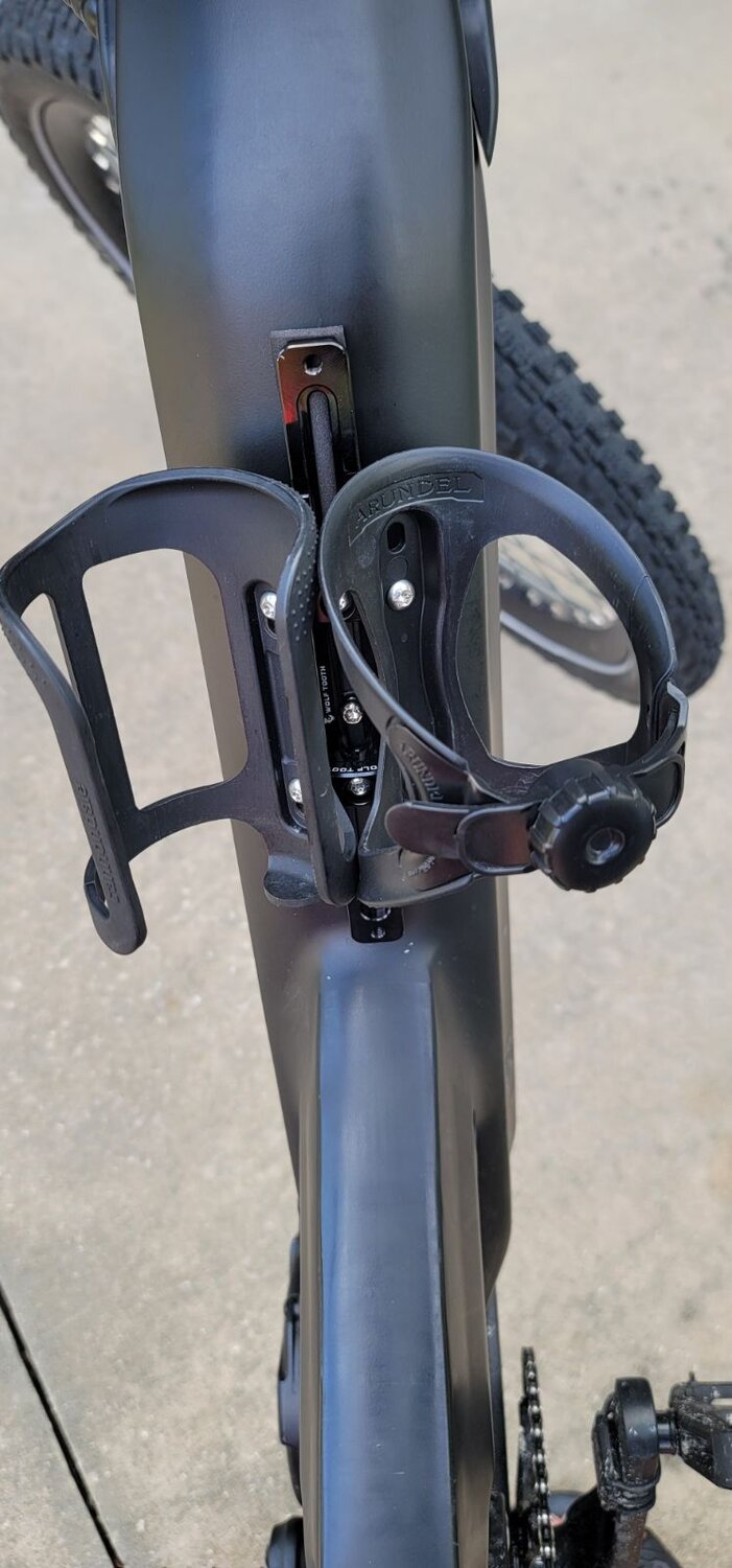

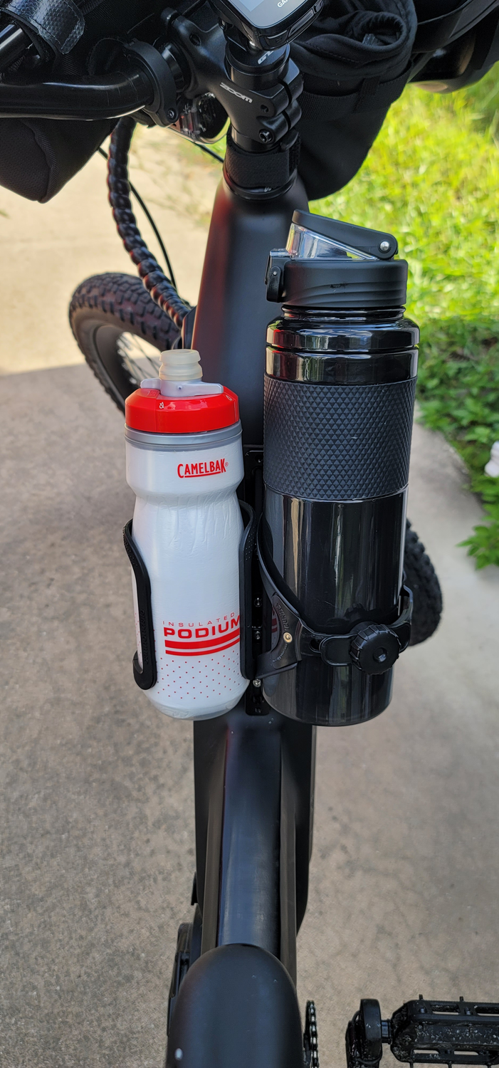

I ordered Wolf Tooth B-rad parts to have 2 water bottles in the place of the one. Just installed it, no ride with it yet so I can't say how it works. But it does fit. I think the 2 slot option would have been better. New front fender comes in tomorrow.

I actually like my water at room temp if I am chugging it. Plus if I had it in a bag behind me, that means I am stopping every 15 minutes to have a drink.

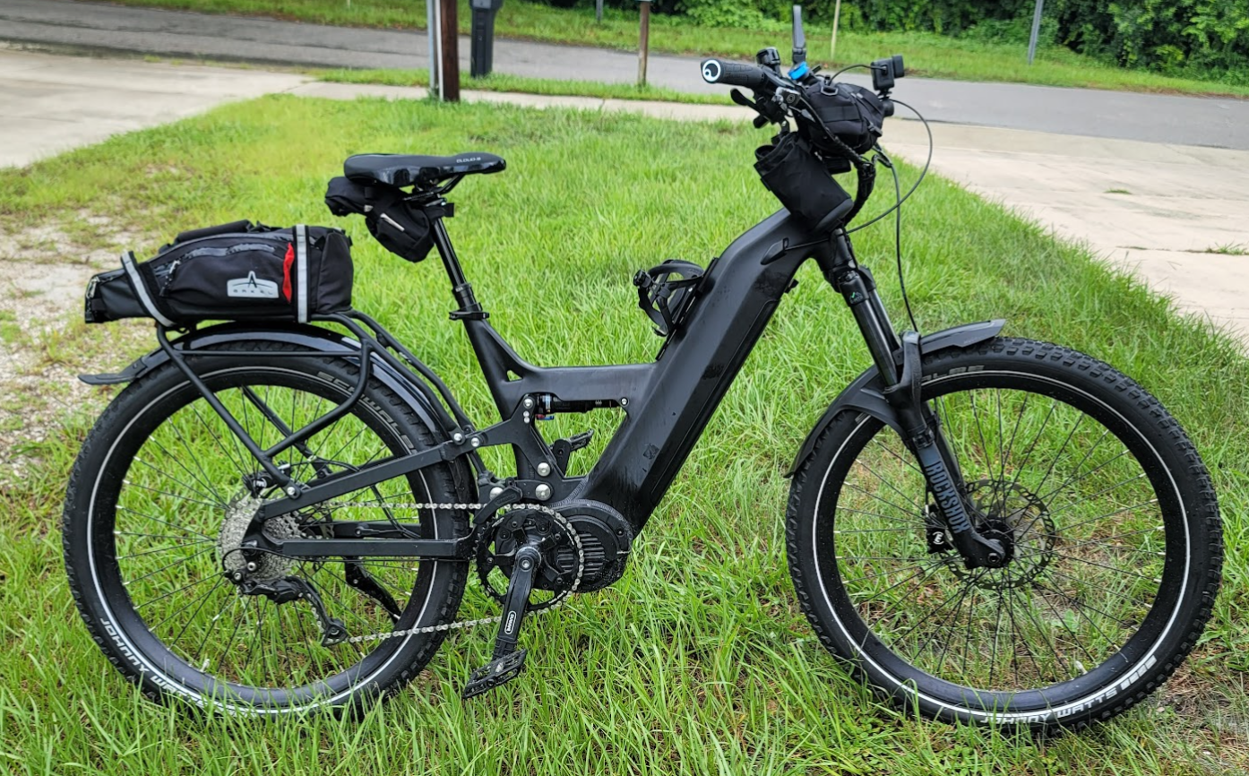

New SKS Mudrocker installed. Now seeing it from this angle I will need to make an adjustment to raise the back of it away from the tire. Still need to get the residual from the stickers off. Only have Iso alcohol and it didn't get it all off.

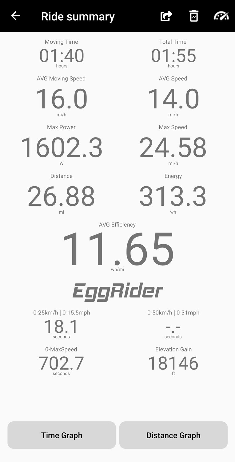

Results after the latest tune. From what I understand about the avg efficiency number, 11.7 is a good number. The ride was straight, really flat, with hardly any others in the way, and barely any intersections that we needed to stop. The battery is currently at 50.1v according to the cheap multimeter.
HOW THE F did I have a 18146 ft elevation gain?
I have no idea about the elevation. It is not cumulative, I just checked other rides. Very inconsistent with others. Unless I am riding some Florida mountains I am not seeing. And if that is the case the wh/mi thing is totally beyond belief and awesome.

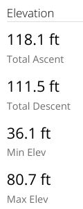

I think it is missing a decimal point. This is from my garmin. And still wrong.
