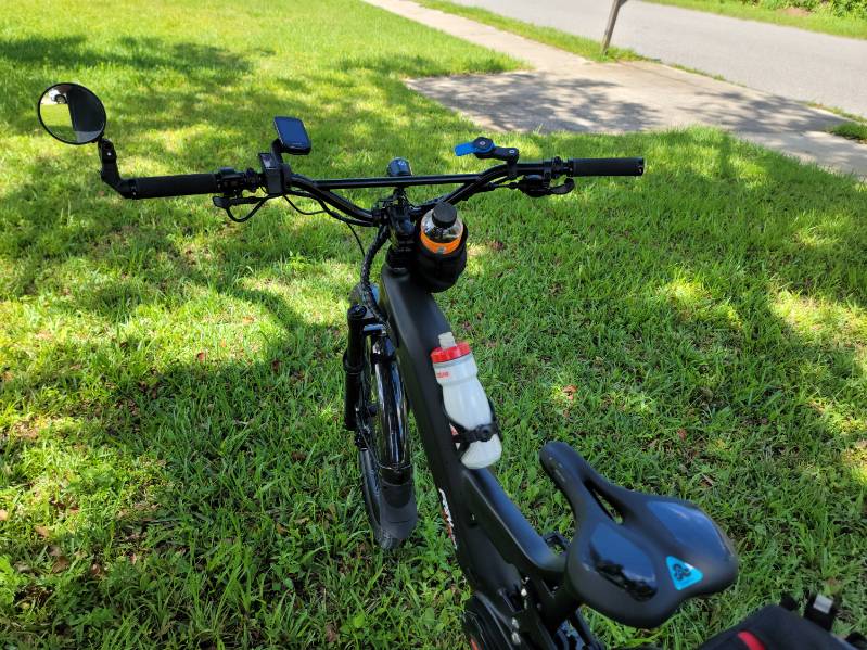

Did a quick install of the Surly Sunrise bars today. The clamp size on it is 22.2 mm. Luckily comes with a shim. Initial thoughts, mounting the stock screen will require some rubber shims and some creative screen mounting. Luckily I have an Eggrider coming in next week.
Not sure I need to cut down the bars yet. I had to stop the install as I needed to go get a suture check.

Got the Surly Sunrise bars installed. After a bit of trial and error I got the extras added. The Eggrider came in today also so it made the install easier. Was able to get a 7.75 mile ride in to see how it felt. So far so good. Need a longer ride to see how the positioning is situated.
Initial thought on the 820mm width. I want to cut off 20mm. I felt more comfortable moving my hands closer to the middle. Will wait though. I want to try a different grips first. The grips could be longer and force me to move the levers/controls/extras in some.
Also got the 46t chainring installed. A bit better. Worried about the chain length. Need to contact Frey to see what the chain and chain length they use for stock and if they have a recommendation for a 46t chainring . I think I need some extra links.

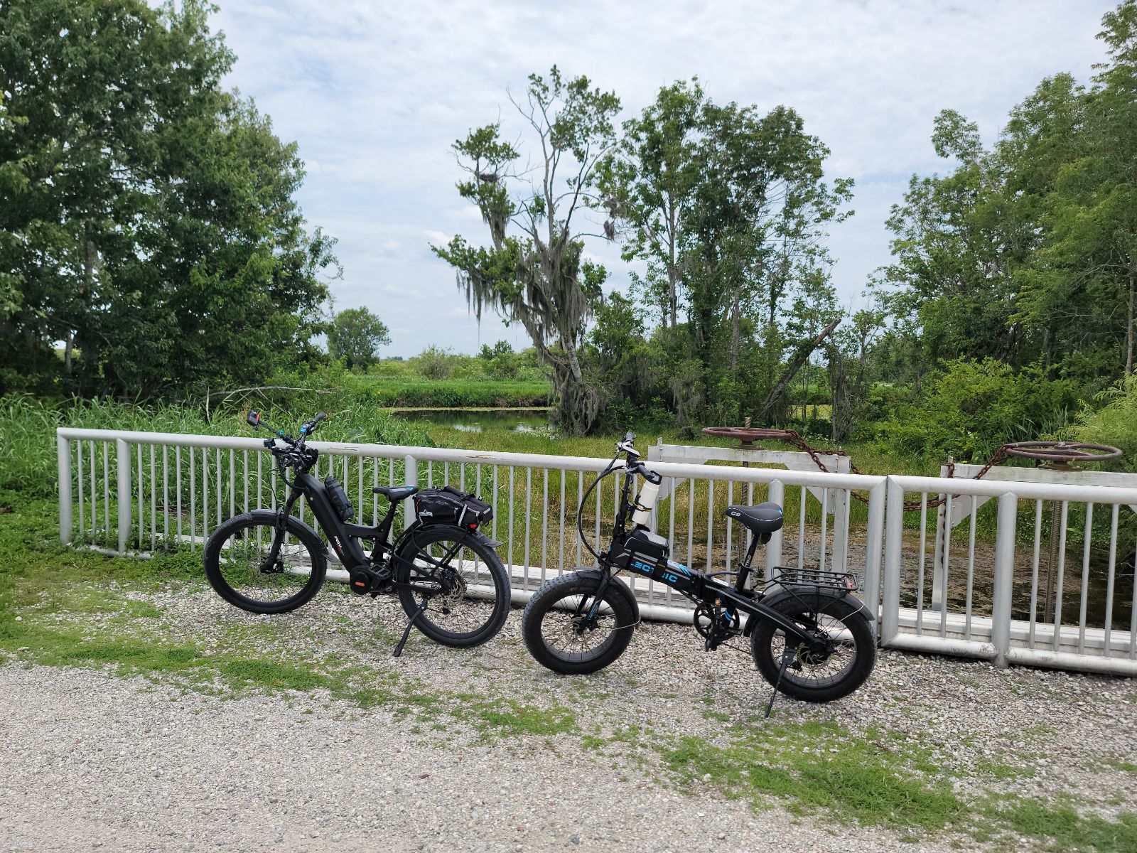

I friggin' love this bike. Did a 35.17 mile ride on bumpy hard packed roads. Average moving speed was 13.1 mph according to the garmin. I powered the bike up once home and I still have 48% battery left. This was not one of my normal rides. But just WOW.
My riding partner with his Lectric 1.0 made it and still had some juice left.
