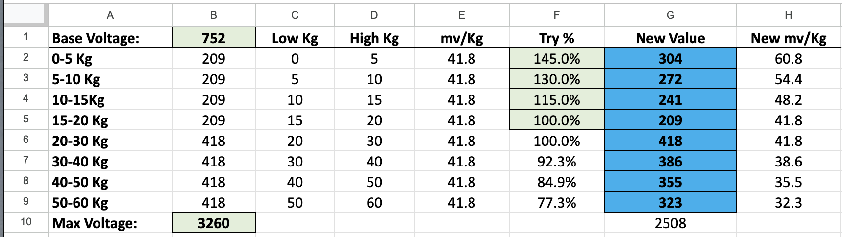

This maxes out at 145% instead of 150% or 175%. You'll want to play with changing the F2, F3, and F4 values to see what works best for you. You could even put in 100% to see how if a linear mapping is what you want. If linear helps but it's still too much at low torques (again assuming that low PAS level setting) then we might need to look at an inverse mapping for you.
