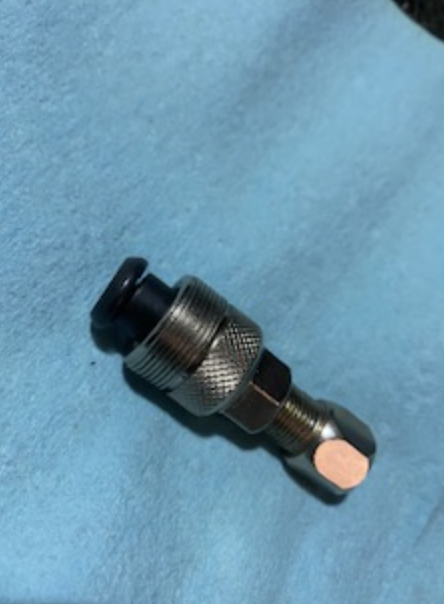

This is a crank puller. With the splined type crank you need that little black ( not always black ) piece on the end. A small bolt will do but you can find the puller on lots of sites.

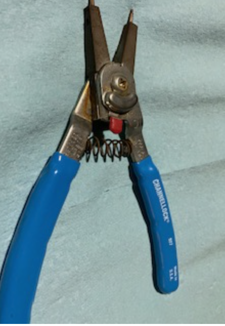

Thes sorts of pliers have two actions. One spreads the tips apart ant the other moves the ends like regular pliers. A good pair comes with different sized tips. There is a fairly large C clamp that has to come off before you can take off the safety nut.

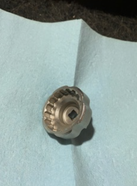

This is the safety nut socket. The one I have has a 3/8" drive hole but my big ole torque wrench is 1/2" so I have an adapter. The safety nut must be torqued to spec.

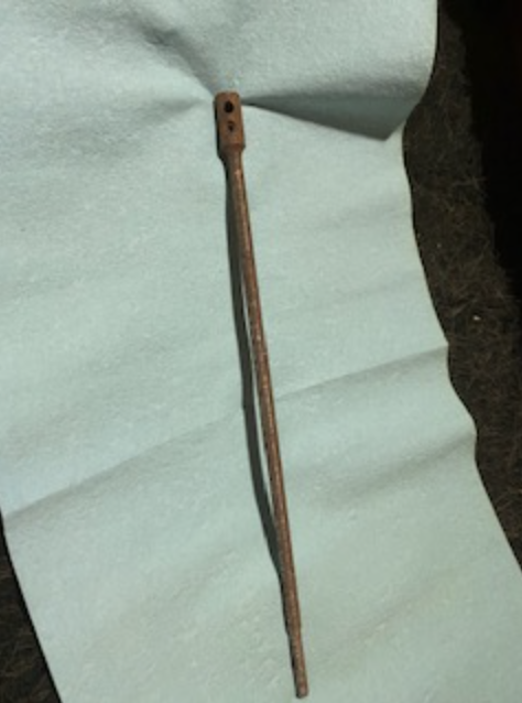

Finally this is what I use to drive out the motor mount bolts. They are tight and they won't come out any other way. Getting them back in is a trick. It's just a drill bit extension. Lots of different things would work.
