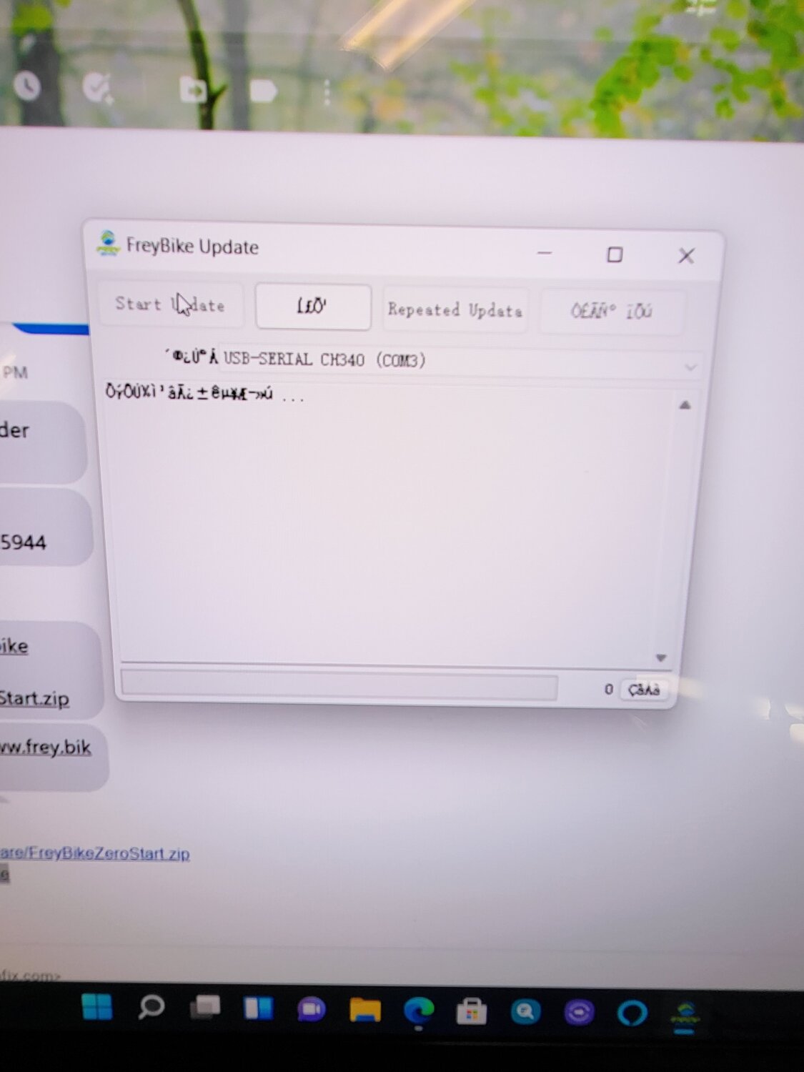

OK, it cannot be done with the normal software, the config tool.
A special piece of software is needed to Ivy shared with me and I managed to get the upgrade done.
My HT now has throttle from zero!
Two stumbling blocks, 1) my antivirus software killed the file that Ivy send me every time, I had to make an exception in the setting for it.
2) the software body is in Chinese, two buttons and the instruction are in English.
It requires the USB programming cable and a laptop with the small .exe file on it.
It starts with running the little program with the USB side of the cable in the laptop, don't hook the cable to the bike yet!
Check the software finds the correct COM port, mine was COM5.
When that is OK, press Start Update and only than connect the green plugs of the bike to the programming cable.
The software will see the connection and the upgrade begins with unreadable text on my screen as it is an English laptop it doesn´t show the Chinese characters.
Once it´s finished (which is obvious on the screen) disconnect the connection between the bike and the USB cable.
Connect the screen back to the green connector and turn on the bike, after screen is on, lift the rear wheel and rock the throttle for a test spin........
Hi,
I know this is an old thread but hope you can help. I have the software you described (sent by Frey). For the longest time I couldn't get it to work. I thought the cable I got from the companny was bad, but just got a new one and still it's not working. I connected the cable to the laptop first. It selected the right COM, so I hit start update, then connected the other end to the bike green plug. All I see is this screen, which I couldn't understand. Is there something else I need to do before the software runs? Thank you!!
Thank you for the link.....I saw that, but I need the one brake064 talked about which is a step before this one (this youtube also mentioned driver download). I couldn't download anything even after following instruction of clicking and connecting :( Freybike just told me to reconnect the cable, which I did several times and even got a new cable. I was just wondering if anything else needs to be done. I hope it's not because I have a defective product!
Try this link
Or this one. Giel knows his stuff.
