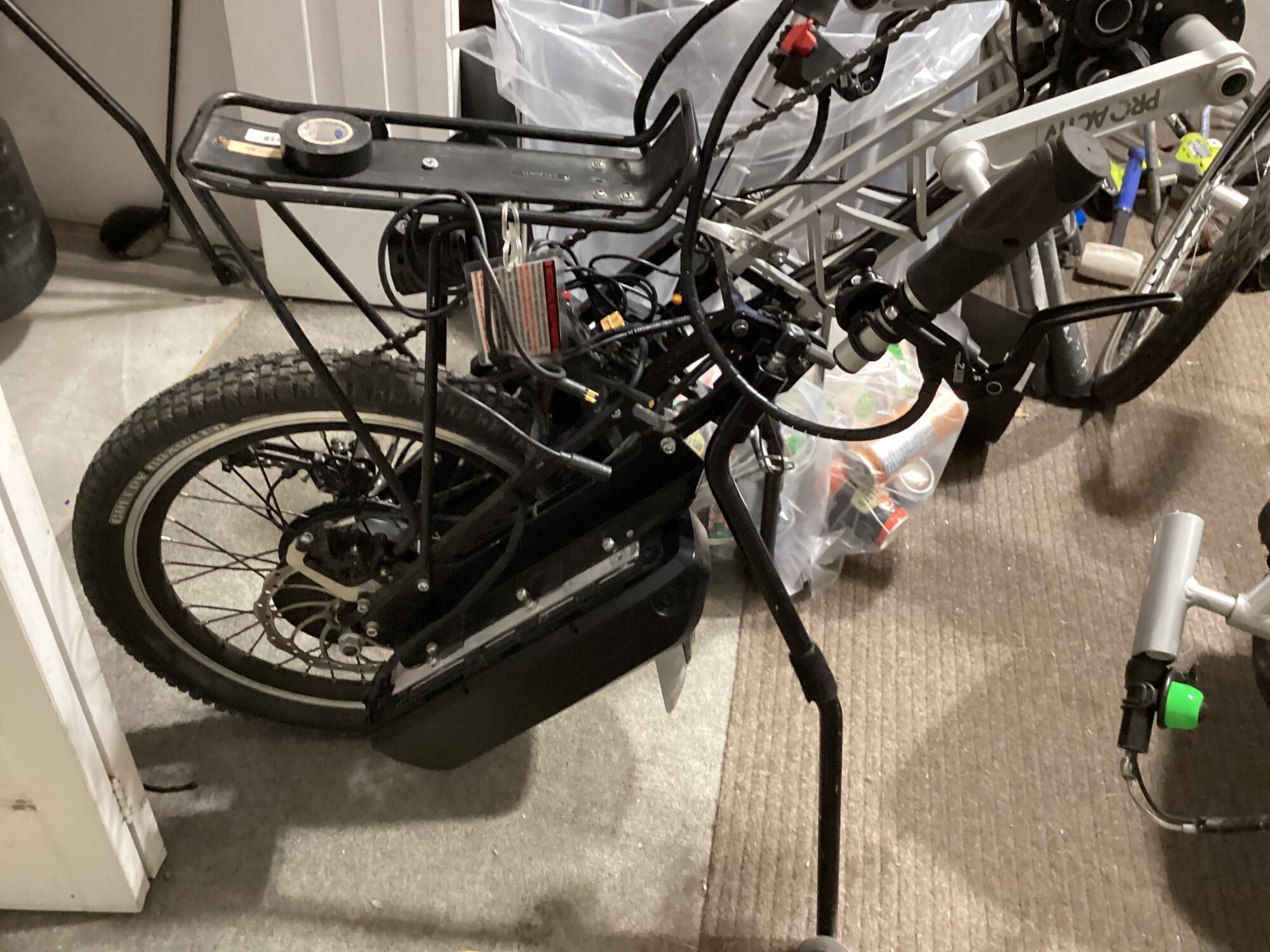

Bafang 48v 500w Rear hub motor, system switched off going up a steep gravel hill with throttle and a push! After a few minutes I was able to turn back on.
Riding now, it keeps turning off, likely under load - so far I am able to turn back on and get home - this is on my handbike.
We switched controller and batteries - still does it.
Display also doesn’t show speed anymore.
Any advice - urgent as set to travel with handbike next week.
Many thanks

wires are undone as we tried a different controller, reassembly this morning

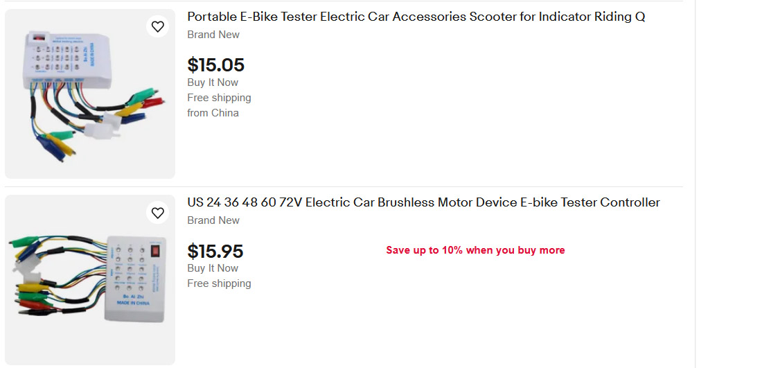

Most sensors are mounted on a circuit board. If you have time, it;s worth buying a $15 ebike tester on ebay as they will test your wheel sensors in about 30 seconds. This is a G020.
Typical testers. Might get them overnight on amazon for 2x more.

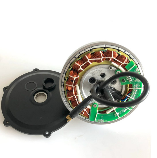

I have two of these G020.500 motors on two different bikes myself, although mine are FM's (Front Motor). The speed sensor is internal and there are six magnets glued directly to the casing inside. You should be able to see them in a circle.
It does sound as if the motor may be cooked, though. If the copper wiring is black or black-ish then thats the sign of overheating you don't want to see. There's no repair for something like that if it happens. Only replacement.
Great info thanks, we have the faulty motor out of the hub but we couldn’t seperate the cover plate from the motor to check the magnets!
Remove the screws, then hold the motor with both hands, one on each side, axle facing down and cover plate side up. Gently bash the axle directly onto solid ground (like cement pavement). This will force the motor apart. Common technique I have even seen used at the Bafang factory.
