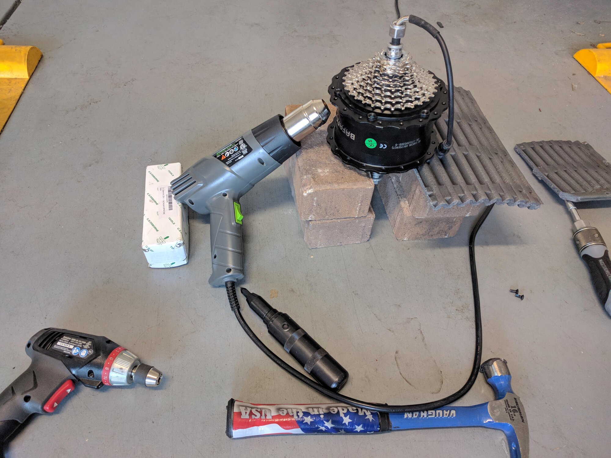

we removed the cassette, but the very small screws did not want to release! So we stopped!
OK thats because you have a motor that has had loctite applied to it. Occasionally you get that. I've overcome this before.
Most likely yhour only recourse will be to swap in a good motor core into your existing wheel.
First, get yourself a heat gun. Set it on its lowest setting and direct the gun's output to one of the screws. Don't do it for more than a couple of minutes. Then, once its good and hot, carefully (don't burn your fingers) try and remove it. Once I did a motor with Phillips head screws and after heating it I (gently!) tapped the hot screw with an impact wrench that had a Phillips bit in it. There was no way it was coming out even with a screwdriver after heat was applied but the gentle twisting that came with an impact wrench got it smoothly and safely out.
Note I am NOT talking about a power tool here. The impact wrench is what looks like a fat screwdriver below. Hitting it with a hammer creates a sideways twist in addition to the impact downwards. Usually these tools are hammered hard. Don't do that. Also note the padding I had that went under the motor, since I was going to be using a hammer. The motor was sitting on the bricks, the heat gun directed at the one screw, and the impact wrench was used immediately after moving away the heat gun.
The heat gun can probably be substituted with a hairdryer running at full blast. And you can try just a screwdriver although that did not work for mine.
