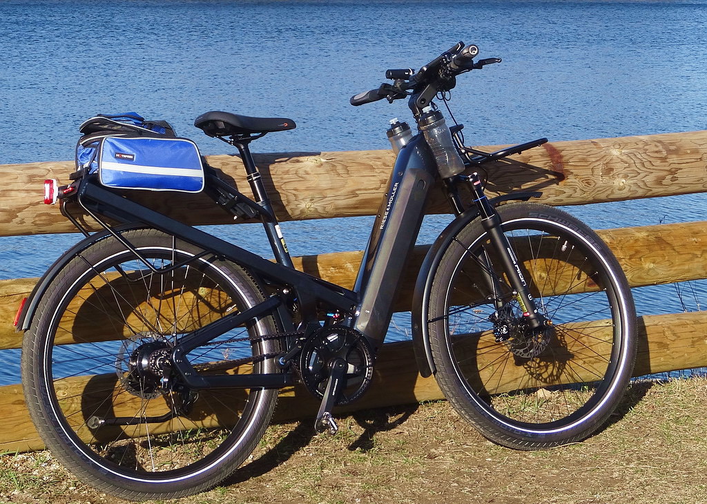

Current ride is a R+M Homage GT Rohloff Class-1 with dual-batteries.
I really love the Homage and intend to keep it.
At the time I bought the R+M, it was the only step-thru frame with full suspension that I could find anywhere, but in the last year they seem to becoming a more popular style of frame/bike, and I am now looking for a stable-mate with a throttle to ride rougher/steeper off-road trails where a throttle will allow me to ride up hills I would otherwise need to dismount for due to pedal strikes on the current bike.
(or, when my knees are just not in the mood to do much pedaling that day...)

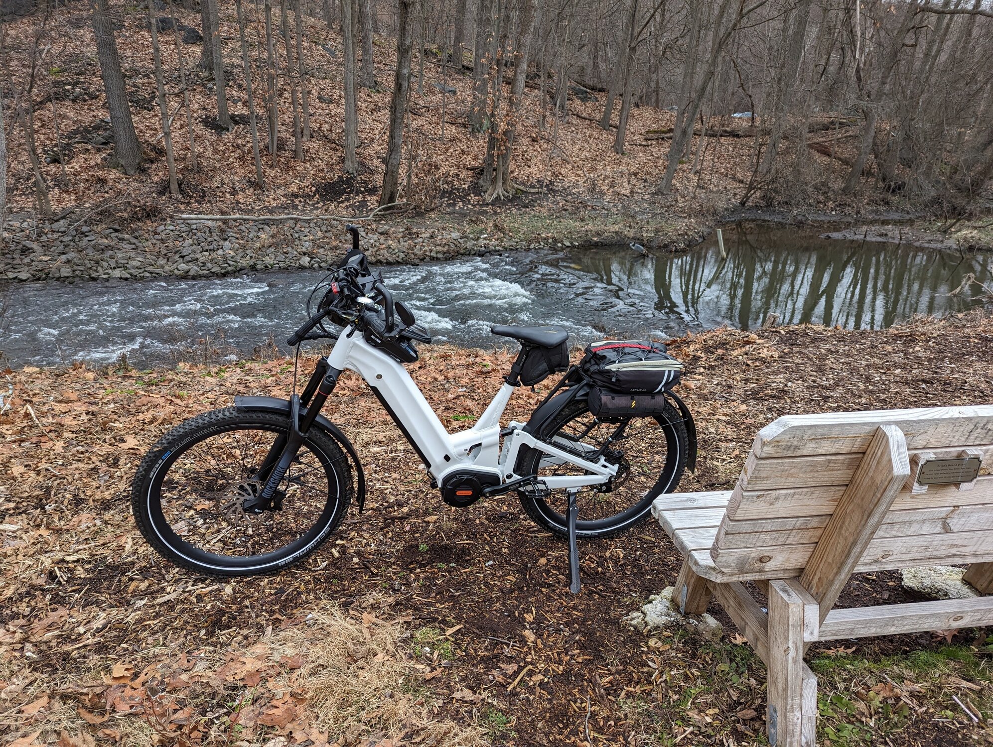

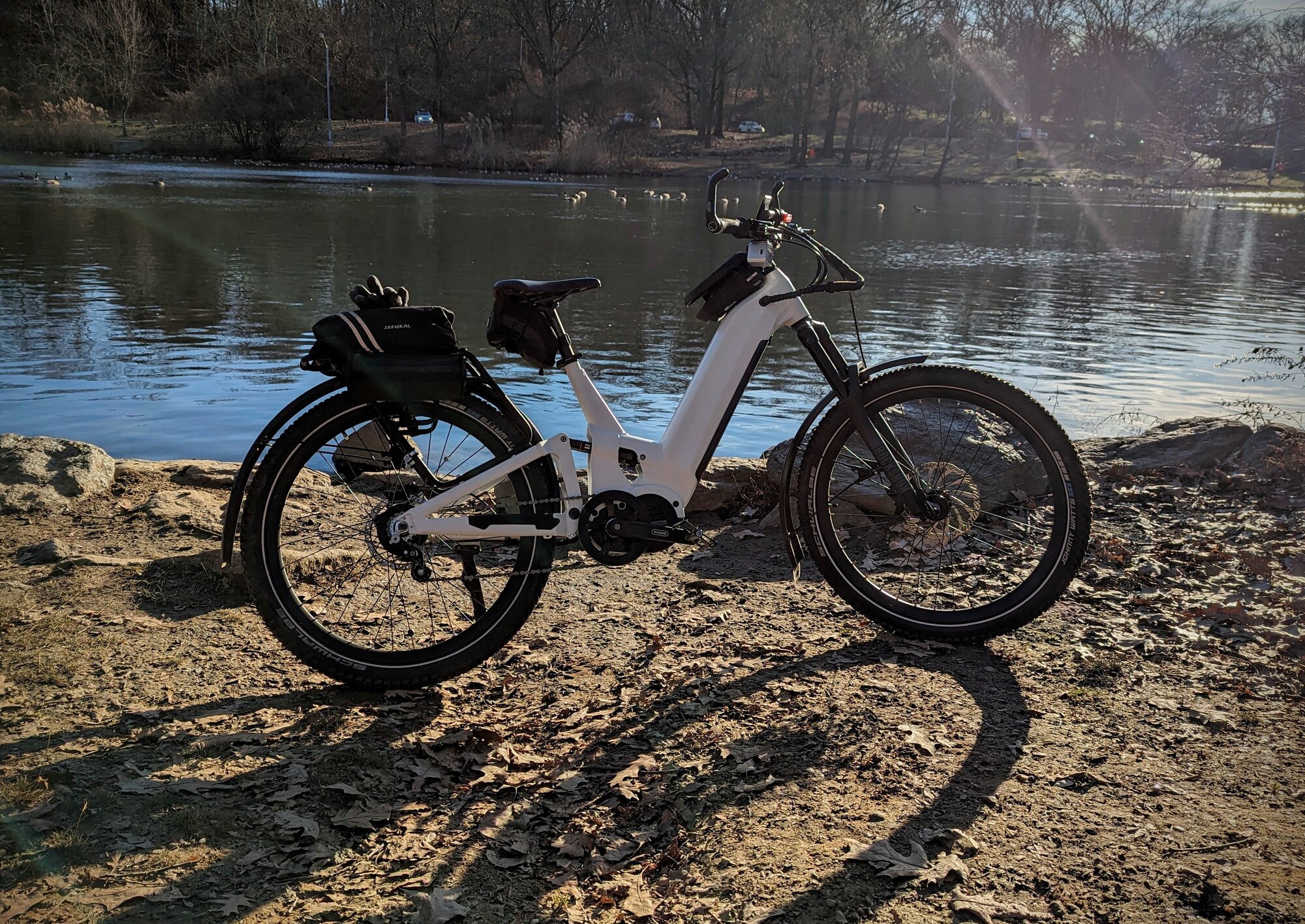

I have a Zen eBikes prototype (not available yet) that is very similar to the Biktrix with a Rohloff and Bafang Ultra mid_drive.
Love the ride and power as it will climb anything but can still be efficient if rode conservatively on paved surfaces.
I do pedal strike on deep root and rocks if not cautious.
On the downside it is heavy. Not an issue when riding but can be when manhandling.

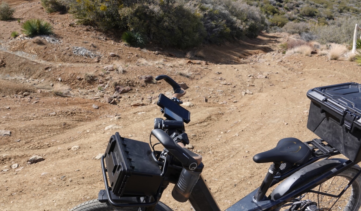

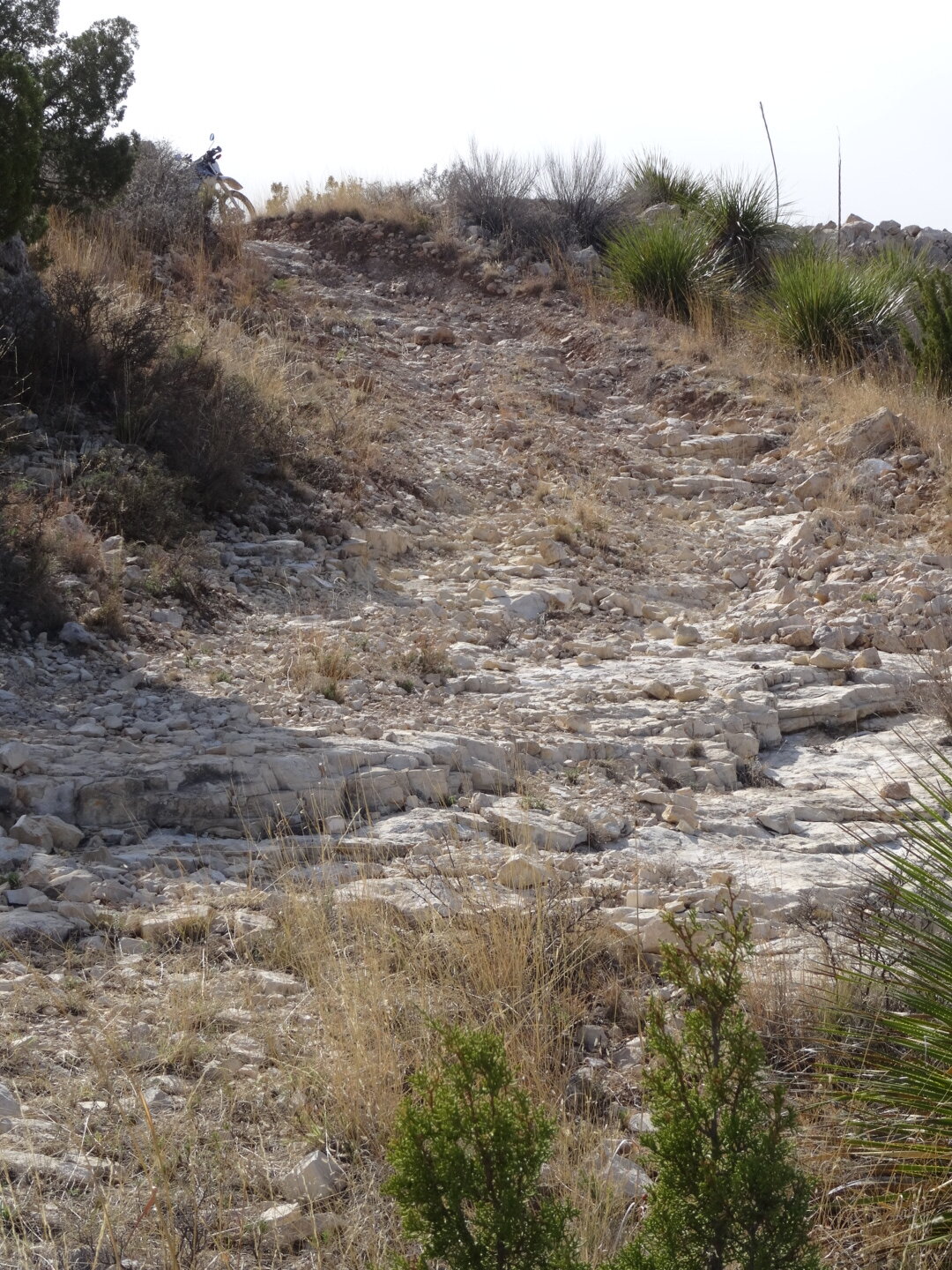

Because sometimes I take trails with ruts that are impossible to pedal in, rocks & steps big enough to bash the motor against.
There are also grades so steep & rough that if I have to stop in the middle of them, there is no way to get going again trying to pedal.
View attachment 176976 View attachment 176977
That looks very close to my ideal setup!
When will they be available to the public???
I see that it has a RockShocks fork, what is the rear shock?
And is that a dropper post I spy?
The steering angle also looks very "relaxed" for better rough surface stability.
About the only thing the Homage has that this is missing is the belt drive and the rear rack being a part of the main frame (rather than being part of the rear triangle).
I do find that having the rear rack and cargo as a part of the suspended main frame makes the Homage more stable and smooth riding than the typical unsprung rear rack configurations of most full suspension bikes.
As far as weight, that is not as much of an issue, because I transport my bikes in an enclosed trailer with a rear ramp door, and I am already used to the weight of my dual-battery Homage at 75lbs (34kg).

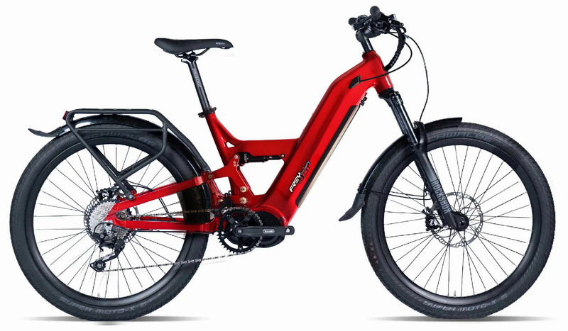

Of the ones you posted, I'd vote for the Frey and then the Biktrix. The Frey looks to have some sort of dual-link suspension (which are hard to design and manfuacture, so hopefully they got it right). The Biktrix appears to be single pivot. The Frey has better components. Its a more upright head angle than the Biktrix. Its hard to find people who actually ride these sorts of bikes on the trails you're riding (I'm sure they are capable, but they seem to mainly be bought by people who want a high power comfortable pavement commuter).

I am mostly riding on jeep trails in national parks and desert areas in the southwest. They are open to any road legal vehicle.
Gotcha. Its an issue not from a "you're not legal" standpoint, just in that most companies with deep knowledge of MTB geometry and suspension design are exclusively selling class 1s since thats where access generally is. Sounds like you could do an e-moto if you want, but you do want to do some pedaling as well.

I have to say the Frey C-C is the only step thru that, over the years, I have considered acceptable for that style of frame. Its got good suspension components, a motor that is being run well below its hot rod level capabilities and you can expect to last pretty much forever. It also has been out on the market for several years and has had plenty of time to have bugs turn up (haven't seen any). And as noted above, it looks to use a decent level of engineering in its frame design.
For trails, I have to say a step-thru would be far from my first choice of frame design, but the C-C looks to address (as best as can be) the concerns I would have about the frame working on a rough dirt doubletrack.
My main concern with the C-C is it appears to be offered in only one size, with a 640mm top tube. That would be a large from most mfgs. Pretty big bike. If you're in the 5'10"-6'-0" range, probably fine. But thats not a universal size, even though they are listing it as one.
It's pretty close to the largest Homage frame. But yeah, if OP is used to a small or medium it's gonna be kind of big. Some of the reviews have also said it is closer to a mid-step than a low step or step through. Hopefully OP's knees are good with that.
FWIW, Frey was very open to upgrading suspension from the factory upon request when they first released the CC. Not sure if that's still the case now that they gave a US warehouse.
