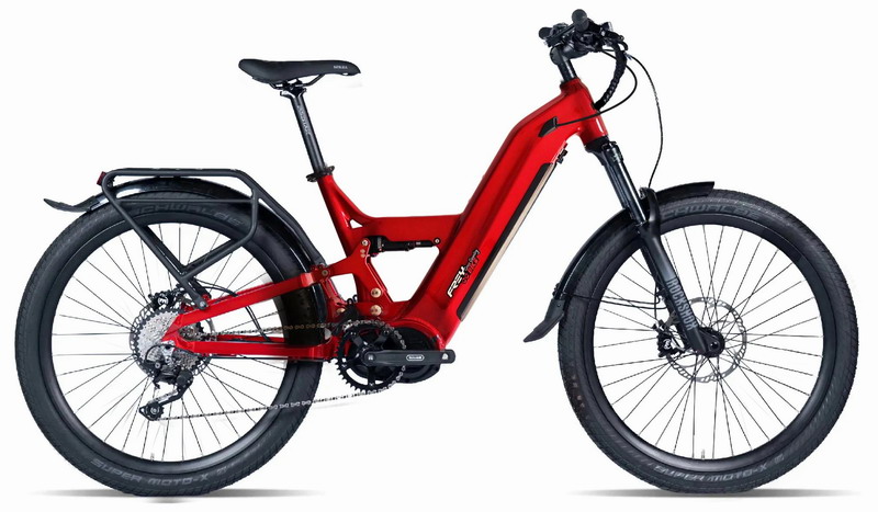

Of the ones you posted, I'd vote for the Frey and then the Biktrix. The Frey looks to have some sort of dual-link suspension (which are hard to design and manfuacture, so hopefully they got it right). The Biktrix appears to be single pivot. The Frey has better components. Its a more upright head angle than the Biktrix. Its hard to find people who actually ride these sorts of bikes on the trails you're riding (I'm sure they are capable, but they seem to mainly be bought by people who want a high power comfortable pavement commuter).
Thank you for your input on the models I have under consideration.
The Frey CC has been the one that I have been coming back to look at most, but it does have the highest step-thru section, so not sure how I would get along with that. It is so high that I might be able to get a real eMBT with the same stand-over height.

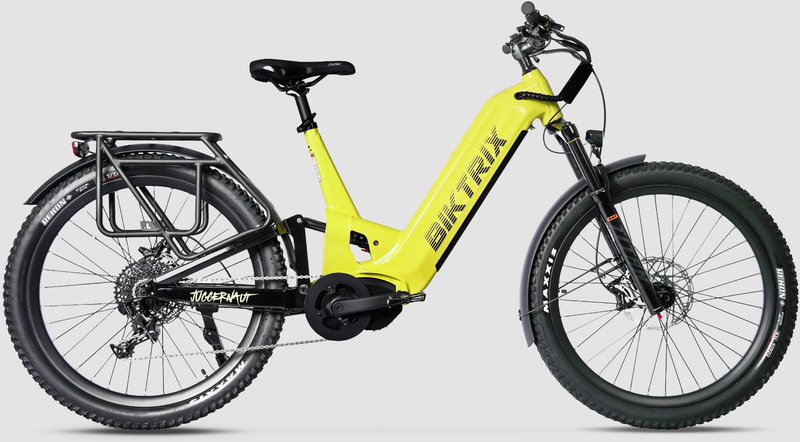

Yes, the Biktrix is a single point rear swingarm, but does have a slacker head tube (64-deg vs. 68-deg){69-deg head tube angle on the Homage}, for good off-road steering stability.
In addition, the bike comes with a huge 1.3KwH battery with the option to add an extra 1.1KwH second battery pack for extended range.
Also, the fork can be upgraded at time of purchase.

I have to say the Frey C-C is the only step thru that, over the years, I have considered acceptable for that style of frame. Its got good suspension components, a motor that is being run well below its hot rod level capabilities and you can expect to last pretty much forever. It also has been out on the market for several years and has had plenty of time to have bugs turn up (haven't seen any). And as noted above, it looks to use a decent level of engineering in its frame design.
For trails, I have to say a step-thru would be far from my first choice of frame design, but the C-C looks to address (as best as can be) the concerns I would have about the frame working on a rough dirt doubletrack.
I am not jumping off of or over anything nor trying to haul an elk strapped over the rear rack, so I think a step-thru frame will be just fine.
It's pretty close to the largest Homage frame. But yeah, if OP is used to a small or medium it's gonna be kind of big. Some of the reviews have also said it is closer to a mid-step than a low step or step through. Hopefully OP's knees are good with that.
FWIW, Frey was very open to upgrading suspension from the factory upon request when they first released the CC. Not sure if that's still the case now that they gave a US warehouse.

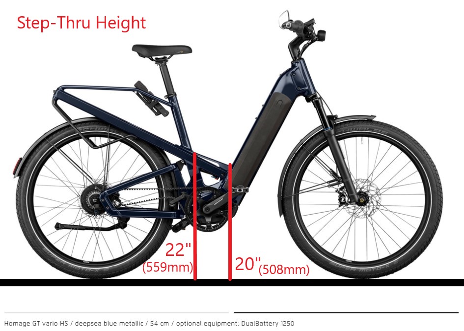

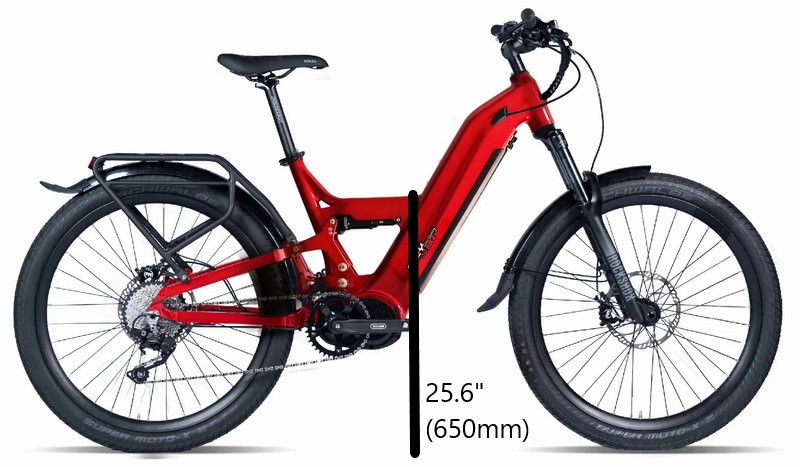

The step-over/stand-over height of the Frey CC is why I have not ordered one yet.
As I mentioned in another post, at 25.6" (650mm) I am not sure that it is much better than the stand-over height of a smaller eMBT frame.

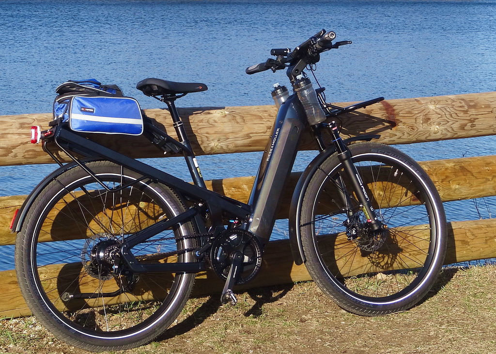

My Homage is the small frame (49cm), which has a step-thru height ranging from 20-22" (508-559mm)

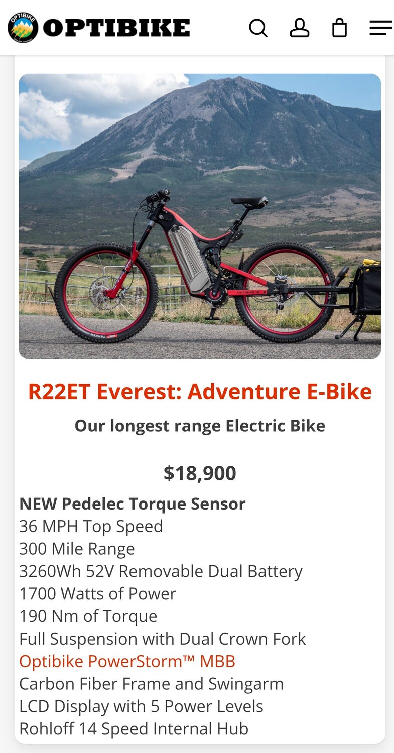

Actually I consider the Optibike R22 Everest to be the BEST ebike money can buy.
https://optibike.com/
But it is VERY pricey!
And that list price doesn't even include paint, lights, or a kickstand...
With paint, upgraded front brake rotor, fenders, lights, tire inserts, and a kickstand the price goes up to $21,500.
But just look at those specs!
The suspension has 200mm of rear wheel travel with a shock and downhill fork by Fox.
2,500 watt peak power with 190Nm of torque being multiplied through a Rohloff hub, and 3,260Wh of battery!

The optibike is a beautiful bike, no question, and unless you are really needing the range, you can take it with the standard battery (lighter and "cheaper").
The only drawback is that last time I checked, they do not have a torque based pedal assist, so mostly a throttle bike....
Their newly released and upgraded motor now includes torque based pedal assist in addition to the throttle for USA models.
The new motor is also allowing them to sell UK/EU compliant models without a throttle and software limited top speed for the pedal assist, but with all the torque still available.
And yes, they do offer two different lower spec versions which still use the same massively powerful motor but with "only" 1,630Wh of battery.
But when you are already spending at least $14k on an e-bike, why not go ahead and get the big battery?
My main concern with the CC is you would be going from a small frame with a 58.5cm/23" TT to a pretty big frame with a 64cm/25.2" TT. Which is a huge difference in fit, even ignoring standover.

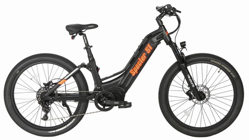

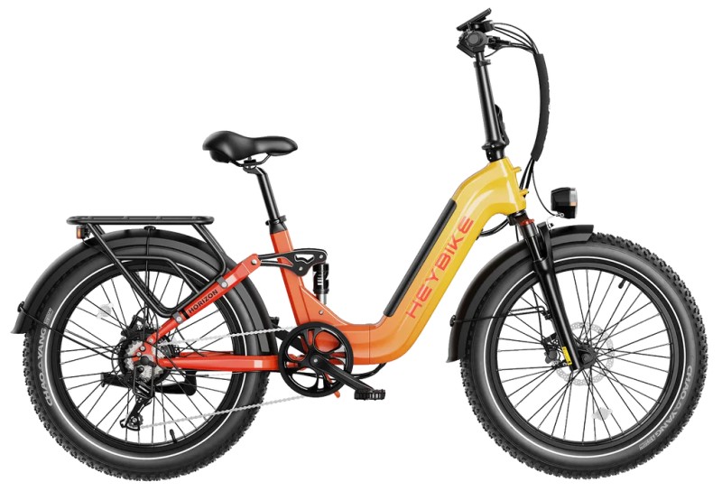

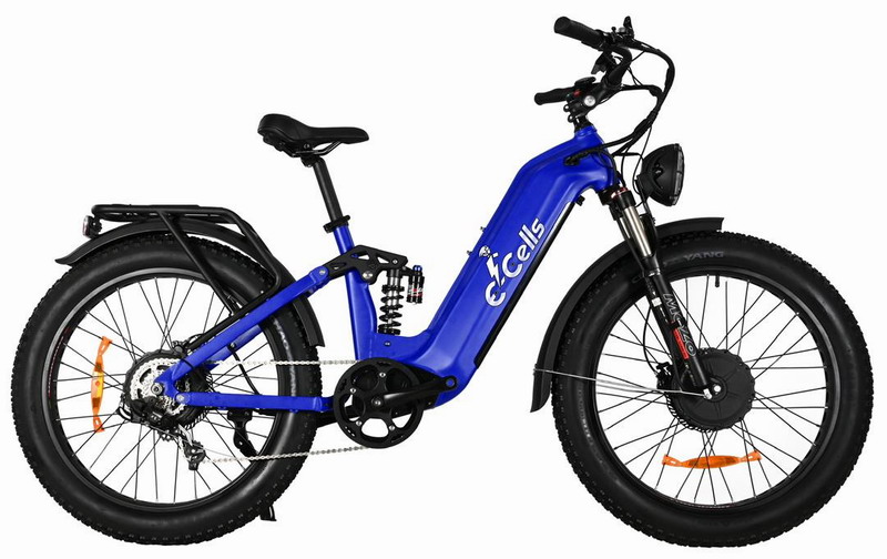

As far as e-bike options, I do know of a few potential candidates, but wanted to get some feedback from people who might have some experience with those Brands/Models, or if there are any bikes I have missed?
I know that there are a number of moped-style e-bikes out there, some with full-suspension and step-thru, and some with 2-wheel-drive, but I would prefer to find something with larger diameter wheels/tires if possible.
Potential candidates I have found on my own so far, are:
{click on model names to be taken to the website for each}
Does anyone have experience owning/riding any of the above?
Are there any that I have missed?
What about experience with the companies if you have not owned/ridden these exact models?
Build quality, customer service, availability of spare parts, ???

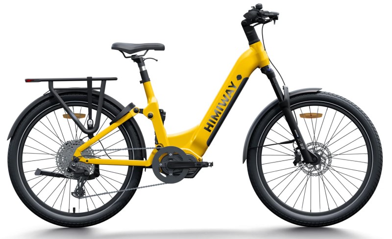

I own the Himiway A7 Pro & love it, putting 1,200 Mike's on it over 4 months. It's a very comfortable ride, and the full suspension is very nice on my back & knees (230 lb rider).I ride, mostly, in PAS 1 & usually get 40-45 miles per charge.
Negatives are the weight (77 lbs), lack of range (i like long rides) & commuter tires. I own 2 e-mtb's for mtn biking, but i do take the A7 Pro on easier, green trails where it has performed just fine. Love the shifting & the brakes have worked very well, too.

Current ride is a R+M Homage GT Rohloff Class-1 with dual-batteries.
I really love the Homage and intend to keep it.
At the time I bought the R+M, it was the only step-thru frame with full suspension that I could find anywhere, but in the last year they seem to becoming a more popular style of frame/bike, and I am now looking for a stable-mate with a throttle to ride rougher/steeper off-road trails where a throttle will allow me to ride up hills I would otherwise need to dismount for due to pedal strikes on the current bike.
(or, when my knees are just not in the mood to do much pedaling that day...)

2 - Step-Thru frame. - (Or, at least, a very low stand-over height) Again, thank my bad knees for that one.

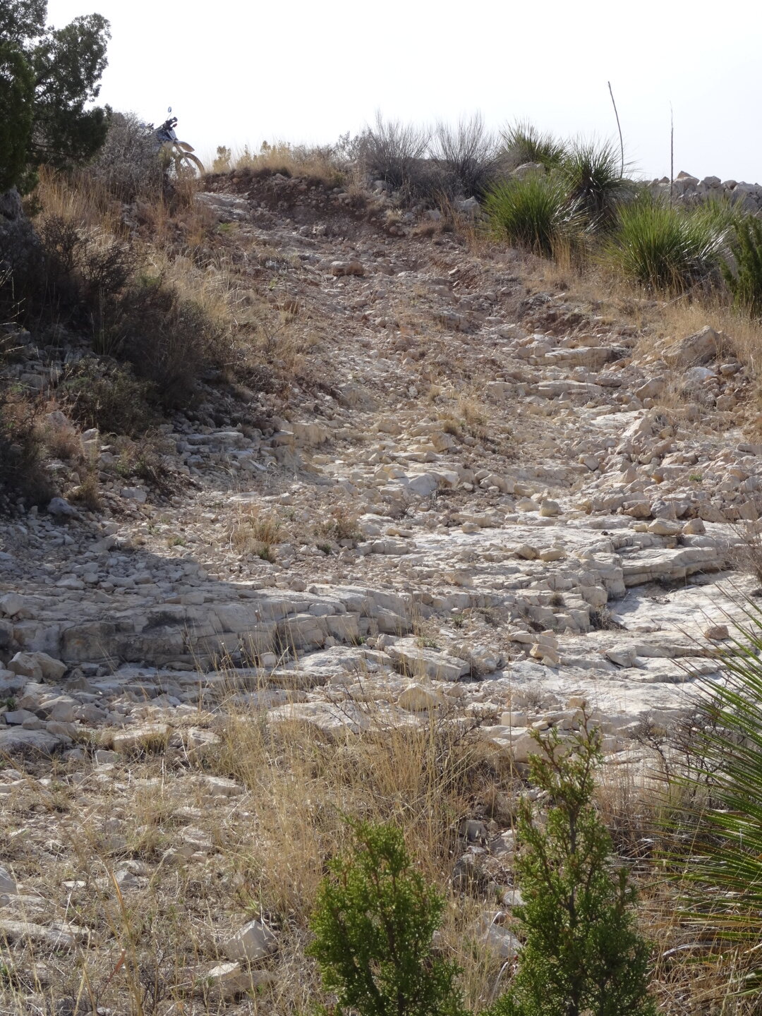

Because sometimes I take trails with ruts that are impossible to pedal in, rocks & steps big enough to bash the motor against.
There are also grades so steep & rough that if I have to stop in the middle of them, there is no way to get going again trying to pedal.
The R&M Homage is fully capable of riding hard terrain, and a rider who could still stand on the pedals and spin them while climbing probably could conquer the hills I struggle with, because my knees and ankle don't let me get out of the saddle to pedal any more.
