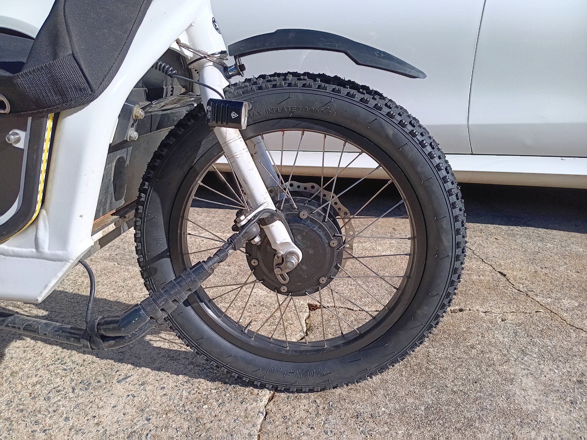

I have my motor in the front to not over load the rear which carries the groceries, tools, water, spares. Front motor not useful in grass over 6% grade, but I ride in grass rarely, mainly to fix my tractor when stuck out in the field. Took a chunk of concrete to throw in the sinkhole 2 weeks ago, tire slipped on the upgrade coming back so won't do that again.

Speaking of which, a 2.40" Maxxis Minion will, thanks to its relatively supple casing and knobs, be a really REALLY good cargo tire and get you through quite a range of terrain, including pavement, comfortably. Just keep it aired to 45 psi and not the 65 its rated up to.
