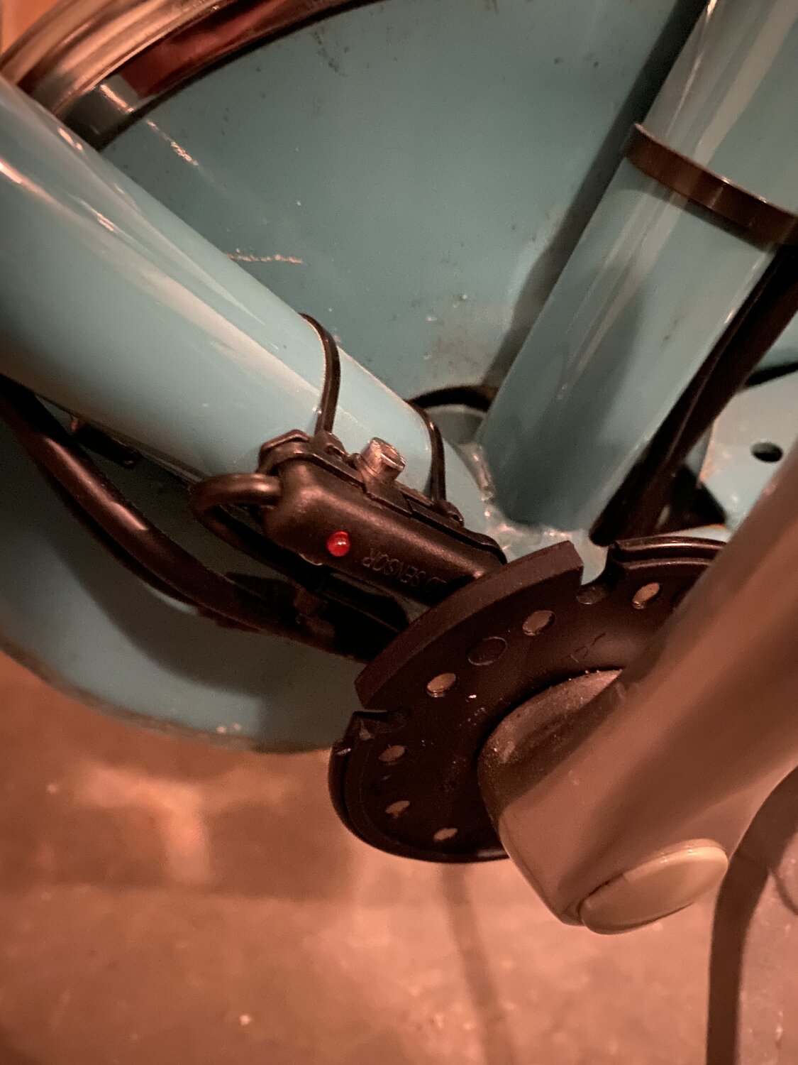

I purchased the Bafang front hub motor kit & mini shark 48V 12.8Ah battery. I also purchased the LCD display C961 & eBrake cut off. My local bike shop installed it, and I've taken the bike back to them, but nobody seems to be able to solve the problem. I haven't actually ridden the bike that much since the install, but it stopped working after sitting in the garage for awhile. I could switch everything on but no peddle assist either through the pedals or through the lever on the handlebars. If I unplug all the connections on the bike (from the battery, at the hub, and on the central frame bar) then it usually starts working again. The bike shop owner seems to think it might be some kind of static charge build up? I did notice that when I plugged the battery into the charger I was seeing a spark between the charger and the battery, even when the charger was not plugged into the wall.
Has anyone else had a similar problem? Any advice on how to solve the issue? I'm not riding the bike because twice now it has quit on me when I was far from home . . .

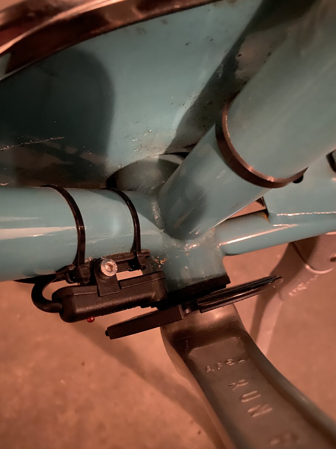

Is that this part? I notice that the little red light here is sometimes on and sometimes off, even when the peddle assist is working. The screw here is not particularly tight so I can toggle the piece with the light back and forth.

Yes. the red light should flash when the magnets in the wheel pass the sensor. SOME firmware will stop the motor if the PAS sensor and magnet are not functioning. Move the sensor to a position where the led doesn't flash. Will the motor run? No error codes on the display?
Thank you for the tip! That seems to have solved the problem. When the sensor is moved away, the pedal assist doesn't work. When it is closer, it works. No error code either way. I'm going to let it sit for a few days and see if it still runs as it seemed to not work after sitting for some period of time. Hope it was as simple as this though.

Regarding that sensor in your pics above, you need to arrange that disk and sensor so there's something like a 1/8" gap between the senor and the magnet wheel for it to work.

As for the PAS disc, it looks like the shop has it aligned pretty straight but if it is not and the disc is different distances from the PAS sensor as you pedal, so some of the magnets are not being read, then that could cause issues. But.. as long as some of the disc is close enough, I'd expect the PAS to feel like it's hesitating instead of not working all together although I'm not sure if some programming may be more sensitive than others.
Those discs seem to work best with three piece cranks. I've installed one on a one piece crank before, which that looks like, and it was a huge pain getting it to stay aligned well enough to consistently work. Not saying you're going to run into the same issue, but just be careful to make sure that disc stays in alignment.
