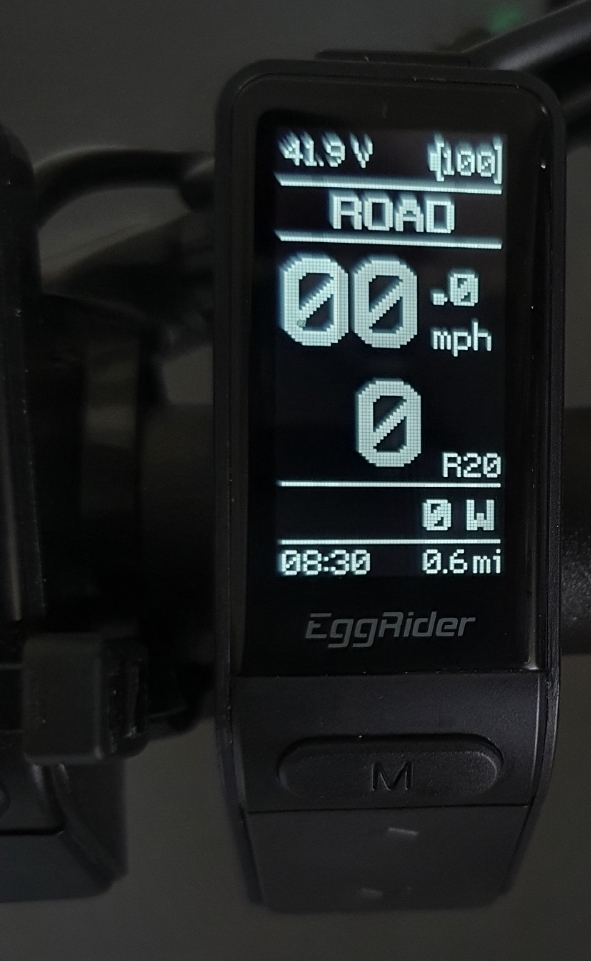

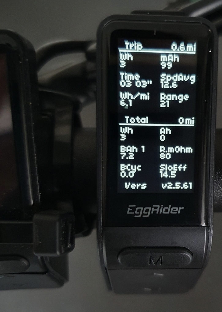

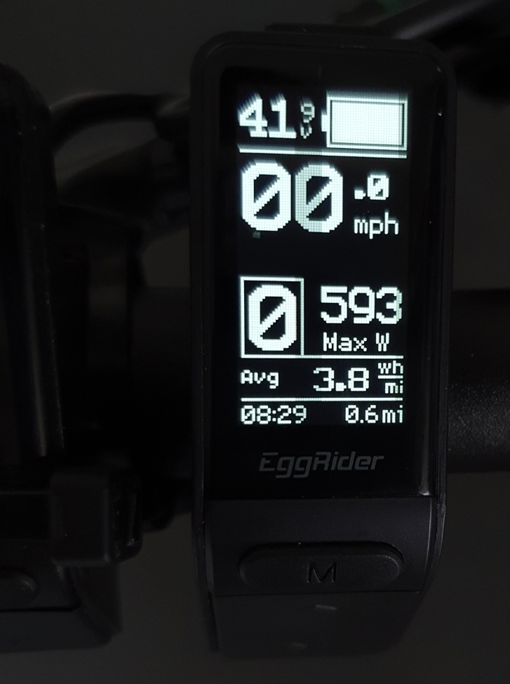

I got the EggRider display, and after a lot of messing around with settings and configuration, it might actually work!! 🤯😎
Not 100% sure it's accurate, but the display seems to be brighter and more visible in sunlight, and it has a lot more data available. Need to test out further, and verify accuracy of data. It was a pain to set up, but it may be worth it!
I may need a week or two to fully test it out, but went ahead and started a new thread with all the details. Here's some pics
