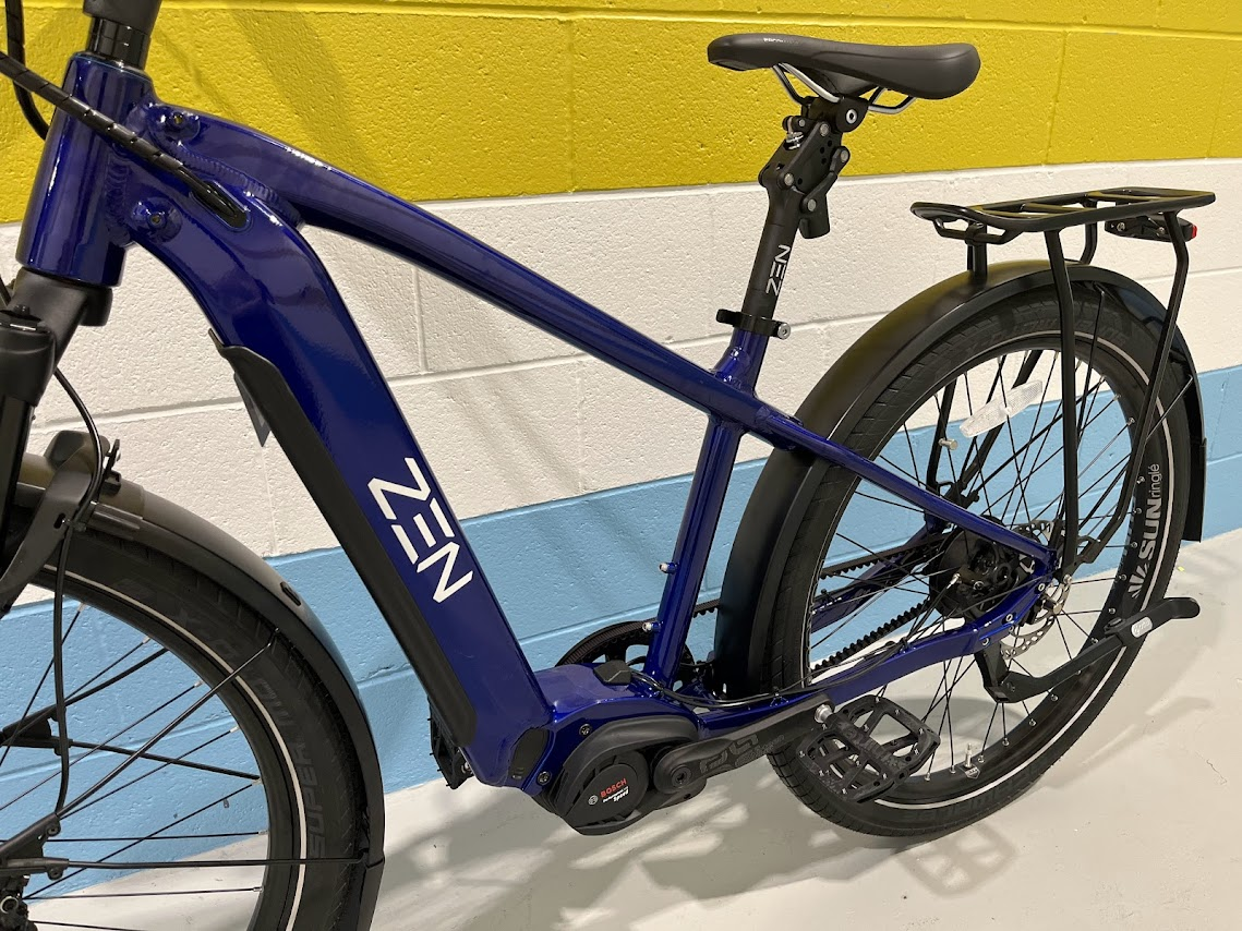

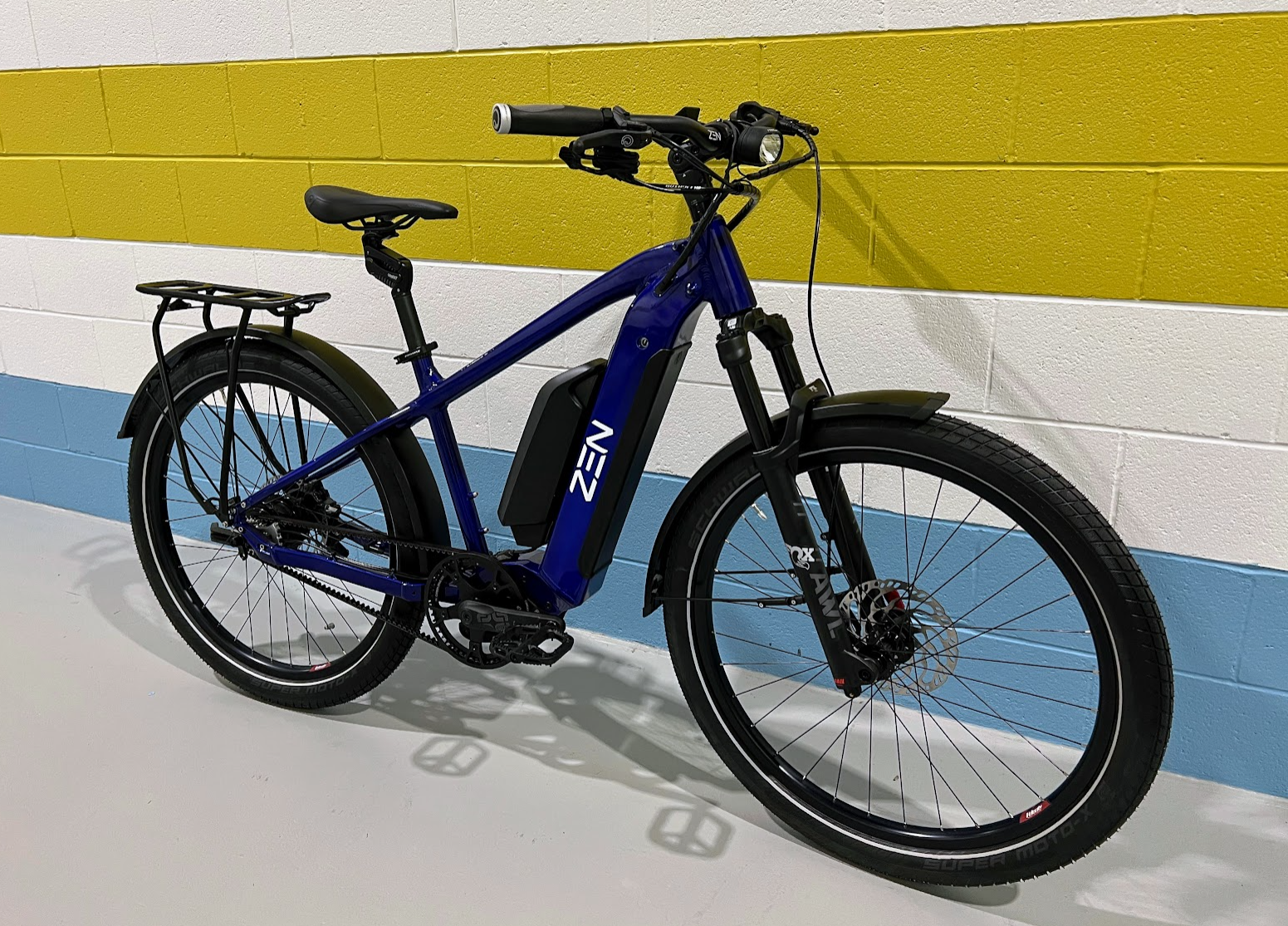

Based on the feedback from several people and moving forward, this will be the new electric blue color. It looks very sharp, has a clear coat finish and people like it better than the last iteration.

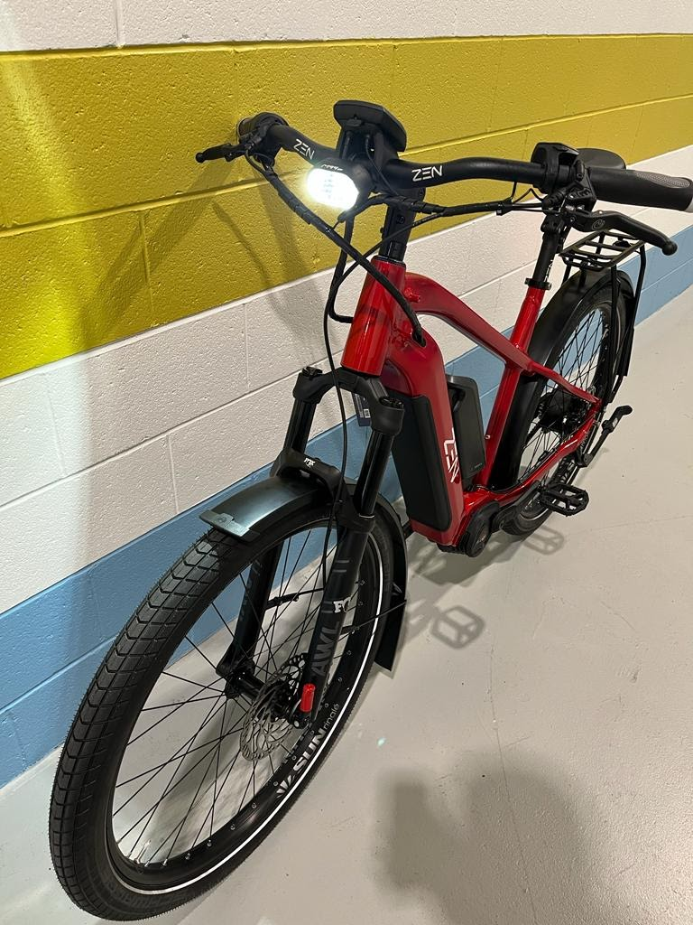

This particular bike is going to Tennessee. Fully loaded with Dual batteries, Kindernay VII hub, FOX fork, Kinekt seatpost and Supernova M99 lights.
