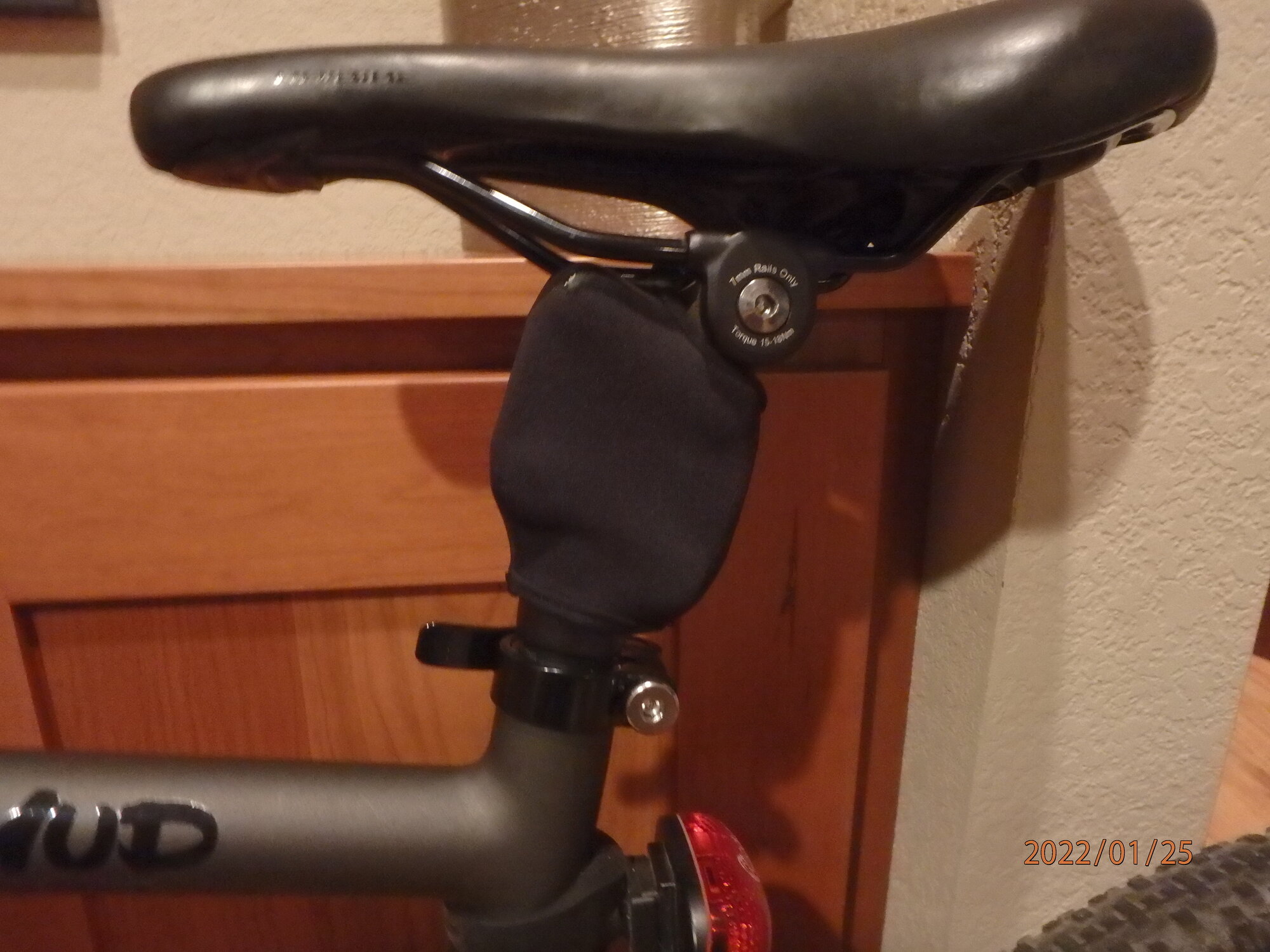

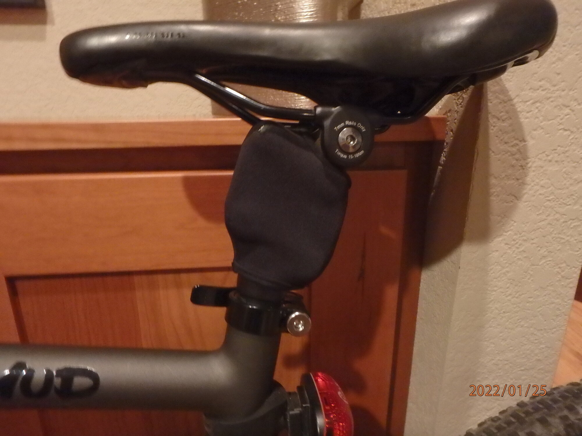

3. I put on my NCX suspension seat post I have with the Haibike seat. Barely fits (see attached). Don't know your height, but I'm 5'9" and ride with the seat pretty high. So you may want to check how much clearance you need/have. Riding on some fairly rough gravel yesterday, a suspension stem is a must in my opinion.

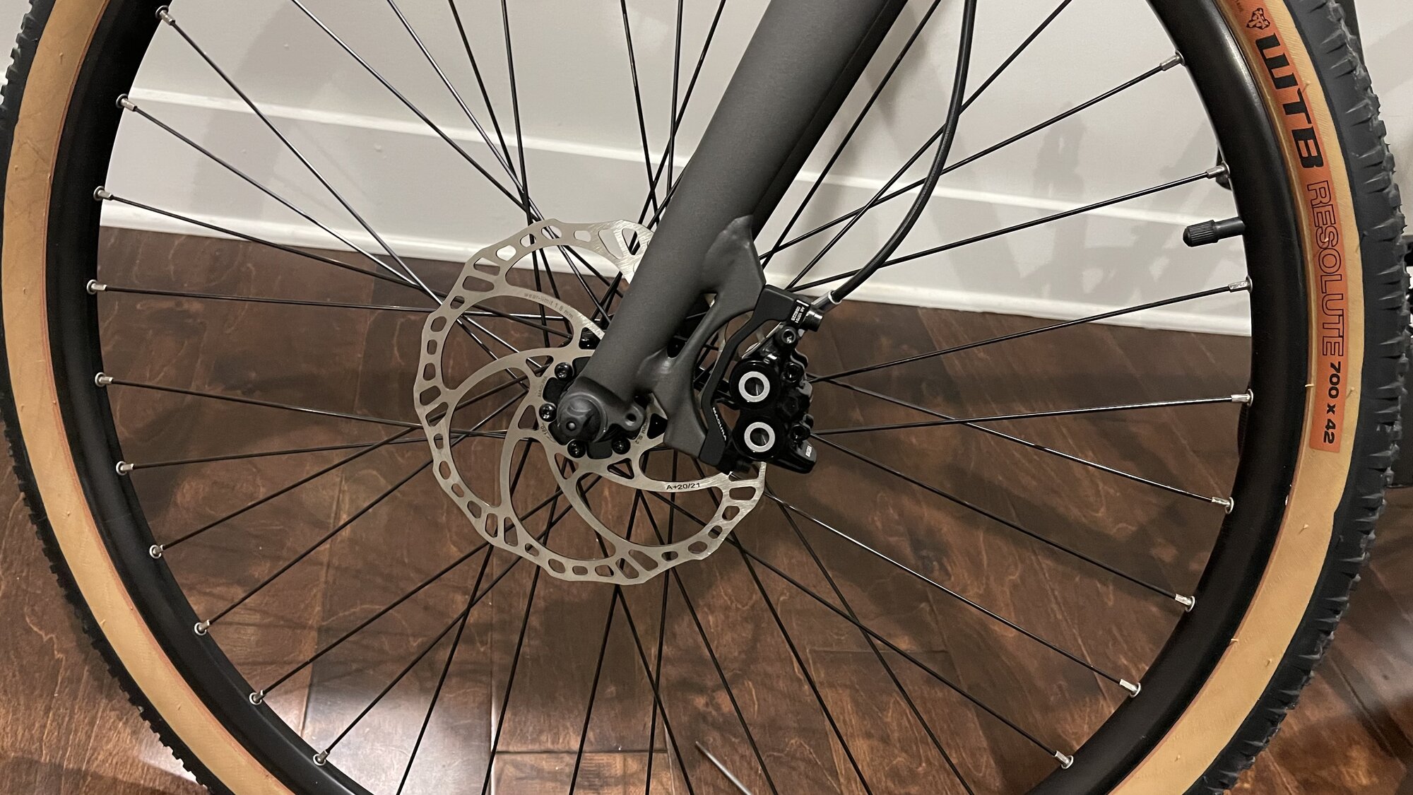

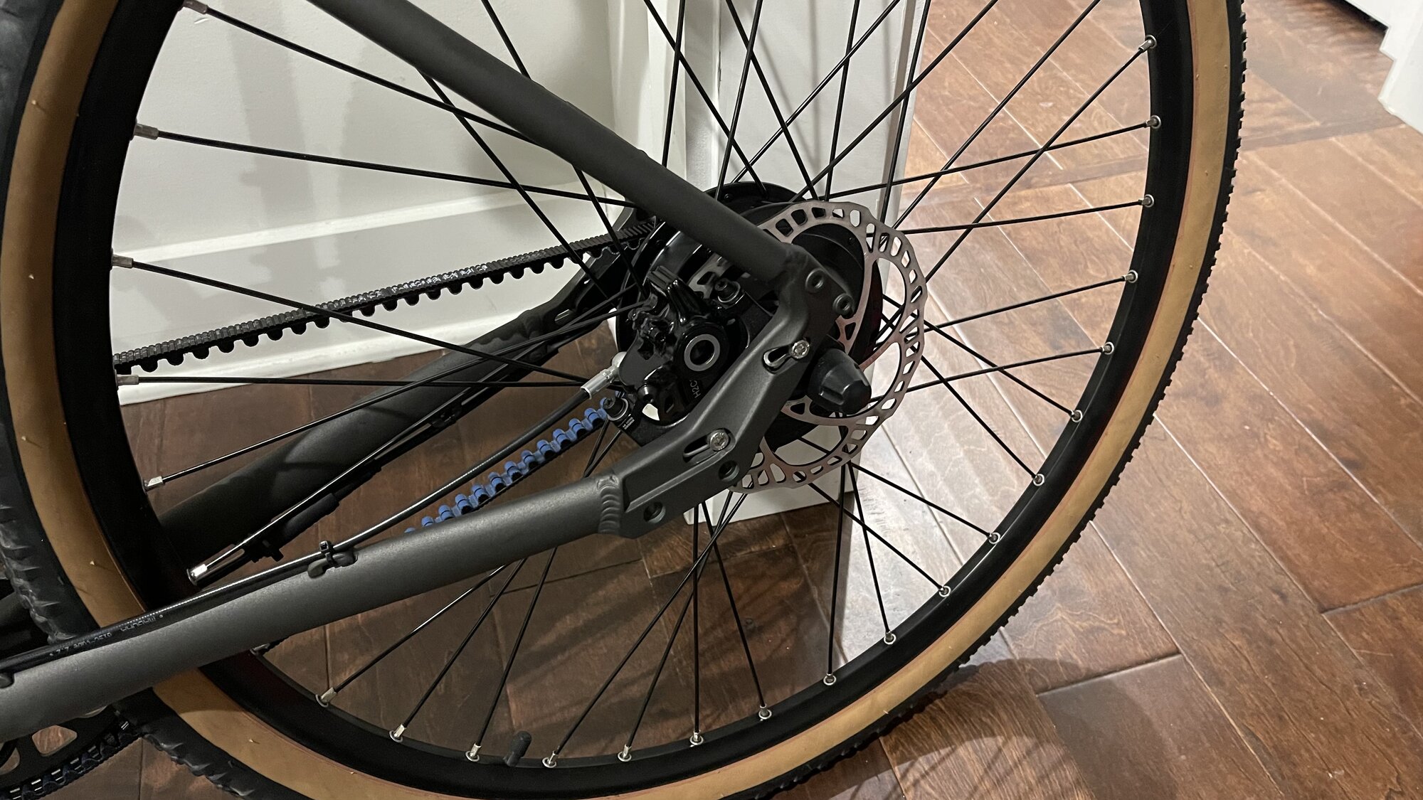

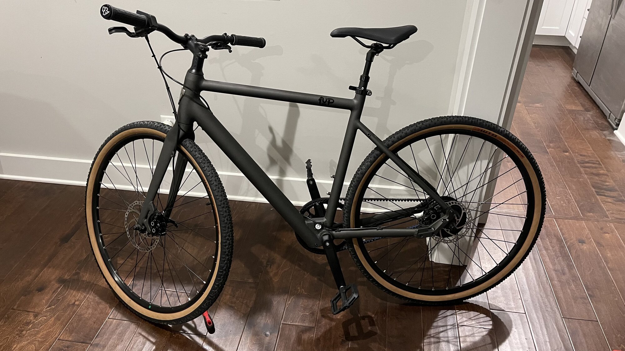

I ride my Gravel Edition in hilly Chattanooga and so far I have not had to push it up a hill. I also had to adjust the cone and true the front wheel and added Magura hydraulic disc brakes because I was not a huge fan of how the Tektro’s felt. Other than that great bike.
