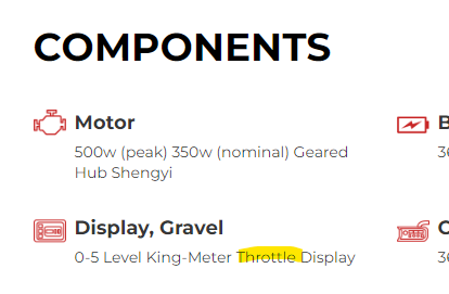

The new gen Gravel has a throttle. The non gravel I don't believe has that option basis looking at the components and from reviews. I also believe on the Gravel one can deactivate the throttle mode in the settings and may also be able to adjust the PAS assist level speed cut off. Additionally, in responses from them, you MAY be able to switch out the Gravel's King display by ordering the older display which has speed settings but no throttle. Supposedly this display works with the new gravel controller. But these would be questions to ask/confirm with Ride1Up's service group who respond pretty quickly.I am a bit confused here. It has a pedelec mode (which is what I am looking for) and a throttle mode (which I do not want!)?

Pretty sure the new ones come with throttle and all Roadsters are cadence. 99% sure on both itemsDoes anyone know if the current production models of the V2 Roadster gravel edition is a pedelec or does it have a throttle? If it’s a pedelec does it use a torque sensor or cadence sensor?
