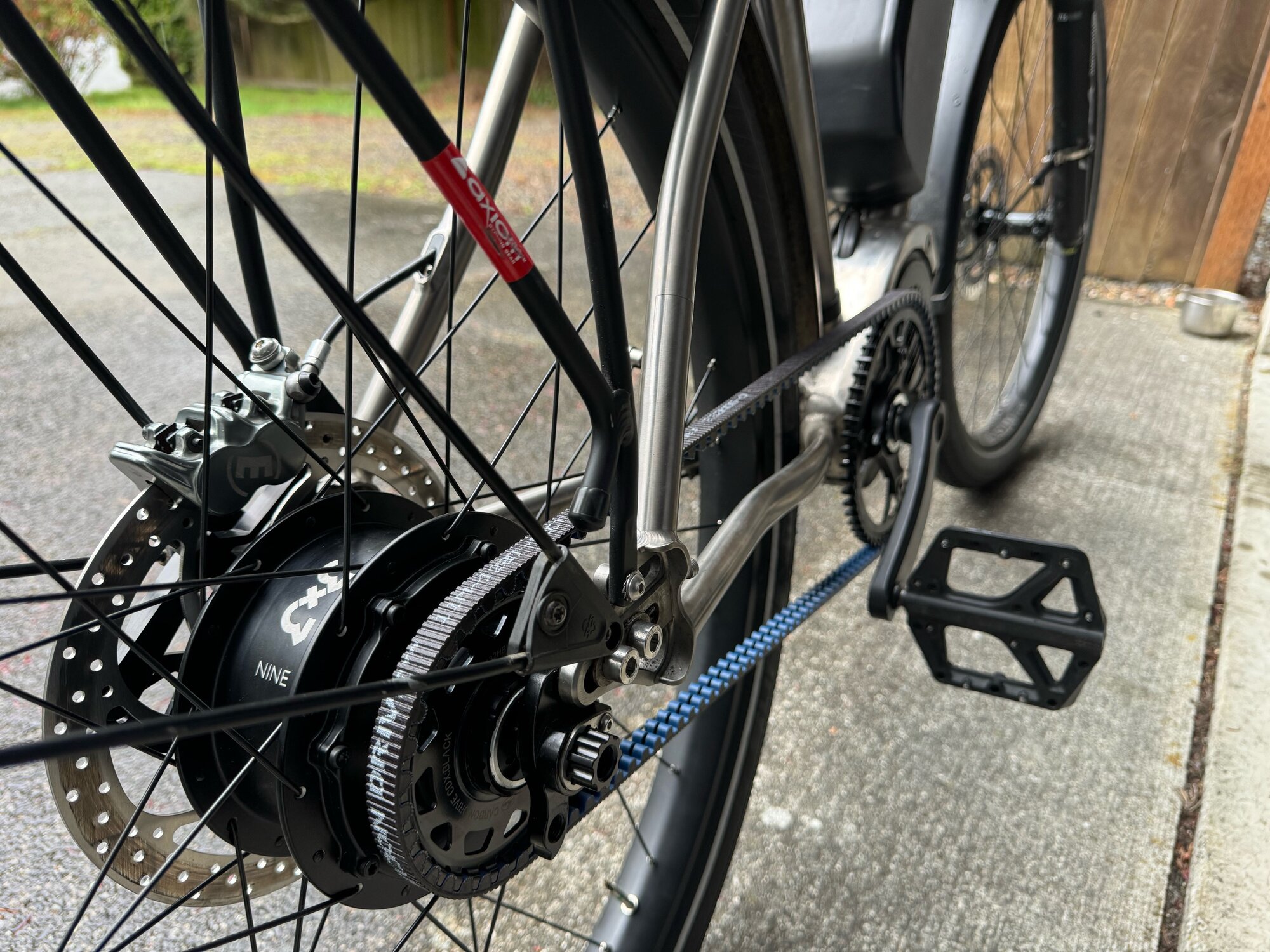

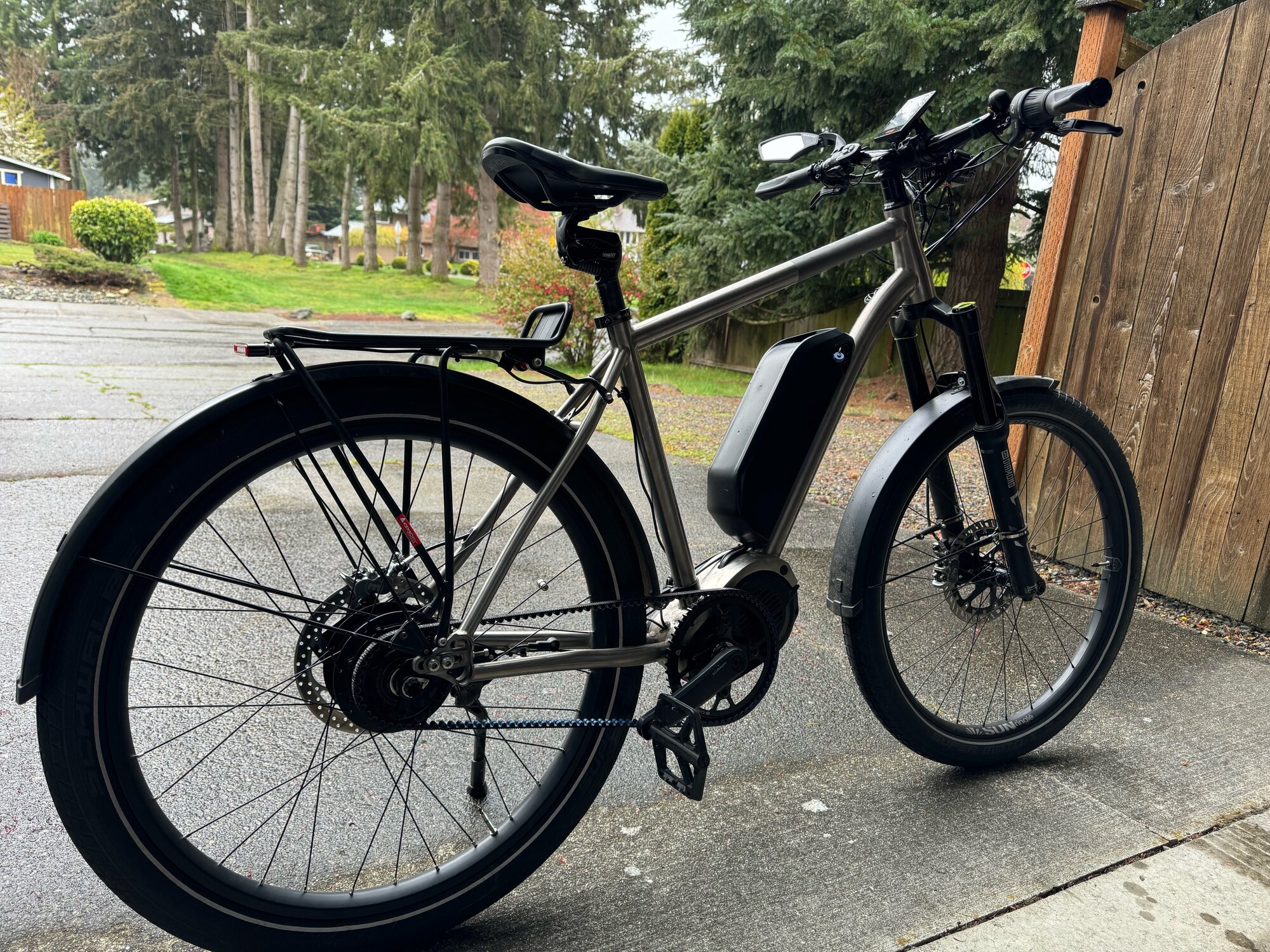

I have the 3x3 Nine on my Ebike, and I love it. The IGH shifts smooth, and at a stop. The 3x3 handles 250 nm of torque, and requires no maintenance. Add a Gates belt, and you have a drive train that finally handles the power of the Bafang Ultra. This is a game changer, and my dream bike has finally arrived.
That's great! Can you share more? Did you get this with bike? Or bought and retrofitted yourself? Where did you buy it from and how much it cost? With Kindernay our of business, this is probably next great 3rd-party hub out there, so I am really interested to learn more from real user!
It is mechanical on the photo. Electronic theoretically possible, but I didn't find any place where it being sold.
They have a two-button digital control as well. Haven't found it for sale either, but if it's some dumb price like a Rohloff I won't bother.

This UCpro was purchased from Wattwagons which is now out of business. It had a Kindernay IGH which failed after 350 miles, then tried a Revolute hub which did not work, then shipped back to me from Wattwagon with a derailleur system. I have been closely following the progress of the 3x3 nine IGH from Germany and contacted Vapor Propulsion Labs in Colorado when they got the contract to supply the hubs in the USA. VPL have people there that came from Gates, and other places experienced in Ebikes. I ordered all the parts from their website appropriate to the 3x3 Nine, and had a local bike shop do the build. It was an easy build according to the bike shop being a mid drive system, and they wanted some experience on the Gates belt. My goal for the past 4 years was to have a bike with the Bafang Ultra, Gates belt, and an IGH that could handle the torque. This journey has been expensive, frustrating, and close to be infuriating. If this hub fails, I would still support 3x3 nine for pushing the limits and supplying an IGH that will work with the need for high torque motors. There is an electric shift option, but they had not arrived at VPL at the time of my purchase. Electrification is the future, and cargo bikes will play a huge roll in accomplishing that. As a side note, my first Ebike was an EVG Lee Iacocca bike I purchased in 1999 as shown in my member picture. I have been an avid supporter of ebikes now for 25 years. https://vpl.bike/collections/3x3
