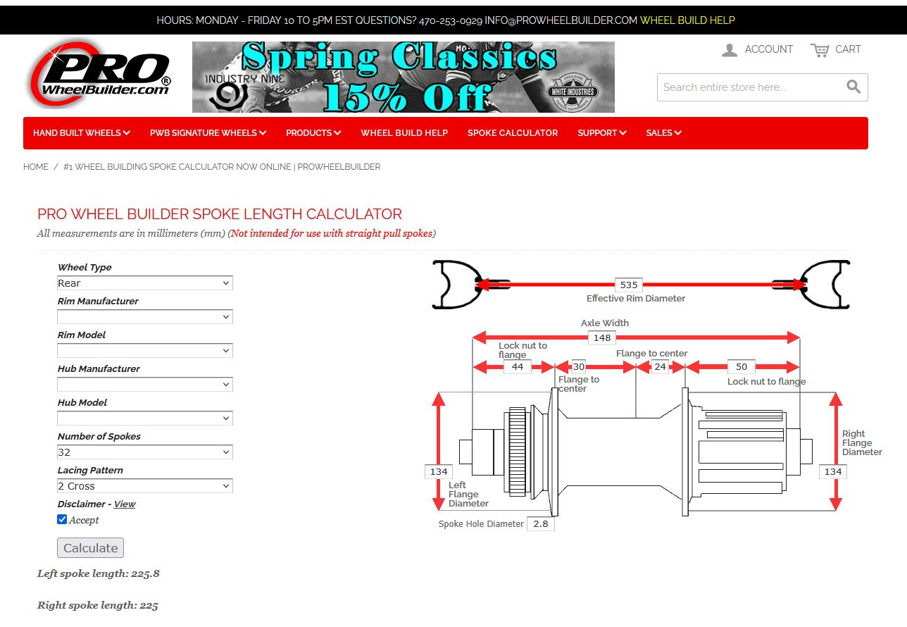

Where I can find the 32 spokes 12x148 mm through axle hub sizes to calculate the spokes length?

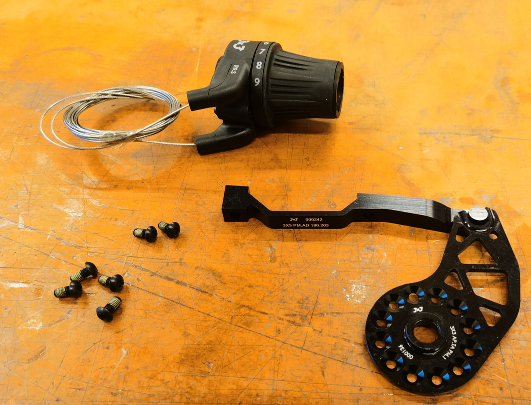

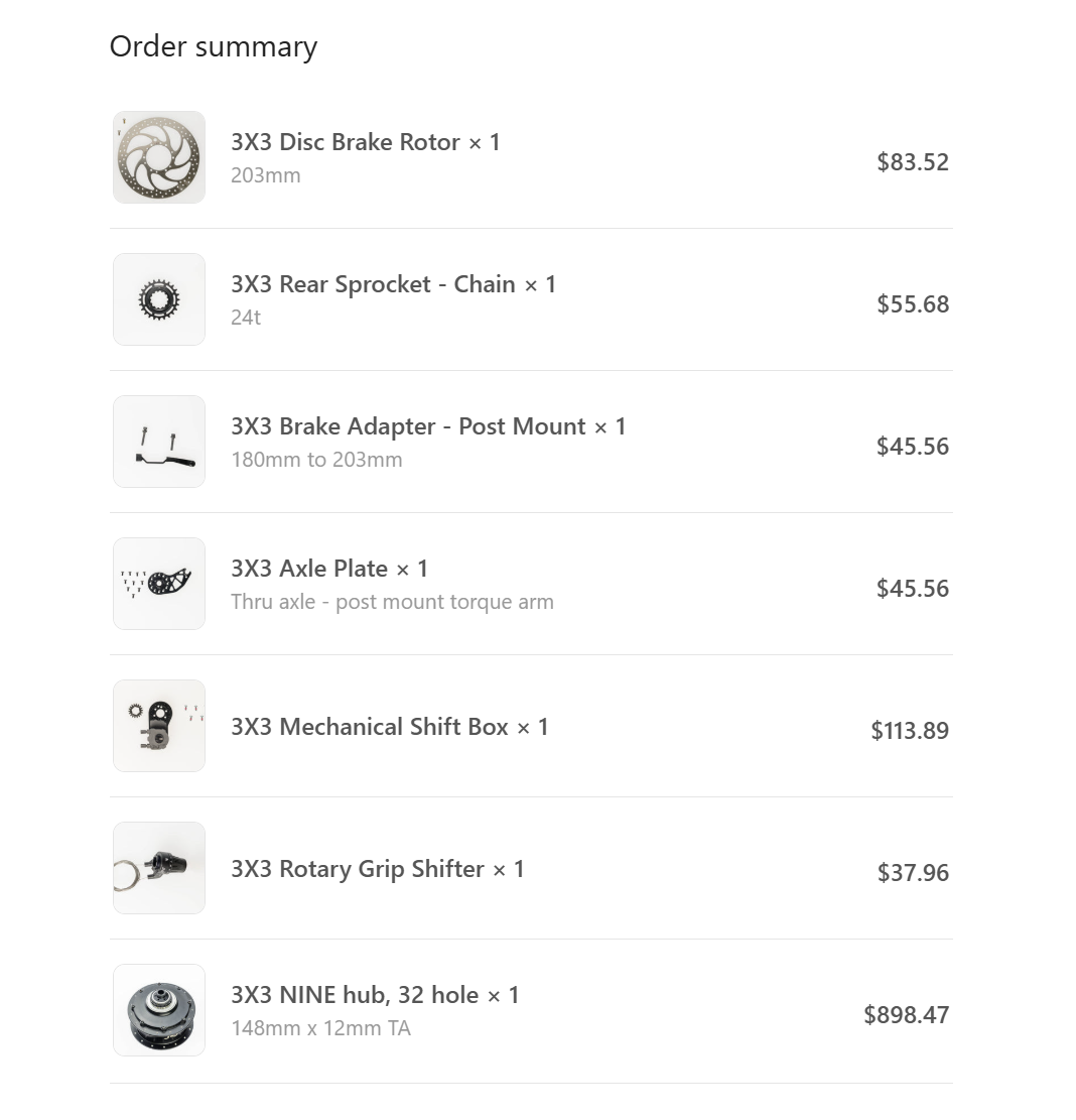

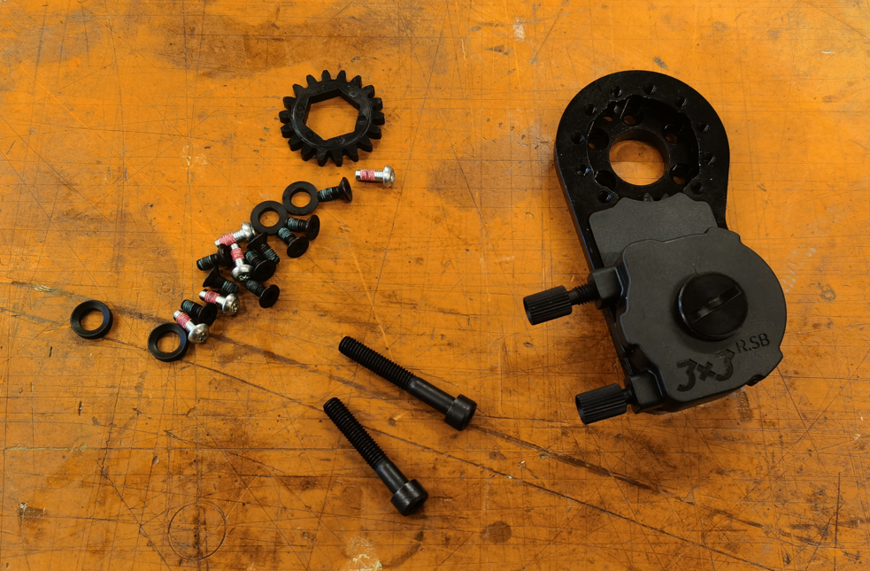

The 3x3 parts have arrived!

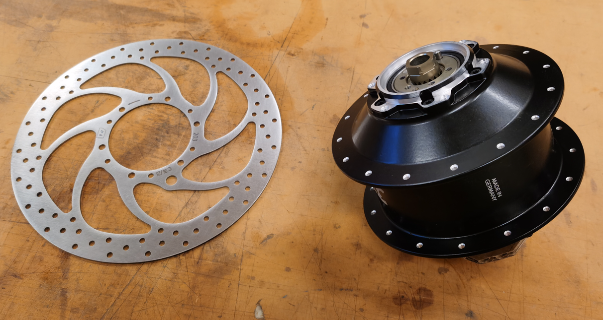

The parts look like very high quality product. The 3x3 hub has no free play between the case and the axles whatsoever (Kindernay gear hubs have some free play).
Unfortunately there is no chain tensioner in the kit and no tubes for the cables so this stuff should be figured out by the user.

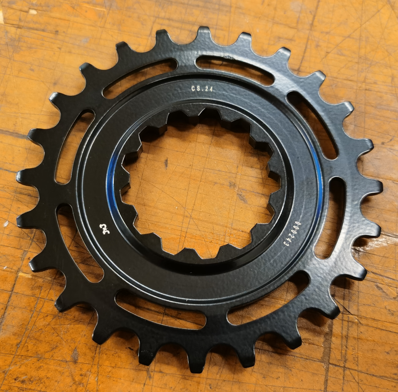

The cog is asymmetrical which means you can not flip it to extend service life.
This thing feels heavy (and I hope they used that weight smart and put material where it needs to be to make it stronger). It is also quite large comparing with Kindernay, it looks more like motor hub rather than gear hub.

Ordered some SAPIM STRONG J BEND BLACK SINGLE BUTTED 14|13G OR 2.0|2.4MM SPOKES for this hub
And some SAPIM POLYAX 14MM 14 GAUGE SILVER LOCKING BRASS NIPPLES
Here are the sizes for this hub for 148x12mm through axle option with 32 holes with 2cross pattern for NEXTIE Jungle Fox II 27.5" rim
