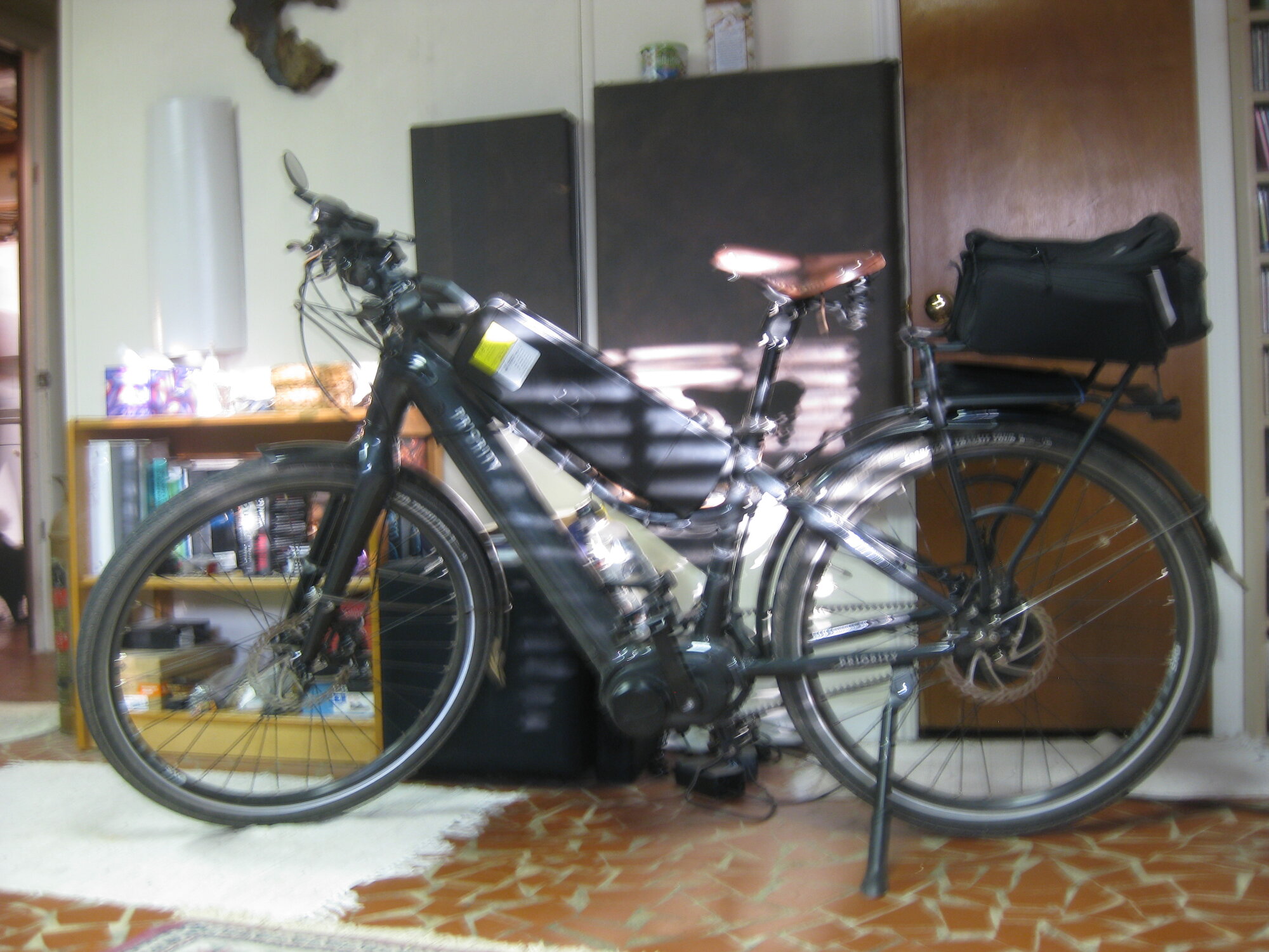

I bought a used Current/Envoilo a few months back and have about 1k miles so far. One has to love the torque of the Truckrum and how it's applied. I've ridden a road bike for years and still do, this bike is very natural feeling and has the torque to run mid-20's w/normal effort in PAS 2. 28 takes some work in PAS 3 but not hard in PAS 5. I put on an eesilk seatpost and Brooks Flyer saddle, the rear ride is wonderful but want to add a Kinekt suspension stem. (I have the Redshift on my Roubaix) I put the seatpost on first then found the Brooks latter, I think either would be good enough alone. I have the optional auxiliary battery & rack. But I've found the frame itself is weak in that it can wobble under the right conditions. It's worse with the Aux battery installed. I enjoy long rides so almost always carry both batteries. To lessen the wobble I moved the AUX battery to the topbar which has helped. I mostly ride trails and paths in PAS 1-2 on the flats and 3-4 on hills, 5 when I want a cheap thrill or am mixing w/traffic, 40 miles is not hard to get from the battery if you keep it leisurely.
Hmm...I've had no issue with wobble under any conditions, but I do notice the extra back weight of the auxiliary battery when it's attached. I'd still rather have it on for longer rides or the times I simply do not want to think about PAS/range. My PAS default is 2 on flat pavement, but 3 on dirt/gravel paths and trails where I do the majority of my riding. My Current has the Shimano.
BTW, I offered to sell a buddy's Current for him (he has physical issues). He thinks it's easier for me in my rural community than it is for him in big city suburbia. Does anyone here have a depreciation formula for this kind of e-bike? 400 miles. Shimano shifter, if that matters for pricing, and perfect condition.
I'd say 55%-70% of new, depending on year. I tested mine with 10 miles on it for a lower than expected price. I'd never heard of Priority so after a test ride I researched more and went back to buy ride it again then struck a deal.
Try swiftly shaking your handlebars L&R while riding, see if the wobble continues for a moment? That's how I've found I can induce it but when it happens it takes you by surprise. Maybe I'm a strong rider but I often find noticeable flex. I also have my riding position trending towards my road bike and I use MTN shoes/clips. But all-in-all, it's a fun, fast bike.
