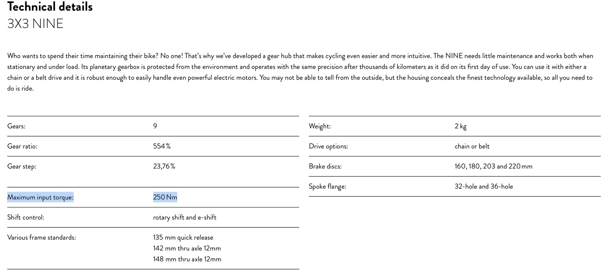

An established German manufacturer since 1903 is now making an internally geared hub with a wide range, fewer gear (nine) that can handle up to 250 Newton Meters of torque. It will be available first on OEM bike with Nicolai currently offering bikes with the new hub. It will eventually be available after market. The hub is grease packed rather than oil bath making it maintenance free for life. It is available with either a twist shift cable shifter or a wireless electronic shifter. At 2 Kilograms it is heavier than most but again so robust that it can handle almost twice the torque.
Maximum input torque: 250 Nm

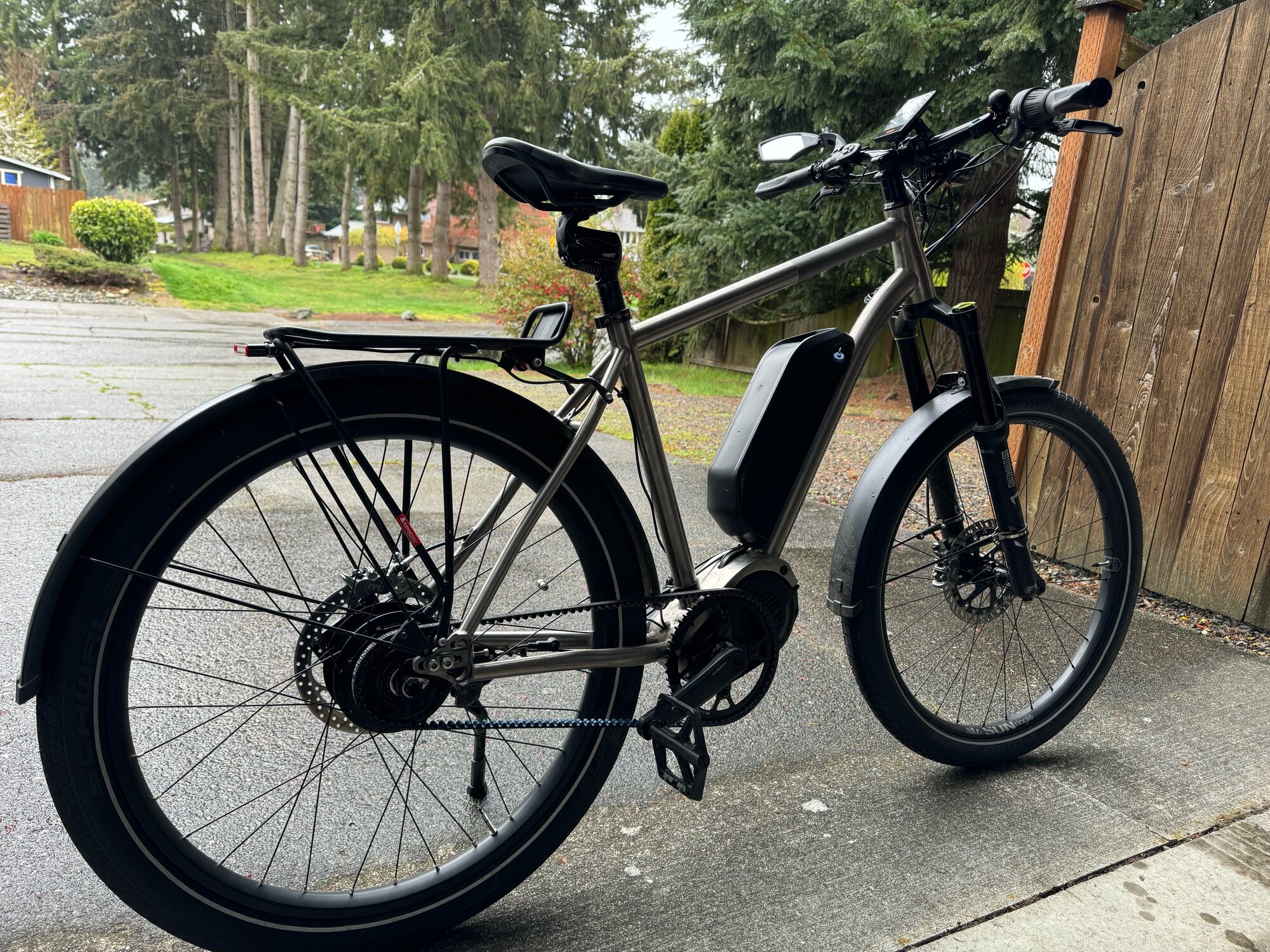

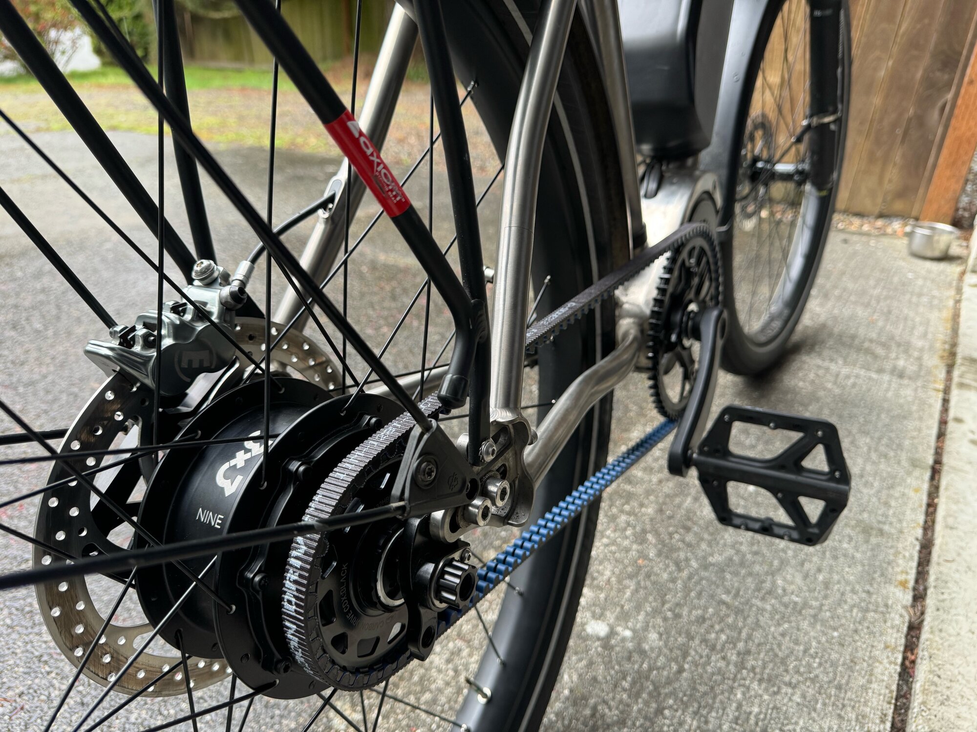

I have the 3x3 Nine with a gates belt and the Bafang Ultra. The IGH shifts smooth and at a stop. No maintenance is a plus even if it is greased instead of oiled. The first three gears will lift the front off the ground in the lowest power setting, and reach over 28mph in high gear at 60 cadence with a 42T front sprocket. I can take any hill in my area at power level 3 in the middle gears. This IGH is a total game changer, and with the Gates belt I believe I have a bike that will easily get many thousands of miles of use with no maintenance.

Also I believe you might be exceeding the torque rating on the 3x3 with a belt drive ratio with nearly same size front and rear sprockets. I'm just wondering if you think the life could be impacted if the torque limit is exceeded because Rohloff has a table defining what the final drive ratios should be to avoid damaging the IGH.
