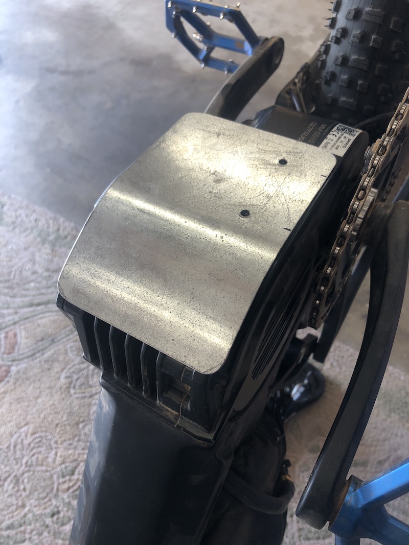

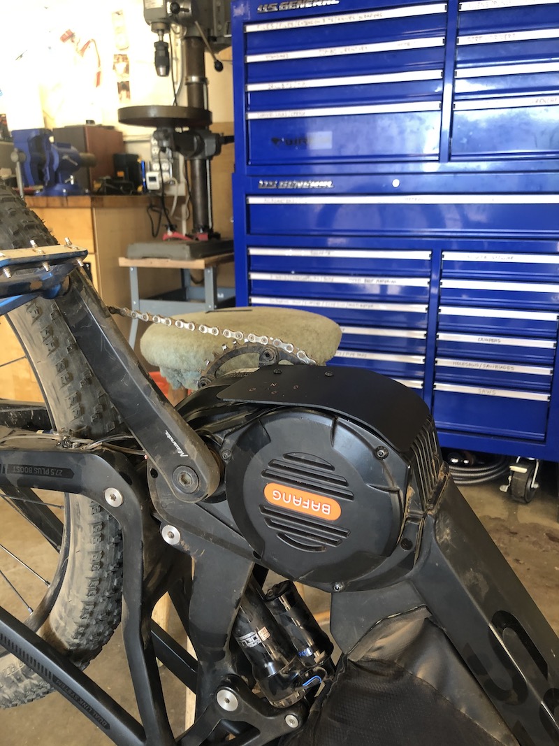

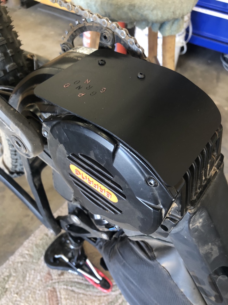

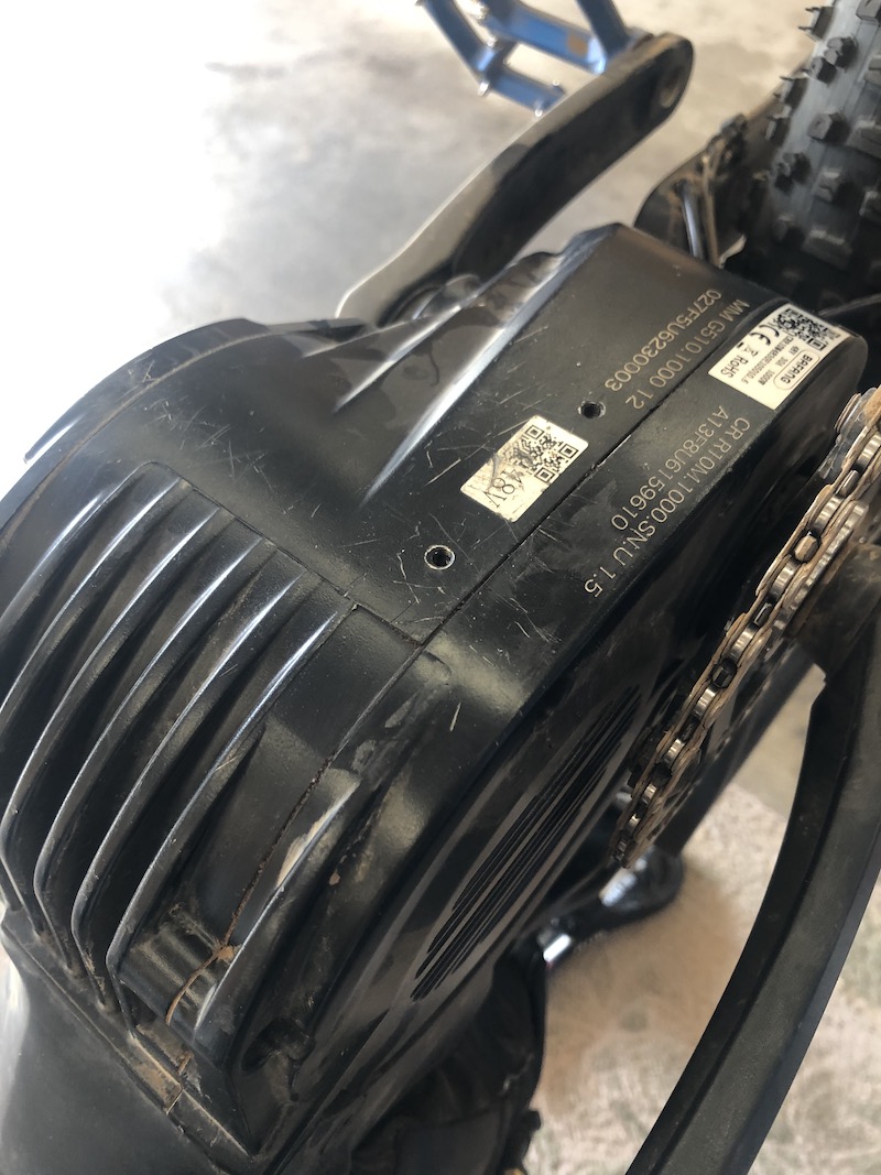

RTP a couple of things on your comments. All good not to worry. You brought up bash guards I made these from some 1/8" steel that I had laying around, took about an hour. Has zero effect on cooling of the motor and has saved scraping the motor on numerous occasions.

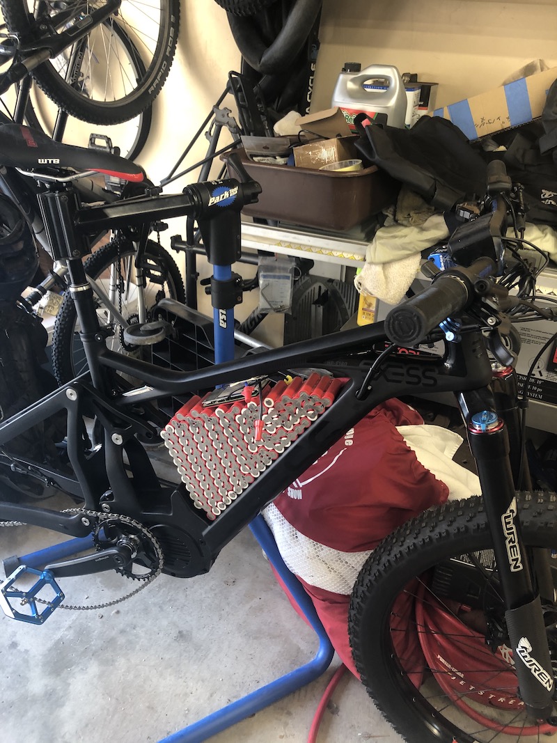

As far as making your own battery's are concerned there is a company out of the UK called "K-Weld" that makes spot-welders that is good quality and fairly reasonably priced. Been making mine and friends battery's for a couple of years now and no sad tales to tell. Using 18650 Sanyo cells and pretty happy with the results. 21700 cells are good also but $ to watt cost is still better with the smaller size unless your doing a bulk buy.

Those huge packs of butted up cells scare me. I'd be certain to have temperature monitoring of the pack.
I'm curious what a bash guard does when it is mounted to the motor? You'll still transfer all the forces to the motor case and will likely crack the case as easily as not having a guard. Ideally the guard would mount to the frame and isolate all the force away from the motor housing. Those tiny bolts will shear off pretty quickly threaded into an alloy case.

Having ridden TSDZ2 bikes for the last 4 years I have become very sensitive to bashes....but if you have a BBSHD bike you know what I mean. I like the idea that greeno had but I mostly just have half rotted logs to deal with anymore here.
Was kind of thinking the same, but worst case - re-read your last sentence. If it takes a strong hit and shears, well - sacrificial bolts > cracking motor casing, no?
There are literally wires stuck out the front of the BBSHD, so all kinds of 'fun' can happen there, although it at least does have a frame with some protection. Some.. It's been on my list since seeing it, but TBD on if I get to it or sell it first. ;)
