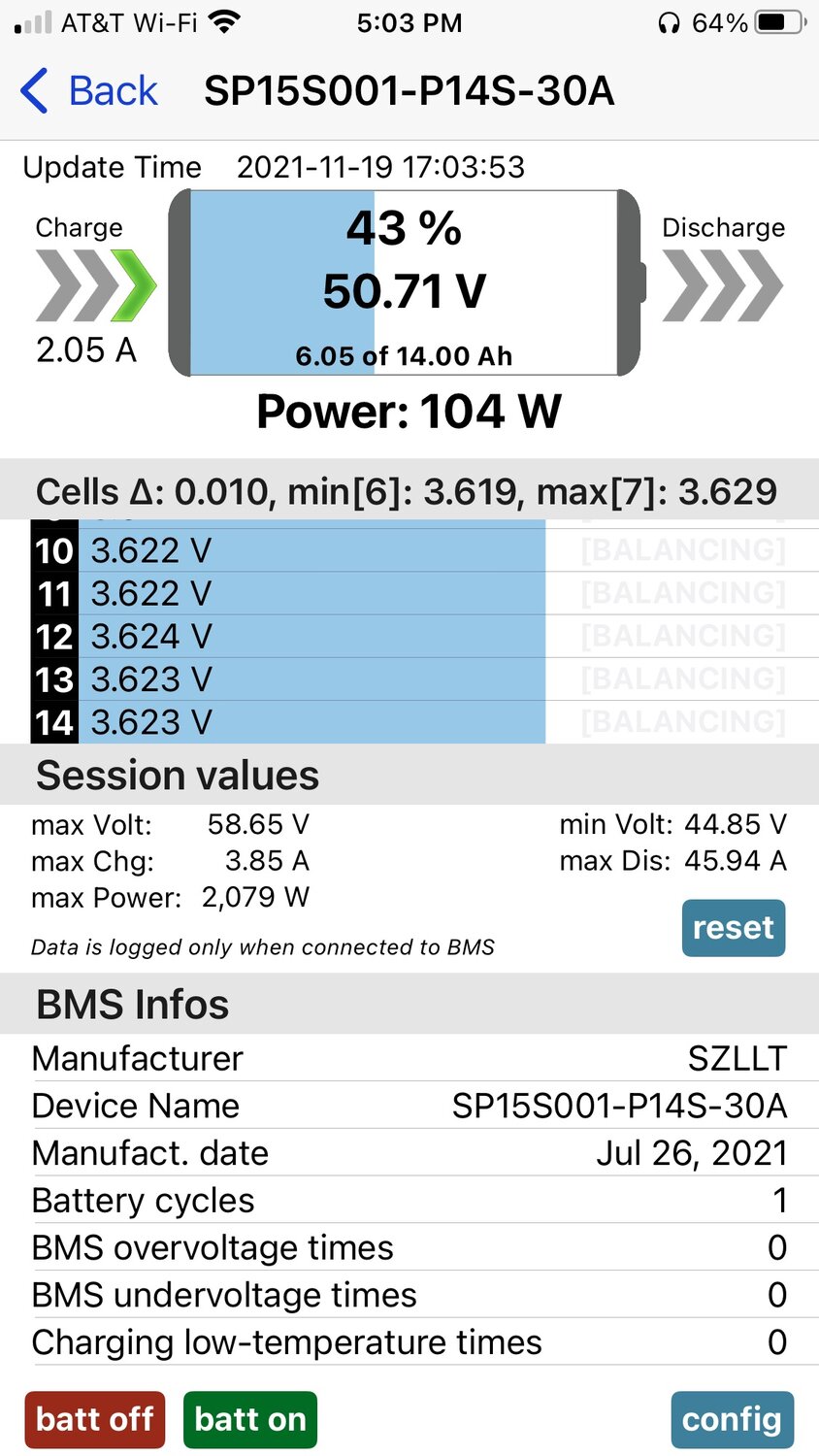

@bexamous - the manual and YouTube videos for the DP C18.uart state it currently doesn’t use that battery data. If interested in battery, get the XiaoXiangBMS app. Here is what it looks like…
The manual also says to use the Voltage setting over percentage. I agree and have the 14s charts committed to memory (turn back point is 48V)….
-BB

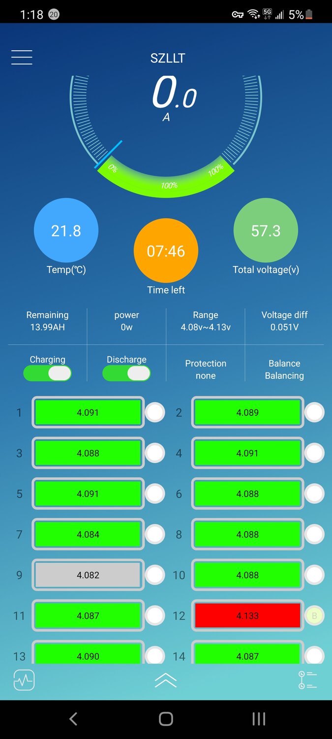

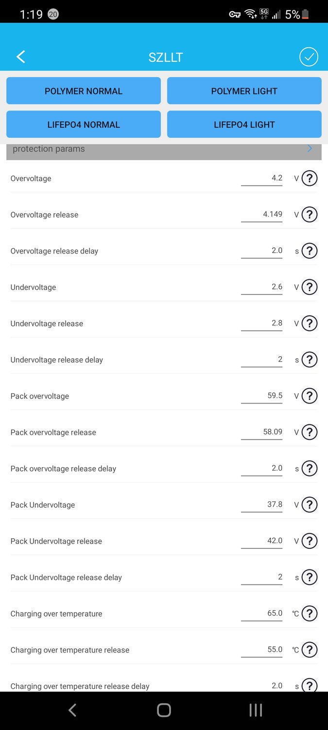

But now I'm more confused why bike turned off when display was reading 15% and pack voltage measured 48.6v. 48.6/14=3.47v which made me think LVC was at 3.5v/cell. But using BMS app that is not the case. Doesn't seem to be any reason for it to have turned off when pack was only at 48.6v.
Charging now though I am seeing 13 cells are all ~4.102+-0.003 and 1 cell hits 4.200 and charging stops. They then all drop a little when charging stops, screenshot is after sitting for a minute or two. From past experience with RC lipos this is what a bad cell usually looks like.. it'll have higher IR and reads high under charging and sags a ton when discharging. I'll try to run pack down again today and see what individual cell voltages are when pack is at 48.6v. Hopefully that one cell isn't falling to 3.0v way early.

Check your cell voltages when it shuts off and see if the high cell during charging is also the low cell during discharge. I've had bad cells appear after many discharge cycles and that's how they behave. Your pack appears to be fairly new.

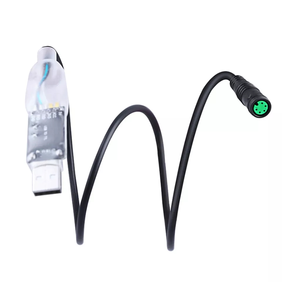

Could someone post a picture of the programming cable? I ordered the Hydra and did not see one in the box.

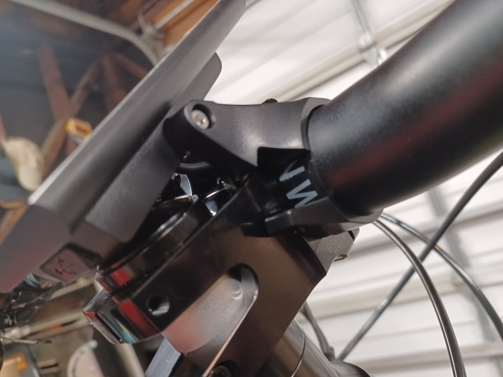

Also, the display clamp seems to small for the handle bar. No screws to secure it either. Pretty sure they wouldn't reach anyways. Does that seem correct?
Not sure if you paid for the cable or not, but it should look like this. Based on my experience and reports from others, they just decided not to send them. Amit committed to shipping a new cable in 2-3 weeks 3 months ago, with silence since.
Incompatible and missing parts are no surprise unfortunately, but the display clamp and screws were appropriate in my case (though one of the screws was floating around in the bottom of the shipping box, so maybe check that.)

My Hydra did not have any screws for the display clamp. While you can move it without screws, it is secure without them.
Strange - as far as I know, the cable is useless without the software (that they charge for).
The cable and software is listed as an upgrade for the Hydra Black. They are standard for the Hydra as far as their website goes. I got a reply and the cables is on back order.
I got a similar update - it seems a year's notice is nowhere near enough for them to send a cable I could have delivered from Amazon or ebay (to Australia) in a week or two, or from Aliexpress more slowly (but cheaply). The utter ineptitude here is baffling.
