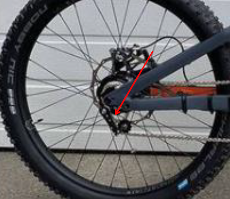

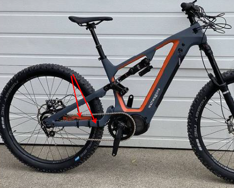

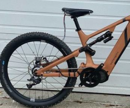

Hello J10001, I'm very close to make decision to buy Hydra, thank you for detail information and photo. I'm thinking to buy with Kindernay gearing option. I asked WW to send me few photos to see how it looks with this option, but they tell me to look at their Instagram website, I found next:
From those photos seems that Kindernay cables for oil fluid are not inside frame (first photo)? And why is derailleur there (second photo) if there is Kindernay than it shouldn’t be derailleur? On third photo it looks even bigger?? To be honest on those photos straps and derailleur not looks nice.
Can you please send few photos how it looks on your Hydra? I hope WW have better solution to hide or fix cables for Kindernay.

Correct, it is a tensioner and is needed on a full suspension bike.

Thank you guys! Now I see this "derailleur" actually tensioner for sure must be because of rear suspension, but question is can WW hide cables, or those thick straps need to be as on photos on my first post.

Those cables are too thick to be routed internally. If they could hide them they would.

Cables are not too thick to be routed internally, but need a bit of slack at the end to make removing the wheel easy, and must have slack somewhere to accommodate the full suspension travel. And there are two of them..
I am not sure if the hydra has holes in the swingarm and or if they could accommodate the above.
@pushkar may be able to comment.
If not, I think they could be passed more discretely using stick on little clips that could go just above the arm or even behind if there is space.

Kindernay has 2 shifter cables, and not are on the drive side. The current frame has routing for one traditional shifter cable only. We are working on a longer term solution for kindernay routing on future bikes.
That being said, Kindernay (like rohloff) has mentioned that having them outside is recommended. We have a good routing solution for future bikes but it will be hard to change the current Hydra rear triangle.

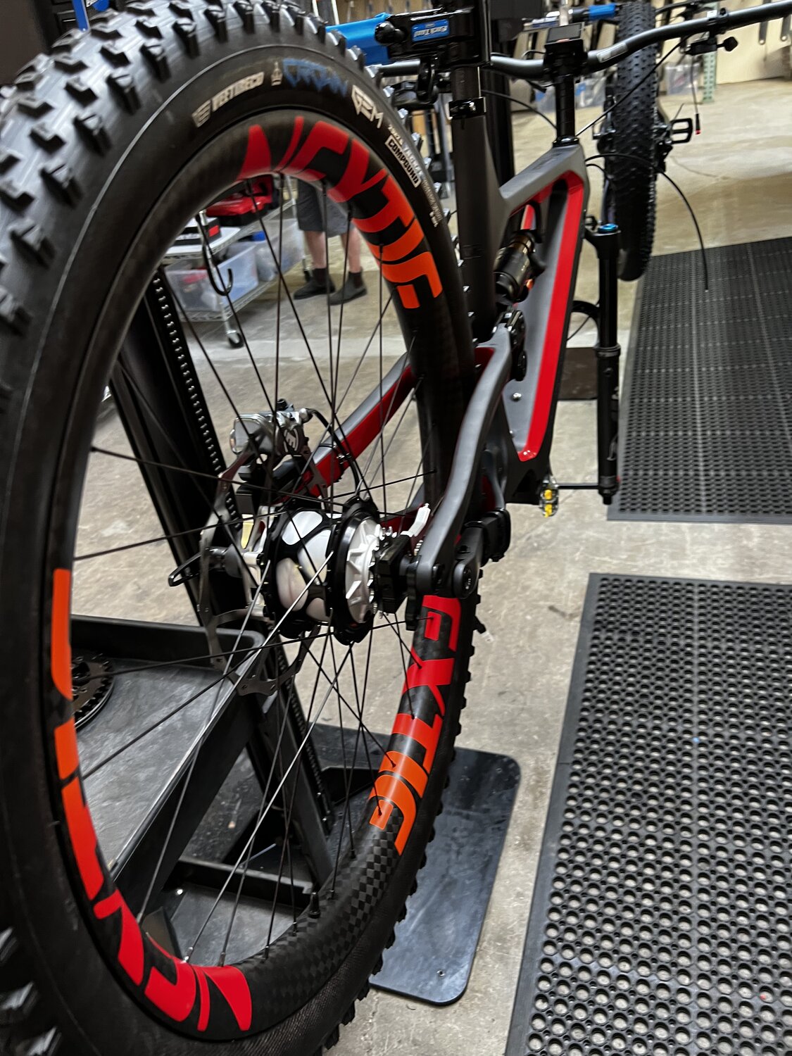

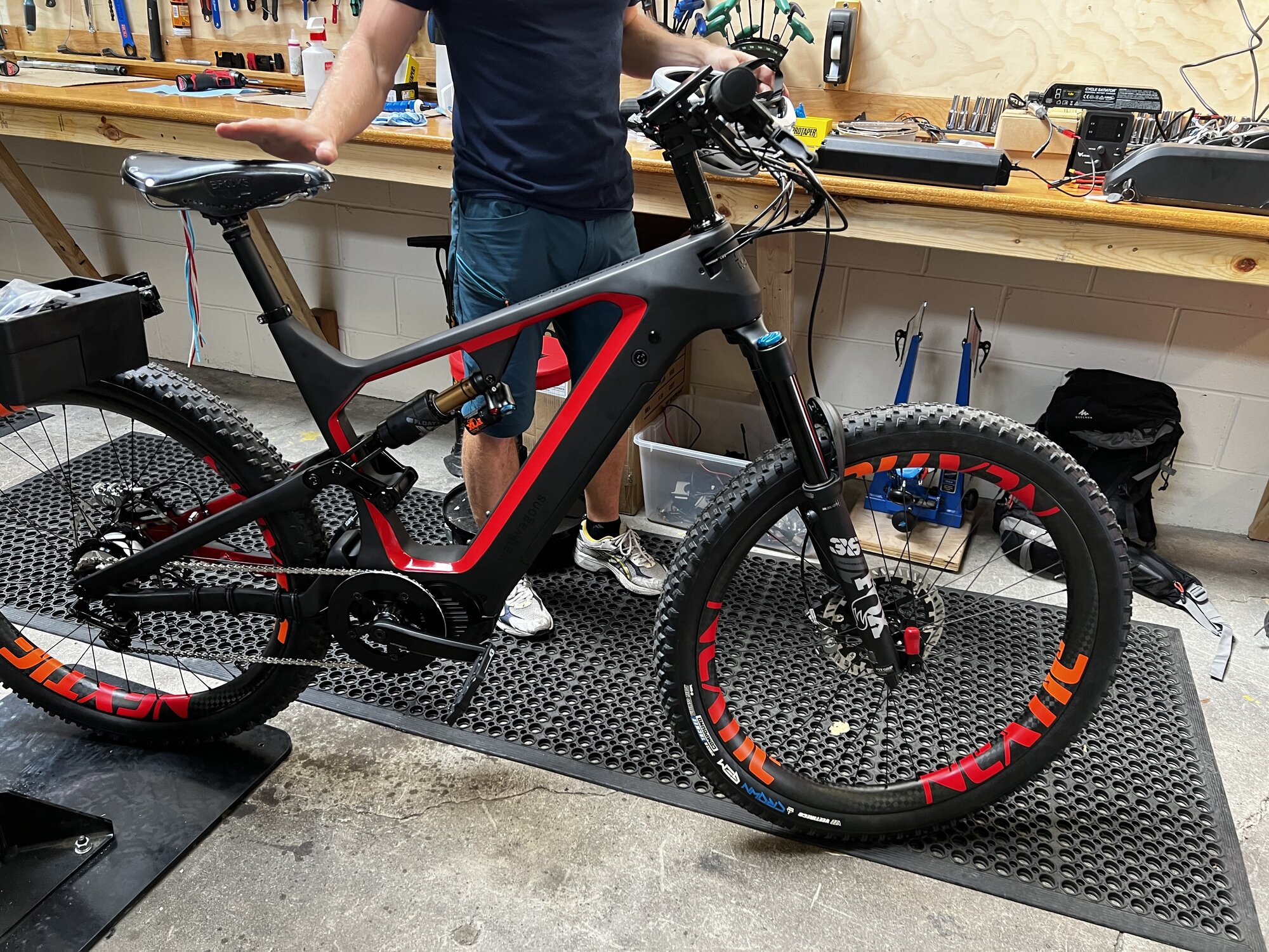

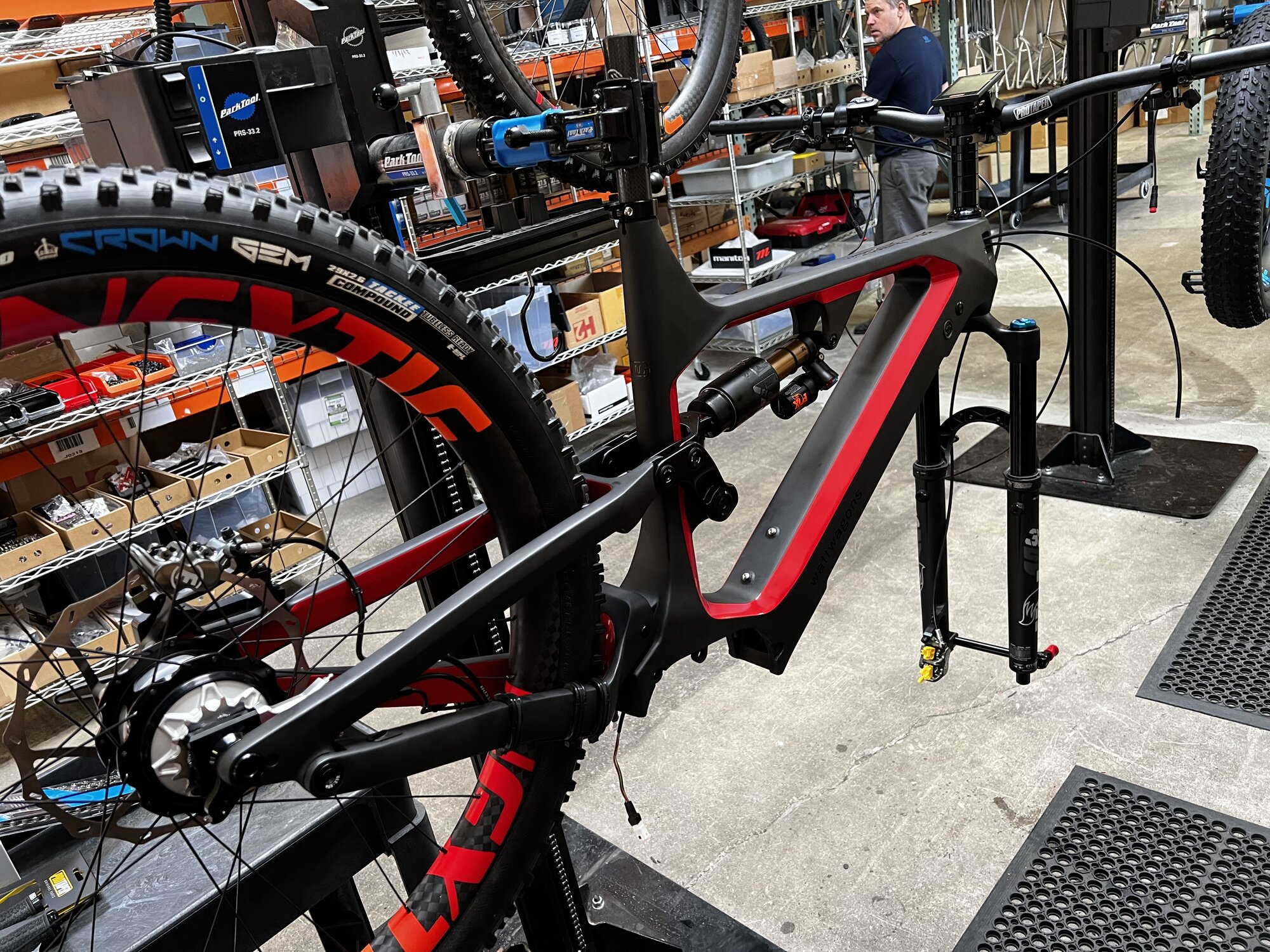

Hello All- long time no write. Does anyone recognize the photos below? Given that the weather girl announced that Northern California can expect a series of fire ending rain storms, I know what @pushkar said is real. Due to ship soon. Stay tuned!!
-BB
Answer: Look at pseudo-photo on post #1…..
Saw the pseudo photo on post one but still don't know for sure - is that your bike? Lucky Dog. Can't wait to get to my computer and look at all more closely.
That bike and Cuz Vinny's should definitely have great photos posted at WW Central to show the high end of what is possible. (Set the mark to try and beat.)
it’s transit to think how dirty it’s going to be the first time you take it out on a trail but it sure is beautiful now. I love those wheels
