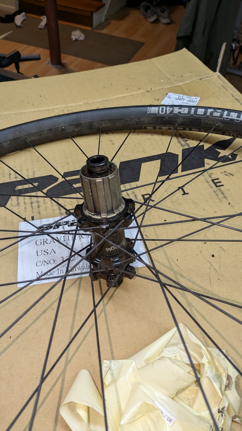

Just an FYI post for those who purchased a WW bike, in my case a Hydra, with Sunringle 27.5 Duroc 40 wheels. I parted my bike out and kept the wheels for future use. I’m going to be using them on a new build and when I inspected them the HG driver had noticeable wear gouges from the cassette slipping due to the power of the motor. No worries though because you can get steel drivers in either HG or XD from Sunringle.

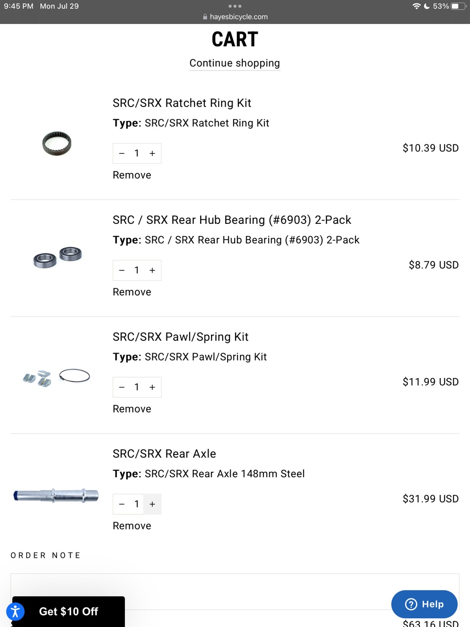

In addition Sunringle has a steel 148mm spacing axle. I’m rebuilding my Sunringle SRX rear hub with a steel XD driver so I can run a SRAM GX cassette and the steel 148mm axle. I also got the ratchet and pawl plus new bearings. The hub will be like new again and a lot stronger than before. Total cost is about $150.00 in parts.

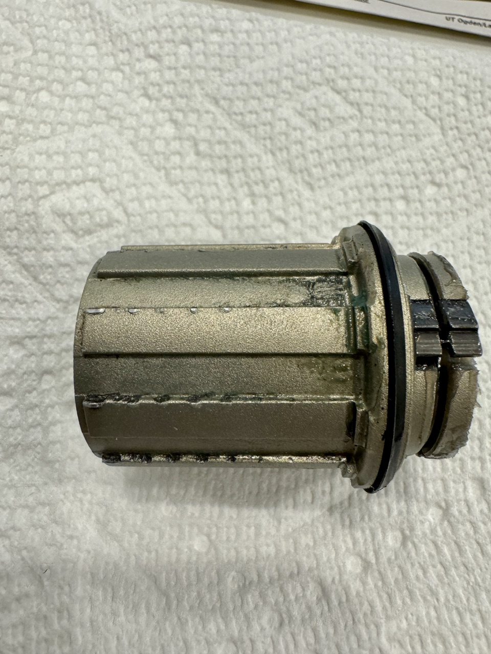

Here's my freehub after 4500 miles. I'm guessing this is steel? Now that WW closed up their Newton shop, I'm on my own for maintenance and repairs and I just destroyed my third rear wheel (see the cracked rim that goes under the decal). Ordered a Spank 359 wheel and came with alloy freehub - going to order the ebike one now that I know I ordered the right hub spacing.

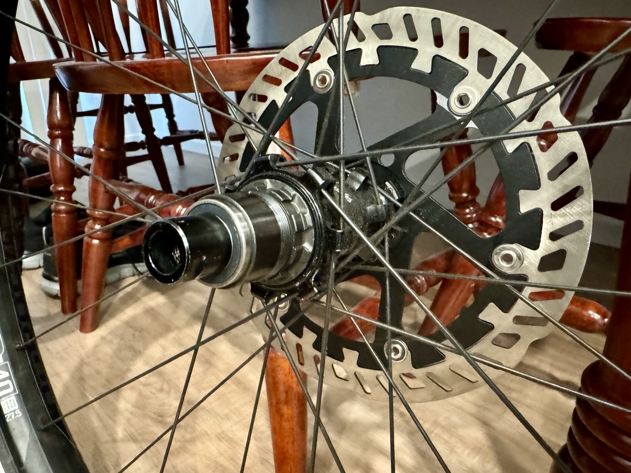

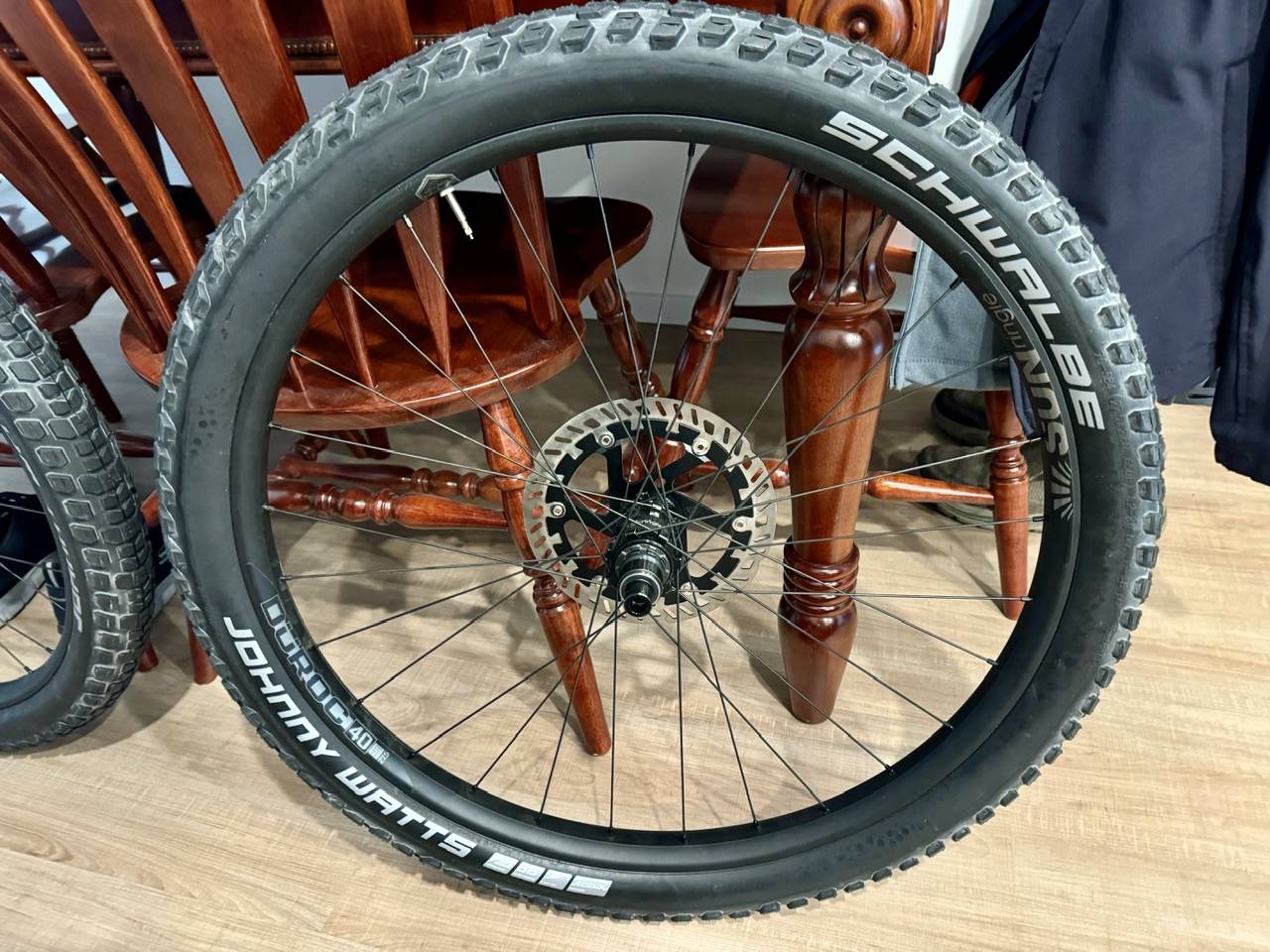

I'm up and running again with the Spank wheel. Took some liquid soap and some extra pressure to get it to get a new Johnny Watts to seat correctly. The narrower rim makes it look small and the front looks fatter than the rear now but it's functional. Since I destroy so many wheels I'm going to learn to build them too. Duroc SD42 rim is on the way, hopefully I can use the same spokes. If it works out, the Spank can be my spare.
Unless your hubs have the same exact dims you will need shorter or longer spokes.
Some shops have the ability to cut them shorter for you ( for a fee ) and make them usable.
Most nipples are reusable as well just add a bit of oil to the threads of the spokes when assembling.
