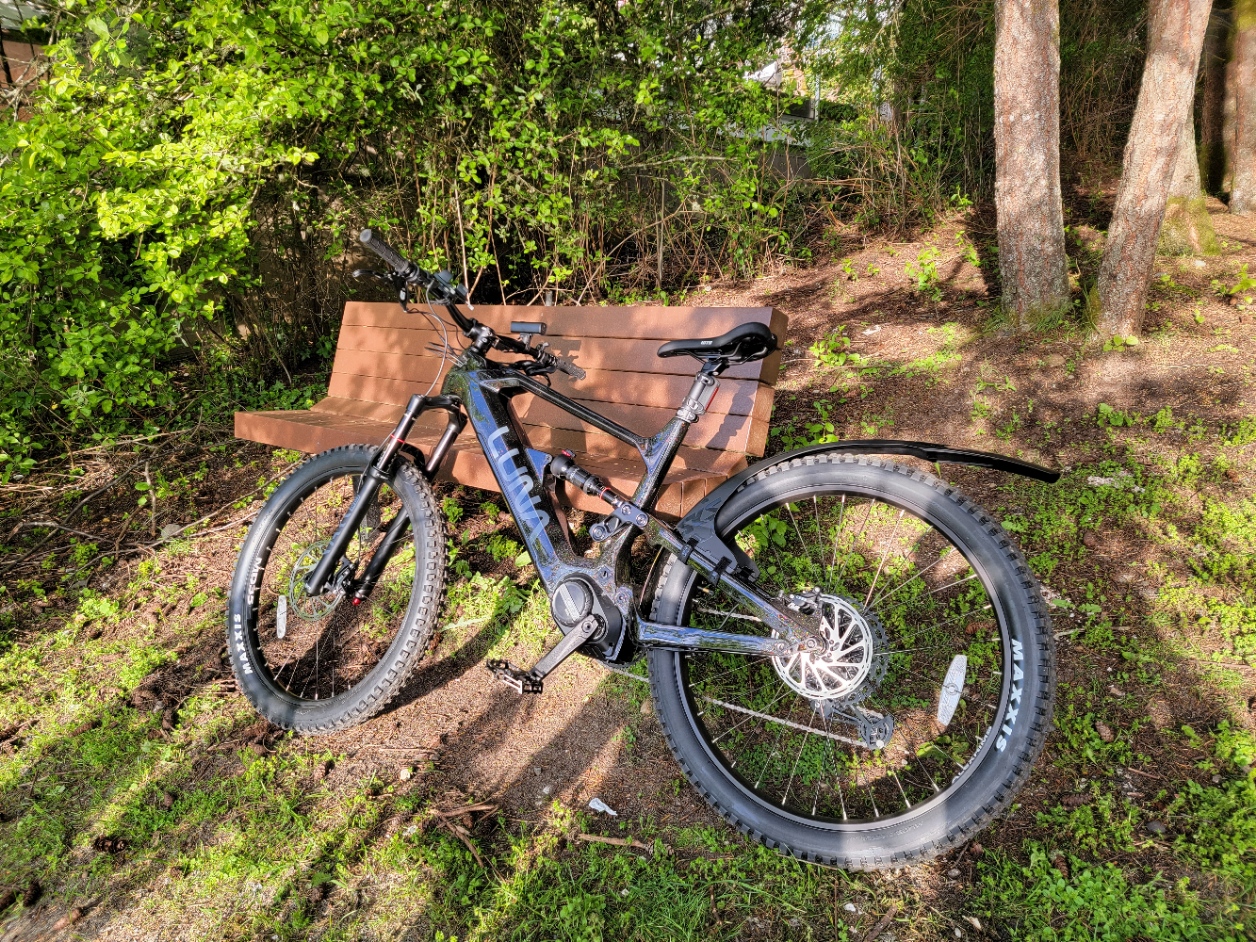

Friend of mine just bought a Luna X2 with the Bafang M600 motor and Rockshox suspension. It was on sale for $4,200, shipped quickly, and arrived within a week.
Same angle direct comparison to my Hydra:
As you can see, the Dengfu E10 frame geometry for the M600 build is slightly different than the M620 geometry. The downtube is at a shallower angle and the shock mounts to the downtube instead of the top tube. It looks like the seatpost position is moved slightly forward with a shorter top tube.
Some thoughts after a few short hours of comparison:
  • The Sram SX Eagle 12 speed shifter they fitted to the X2 is really bad. It jammed twice when just trying to test out running through the gears. The upshift lever is also reversed from how Shimano does it which is an ergonomic nightmare... it's really hard to find a position on the handlebars where hitting that thing is easy. The actuation force was too high for shifting down to larger gears, and it just didn't feel very good. It came with a 38T chainring and 11-51T cassette.
  • The Rockshox Yari fork and Deluxe Select+ shock seem okay, haven't ridden it on trails to see how they feel. The shock is much shorter on the X2 than on my Hydra.
  • The KS branded dropper post isn't great, the lever is a weird shape, requires too much effort, and the travel is like half that of the Crankbrothers one on my Hydra. For some reason when adjusting the fixed position height, it started acting weird and slowly letting the seat down.
  • I don't like the Sram hydraulic disc brakes. They don't bite very hard and one of the rotors arrived warped so that'll need to be fixed at a shop. The lever action feels good at least.
  • The Bafang M600 is QUIET! Luna fits a custom PEEK gear into the M600 and you can literally barely hear it. Very jealous of that. This motor is the main reason I'd consider a bike like this.
  • My friend ordered the stock motor controller instead of Luna's ludicrous controller, but the stock controller is okay. The torque sensor isn't as good/sensitive as the Hydra's and obviously it's not super powerful in comparison to the M620 with Archon X1. In my 500 watt assist level my bike felt faster than in max assist on the X2. I think it's tuned to class 3 from the factory.
  • The wiring harness for the M600 has higher quality connectors than the M620 ones, and you can unplug the harness directly from the display. I wish Bafang would update this for the M620. The speed sensor has a connector in-line which makes replacement easy.
  • General build quality is pretty good, there could be some cable management improvements up front. Paint quality is pretty good too.
  • Luna's custom pedals are not very grippy (dangerously so) and I would immediately replace them if it were my bike.
  • It came with a much cheaper WTB saddle than the Fizik one fitted to my Hydra.
  • We weighed our bikes without the batteries and the Luna X2 was 6 pounds lighter. (The M620 is HEAVY)
  • The battery case is identical, though its a 48V 17.5 AH battery as opposed to the 52V ~14 AH Hydra battery.
In general with a couple of changes (dropper, pedals, brakes, shifter, upgraded controller) I would really like the X2, I think Watt Wagons should definitely put together a Dengfu E10/Bafang M600 package as a cheaper option for people who would like less power, a quieter motor, and better customization options than Luna offers.

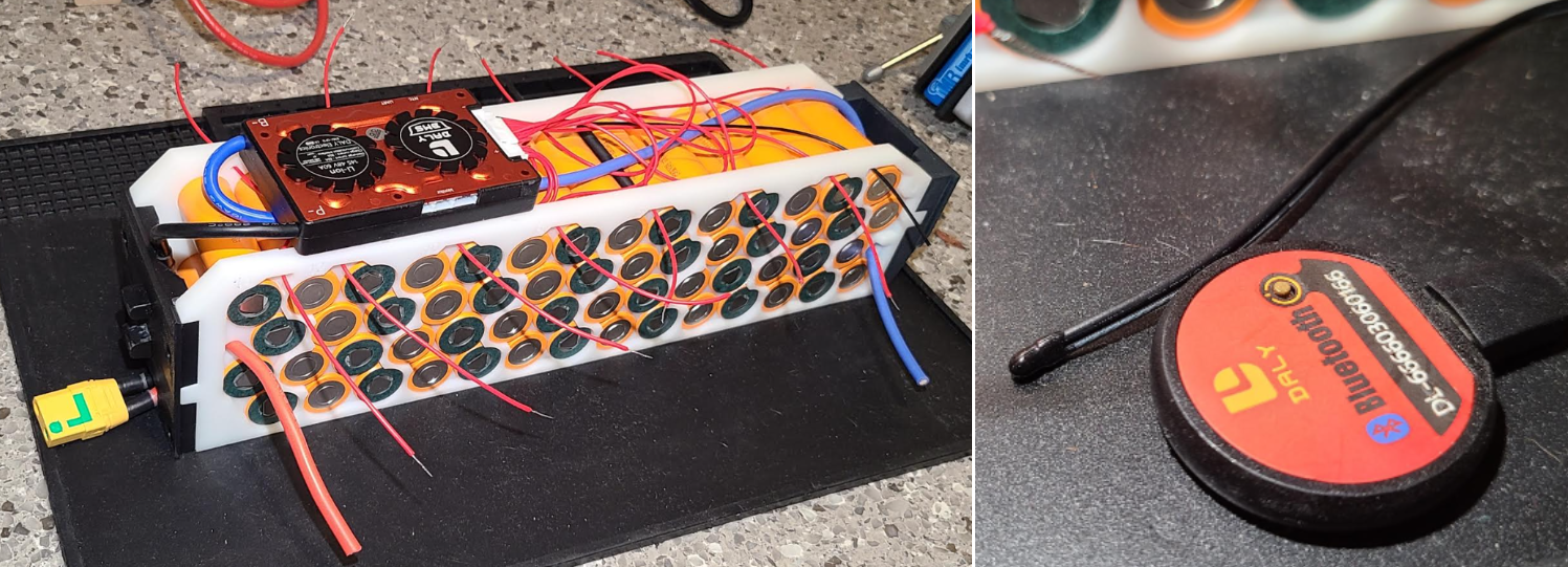

Here's what my pack looks like before any welding or fish paper/tape/thermofrom cover. If I did it again I'd reprint the holders to shift all the cells away from when the connector about 1cm (max they can go and still give clearance for B- lead) so that I could fix the XT90S connector into the end plate - kind of like how Luna Wolfpacks are. That would make fitting the pack in a little easier as I had to enlarge the pass through on the retainer plate that bolts into the frame to make it easier to get the connector through. I had to print the cell holders because the cells are a fraction of a mm too girthy to squeeze into regular honeycomb holders, so after these two packs I need to order some P42A's to use the honeycomb holders I got - maybe not a bad idea for a 13Ah lighter weight pack either. Benefit of printing them though is much stronger materials and having interlocking end plates so the pack is safe and sturdy, probably went thicker than I needed with the cell holder pieces... The frame came with some blade connectors that would work very well for ease of insertion/removal but no antispark and I didn't know how well that would play with the BMS's I got - to be honest if the BMS wasn't common port I'd say the blades are the way to go as long as you're mindful about that switch.
Very cool you've got both on hand. No major disagreements there honestly. I'm assuming you didn't get the LudiV2 controller, or did you?
A few comments below.
  • The Sram GX Eagle 12 speed shifter they fitted to the X2 is really bad. It jammed twice when just trying to test out running through the gears. The upshift lever is also reversed from how Shimano does it which is an ergonomic nightmare... it's really hard to find a position on the handlebars where hitting that thing is easy. The actuation force was too high for shifting down to larger gears, and it just didn't feel very good. It came with a 38T chainring and 11-51T cassette.
Yeah, I think it's actually an NX, but I replaced it with a GX MMX shifter - is ok, $42 or so. Might be whatever you're used to, but I'm pretty ok with the new GX shifter.
Yes, E10 (X2) vs E22(23?) use different shocks, 210x55 for E10, and something like 265x<something> for E22/23/Hydra. Similar travel though - I think the X2 has 160mm rear travel.
Yes, it's annoying. Also too short, and positioned completely weirdly as comes from Luna. Replaced with an SDG Tells 170mm on mine and didn't think about it again. Some of them are 'fidgety' coming from Luna, and may need to loosen the seat post clamp and possibly adjust the cable on receiving, then it's as good as it gets. Might be ok for shorter riders.
Were the brakes bedded in or 'just ride'? Do 15 or so moderate to walking speed hard stops, then let it sit. Or swap pads (and still bed them in).
The G2s are pretty solid on mine, but I've swapped to 200mm F/R, moving to 220mm front, and have changed pads.
No surprise. Looks like Luna is starting to make standalone LudiV2 controllers available, at least for Luna X1/X2 customers. Either of the Innotrace or LudiV2 controllers will have the capability for better/faster responsiveness, as they run at higher sampling rates and overall are just better controllers vs the Bafang OE ones. I suspect 'the torque sensor isn't as good' is really down to the controller, but not 100% there. (They use the same torque sensor on numerous motors, imagine the M620 one is just 'scaled up' but the same general technology etc.).
The M600 being lighter is going to hit thermal cutoff/throttling at some point, well before the M620, when e.g. riding by throttle or under sustained max power. I haven't hit this myself yet, but I nearly never am running in max PAS and never in 'Ludi' max power profile.
Yes on the pedals. Guess it's better than no pedals but replaced on day 1.
It's also 135mm, narrow - at least mine was. Replaced immediately with Ergon SMC-Core. Hard to say if it's literally 'what they can get in quantity' or ?? Would at the least do a wider seat width for a majority of riders.
Interesting. I still need to weigh my X2 with new wheelset, shock, bigger rotors etc. The Alec MD35 wheelset isn't particularly light on the X2 (or Z1) - the motor should maybe be 2-3# difference, so not sure where the others are although some of it may also be in the frame differences. They also use the same rear triangles and rear shock linkage.
Yeah, the question is at what price?

@tomjasz not CNC'd but SLA printed - white is Tough Resin & dark is Somos Taurus. the end plate with the plug is actually FDM printed ABS but I don't think I'll ever use FDM printing for anything like this again. I've used MJF in the past but the surface finish & cost on SLA printing as well as available materials to choose from makes it the preferred choice. The Tough Resin is very resilient in that I can bend and twist the cell holder but not a great deal, and it retains its original shape very well. The pieces I had done in Somos Taurus are too short and solid to really get any flexing or anything out of. I'd like to try getting the cell holders printed thinner (these are 1cm) and in a single piece with just little standoff pegs between the two sides I could cut myself, and see how that brings the price per pack down on the two materials. It'd be cool to compare the Somos Taurus vs Tough Resin as well, which means printing some pieces I'm willing to break...
Getting my little hobby station set up to build batteries I wound up with 5x 14s 60A BMS's and enough 21700's to make 2x 14s4p packs. The cells I picked should deliver ~750Wh at 1000W continuous or ~705Wh at 2000W continuous - slightly lower capacity below 1000W than if the pack were made with 50E2's but considerably better above, though above 2500W not quite as good a P42A. the 4p pack sticks out not quite 1cm from the frame, a 3p would fit flush with ample room to spare, but then it becomes a question of whether capacity within desired output range is going to be better doing a 3p with 21700's or a 4p with 18650's. Honestly break-even on pricing won't even happen until I build and use a 3rd battery pack - I may have to get into drones or RC planes as a side hobby to justify it all.
All in all though once the cells are in the holders there is no flexing or wiggling the pieces around. Held together just by friction pretty well but there are holes for little screws to lock everything in, in addition to pegs/dimples in the design of the pieces (looks like you could pull the end plates off but the pegs & dimples prevent that). Big benefit of the SLA printing is I can include tight little channels with relatively sharp bends for small zip ties to secure the BMS to the cell holders that way. You can't see in the pic but there's also about 1.5mm of dishing in the top edges of the cell holders to keep the BMS centered in there as well. Just took a day with a cell, BMS, OEM pack/frame end plates, and the calipers to get something modeled up, but I iterated a few times in the design which ultimately includes a more solid plate that secures to the bike frame up where the lock is. On some Specialized ebikes you see a little bumper on the downtube to prevent the fork from smashing into the frame - I printed a little carrier to fit some rubber bumpers into that bolts into that plate with the battery lock in it to do just this. I also printed a hanger for the speed sensor that replaces a washer/spacer on the rear axle, and a soft silicone plug to fit a magnet into the rear brake rotor so I'm not using spoke magnets. Magura wants $22 for a rotor magnet but I can print a few plugs for $5 and get a few magnets for less than a buck each sooooo... why not?

I do agree though, I would prefer a mechanical on/off switch for my pack/BMS. I can have complete confidence in a switch like that being disconnected but a sleep state on any machine is never truly off. One of the downfalls of connected technology - easier to operate something with the push of a finger vs connecting with a phone.
