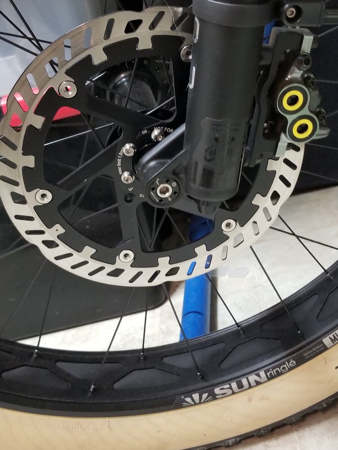

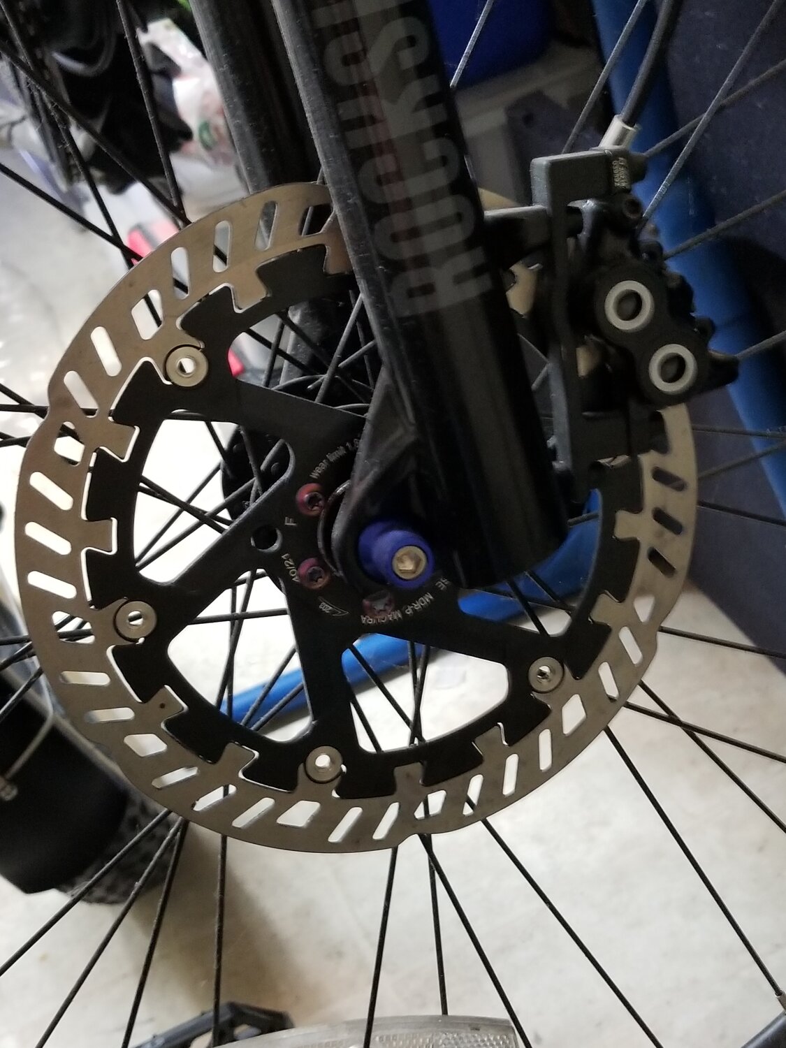

I've installed MT 5e's and 7'e on three bikes now. No warped anything and will bring me down from high-speed, downhill over and over and over. No fade.
I've done serious stops where I had to modulate back and forth from completely locked-up 3, even 4 times. Tail end starts coming around and I let up, straightens out and back to locked.
Using MDR P's in front (both bikes), they came true and installed easy. Only time I've encountered even a cheap rotor being bent, it was me that did it.
Wipe down w/ ethanol. No chatter. No screech. Nothing but predictable stopping power.
Two examples:
I find Storm disks lock up a little earlier, no other differences. MDR P are for serious stuff where rotor heats up.

If outer rim on disc became slightly loose, with your experience you'd know way before catastrophic failure.

I recently watched a video on a new braking setup for ebikes, which include vented rotors!!
Hope V4 220mm's? These rotors ?
They sound awesome. Good stuff on the Hope V4 vs Maguras here.
New V4 Rotor's 288gm. Lighter than MDR P's ‎313gms.
