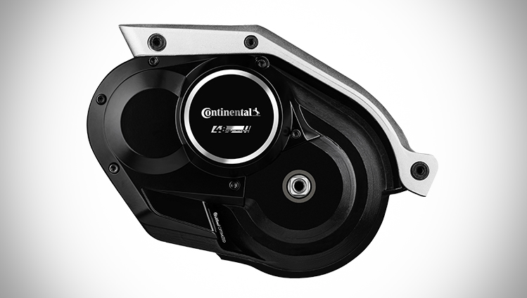

Continental 48 Volt Revolution …
Continental's 48 volt motor and a planetary gear combo promises all the shifting advantages of an Enviolo system, but I have no idea whether these promises have been delivered.
I doubt whether it will be seen as a threat to Rohloff. Of course, Riese & Müller is committed to Bosch.
Here is a link: Continental 48V CeBS Revolution.
Do you know of any bike manufacturer that is using the Continental system? On the face of it they are certainly coming up with some attractive ideas. with controllers. batteries and integrated motor/gear units. One has to wonder whether they will be able to hit the market with products that are as reliable and durable as Bosch. I suspect we will see their products in Europe but not elsewhere.
Kalkhoff and Rose have been mentioned, but the references appear to be for Continental motor-only systems (Prime rather than Evolution).
