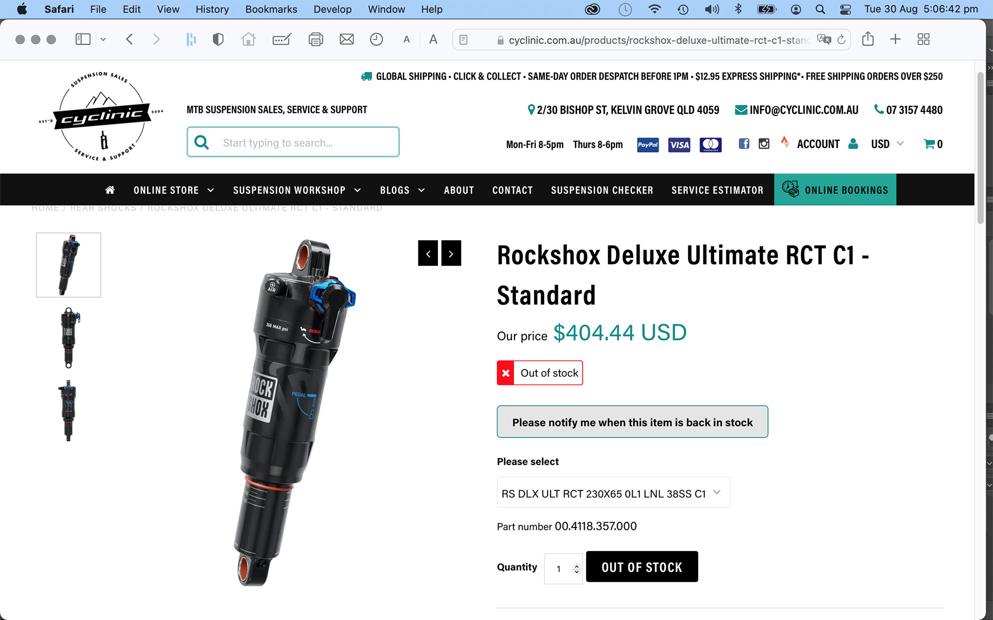

I am experiencing a Suntour rear shock that won’t maintain pressure.
Are there other rear shocks that would be an upgrade that would fit?
JV: purchased a new Homage in July and I am experiencing a Suntour rear shock that won’t maintain pressure. Tried a new valve but no luck. Before I start paying for labor to attempt to fix the Suntour, are there other rear shocks that would be an upgrade that would fit and not throw off the carbon belt set up? Any specific suggestions would be appreciated.
As it was new in July, is it not under warranty.
As it was new in July, is it not under warranty?
I had to consider that issue: pyrrhic victory or cut one's losses?

  • Rockshox
    13000—14000 km
    So far, okay.
    AU$589 (paid by me); no charge for installation (Electric Bikes Brisbane stand by their customers!).

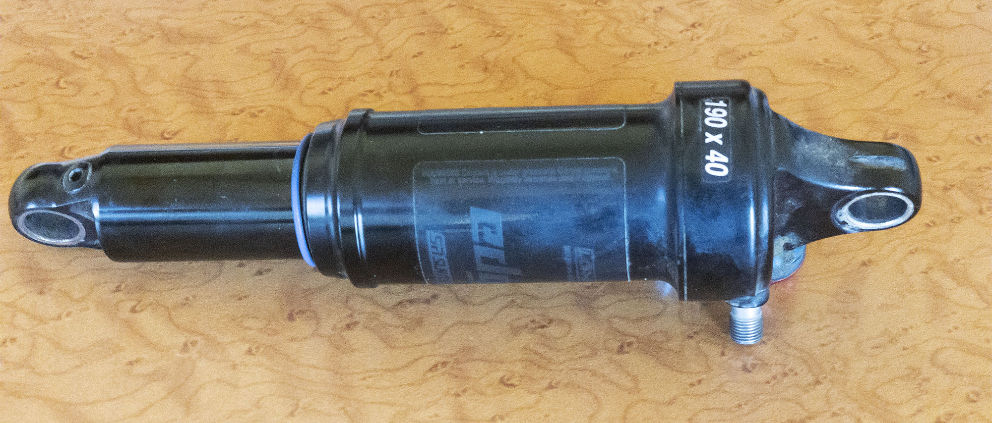

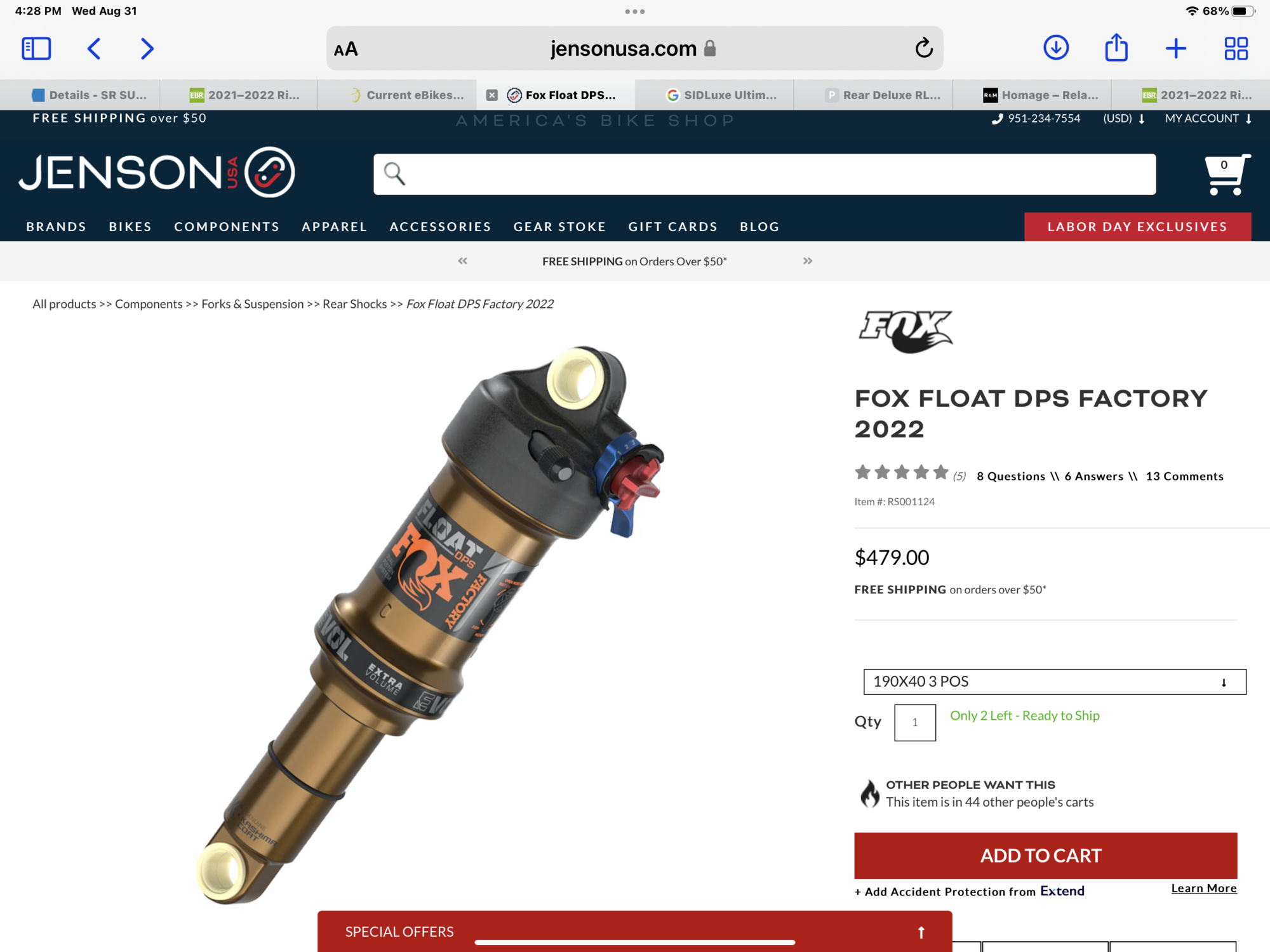

Dave: I am following your lead here. Today I ordered the Fox Float 190 x 40. I have a LBS 10 minutes away, and the R&M is about 1 hour away. Instead of going to the R&M dealer and rolling the dice with another Suntour, I am using the Suntour failure as an opportunity to upgrade to the Fox. Shock arrives tomorrow for installation at the LBS. Curious to see if it improves the ride over the Suntour.

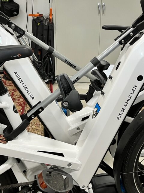

I have the Thule XT and I have the 54 Homage and my wife has the smallest Nevo . It's a really tight fit to get both bikes on the rack. The only way it works is to have the Nevo closest to the car and the Homage second. I don't think it's ideal to have the heavier bike in the second "slot" but that's the only way it works.
I have been really surprised at how heavy the Homage is even with the battery removed. I had the Gazelle Ultimate before and it's a lightweight in comparison. There is 10 kg or more than 20 pounds difference if the specs on the Citrus Cycles website are correct.
I am starting to have second thoughts about taking these bikes on our annual 2200 km trip to California. I know Alaskan has done long trips with two bikes on his rack but he found a way to support the rack with an additional strap off his car roof. I would have to buy a roof rack with a cross strut to get an anchor point on my X5
I have done about 250 kms on the new Homage. I am really enjoying it but its a big brute of a bike. I had a very limited triathlon career many years ago and still remember the light and nimble triathlon bike I had. The Homage is at the other end of the scale. Think Porsche 911 versus Hummer.
I have a 54 Homage exactly like yours. My wife has a 49 Homage. Both are from the 2021 model year, and both are single battery. We recently acquired a Thule XT 2 rack. Both bikes fit securely on the rack, but I had to use Thule Frame Adapters for step-through bikes on both bikes. The two 2021 Homages fit the EasyFold well with the frame adapters, and not at all without the adapters.
Regarding the strap that goes to to of the hatchback, I didn’t want to do that with my car's glass roof. Instead, I ran a strap with a buckle forward of the wheel trays, under the base, and back to the buckle. That prevents the tilt from opening if becomes unlatched.

Great Homage thread. Being a plus-size rider I'm not happy with the rear stock shock. I just placed an order for a Fox FLOAT Factory DPS Remote Lockout Rear Shock 190 x 40mm and had to purchase the Fox Shox Remote 2-Pos Fork/Shock Lever Assembly to go along with it. I spoke with ProCloset Shock tech person who assisted me in feeling better about using the shock and them as an online seller: https://www.theproscloset.com/produ...p-evol-sv-ptu-pivot-mach-4-sl-md-xl-190-40-dc

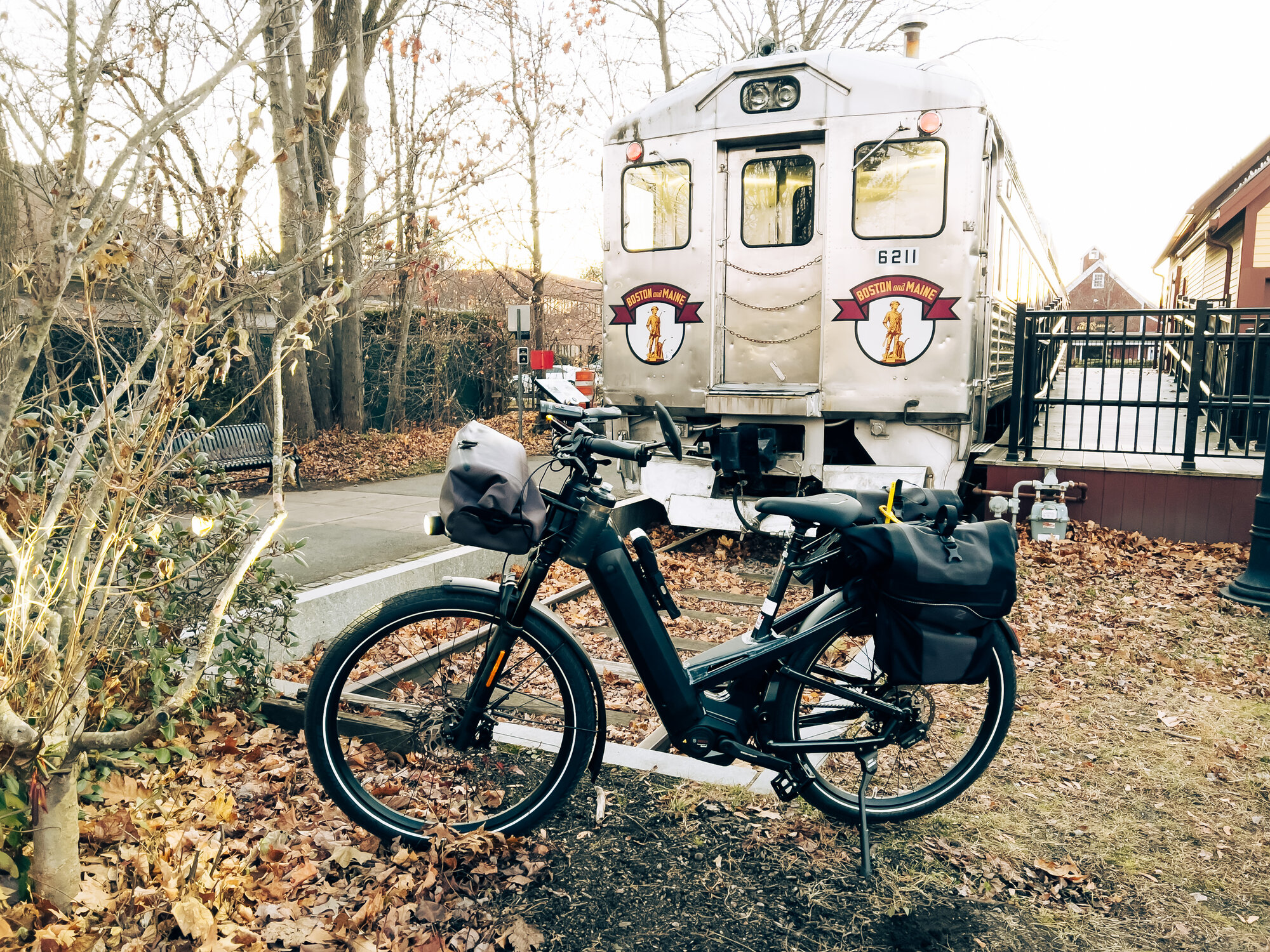

My Homage HS Dual Battery with Rohloff E14 during my ride on the Minute Man Paved bike trail in MA
I’d love to hear how it rides after the “upgrade”.
I think the one remaining upgrade the Homage needs to make it the PERFECT bike is a Fox upgrade option. I have twice nearly pulled the trigger on upgrading my wife’s Homage with Fox as a surprise present. But if I am being honest it is because I feel guilty riding my SD Mountain with Fox with her on her Suntour suspension.
Fox has made me such a suspension snob!
Jay, that guilt is precisely what spurred me into putting a Fos suspension on our 2019 Homage. Nancy deserves at least as much comfort and care as do I, if not more.
