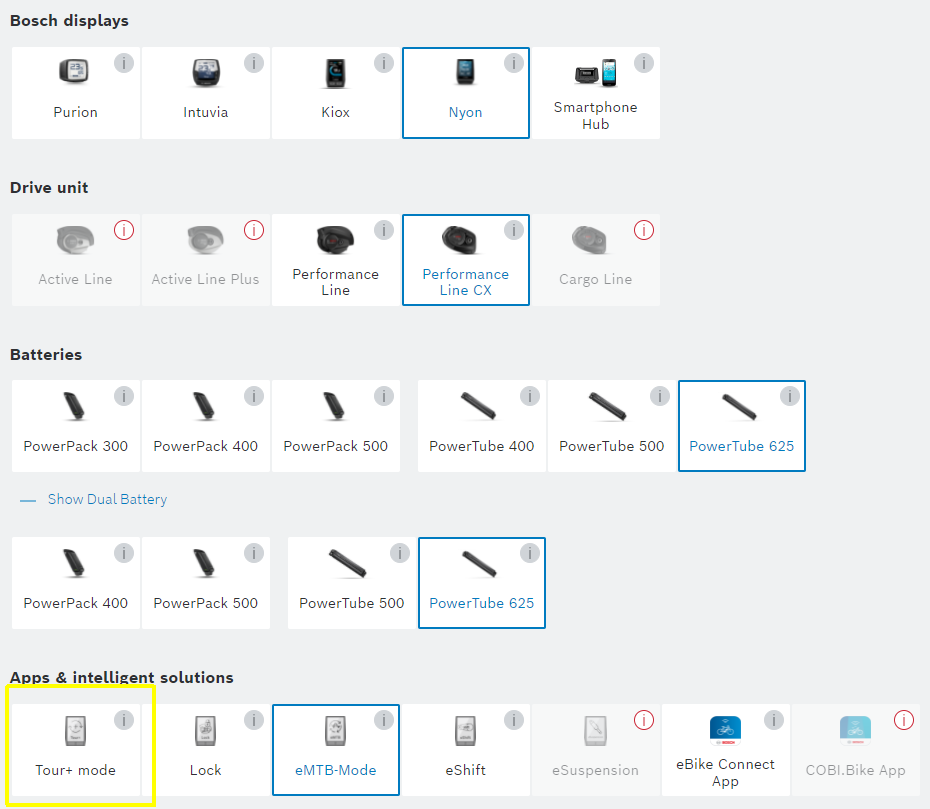

I cannot find anything on the Bosch website which is currently showing a restriction to chain drive models.
If the higher assist level eMTB mode works fine on my belt-driven Rohloff bike, why would the lower assist level Tour+ not work just as well?
That seems counterintuitive.
@webcurl:
Why cannot the OP upgrade to the Tour+ mode if the Bosch website tells us it is doable?
Granted, it would be clearer if they had a 4th category to specify - drive-train to then spell out compatibility.
Yeah, I have read the "derailleur only" under the Info. I think Bosch has made it all too complicated.

Hello!
Availability of specific riding modes depends on what the OEM (R&M in this case) programs the specific model of eBike to have. The easiest way to tell what is available for a specific model is to have your LBS plug into the diagnostic tool, and start the update process. At the beginning of the update process, the Diagnostic Software will offer a choice between any available options. This may be a choice between eMTB mode and Sport Mode, Tour+ and Tour Mode, or no choices at all. It is based completely on what the OEM wanted to make available on their specific eBike product.
I hope this helps!
Hello!
I hope this helps!
"The new Tour+ riding mode of the Bosch..."
and: "The Tour+ riding mode is available for eBikes with Drive Unit Performance Line CX and eMTB mode since summer 2021"
Let's say hypothetically only one OEM chose to make Tour+ available for their bikes, my question would then be why is Bosch advertising it as a feature that seemingly is available to all but is not?
My understanding is that the majority of OEMs are enabling Tour+ on their Tour+ compatible products. To be safe, I always recommend the individual eBike is checked anytime specific software features are in question, rather than putting potentially false/speculative information out there. I suppose one might also be able to contact the OEM, and/or read the product page, but I'm not sure how well that will work as different OEMs don't always list software feature details on their websites.
Bosch shares engineering information with OEMs to ensure a proper/successful integration of the Bosch System into their eBike product, but we very rarely have exact details due to OEMs' proprietary product info, etc. For example, we usually won't even know what display will show-up on 'X model' eBike until we see it complete.
I hope this helps!
I hope this helps!
