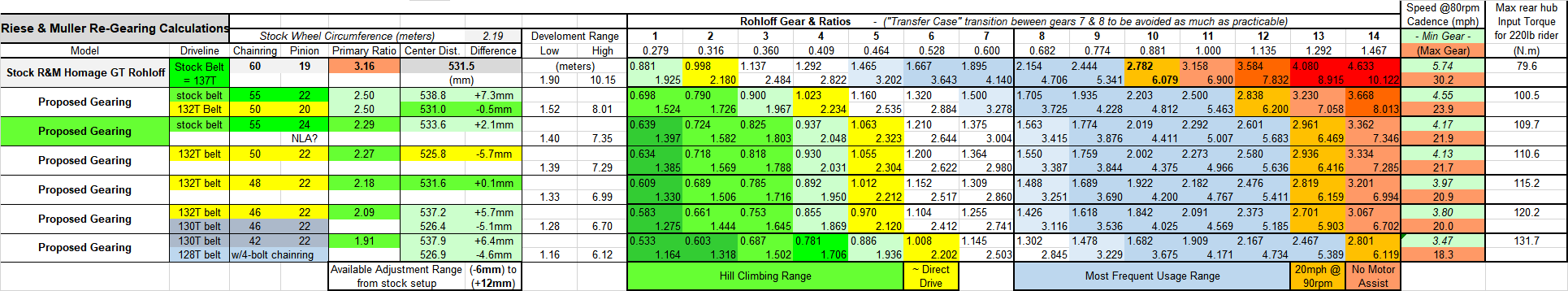

I feel like the gearing on the Rohloff Load is already low enough for me given that it starts with the 55, in 1st I’m going slow enough to be borderline balance constrained with the dog up front, and my cadence is lower than yours, but very curious to hear the results!
And yes, as show in the spreadsheet clips in my first posting, the Rohloff equipped Load models come stock with 55/19 (2.89) versus the 60/19 (3.16) gearing on the Homage and DeLite models equipped with a Rohloff hub.
So your Load's stock gearing is already 8.3% lower than my stock gearing (or 9.5% depending upon how you calculate it).
That much difference would be noticeable.

My most used gear range is also now above the 7th/8th gear split, so the Rohloff will shift better and be in the most efficient range most of the time.
I am very happy that R&M agreed to accommodate my request to change the gearing ratio of the belt drive.

Just for fun {and because I LOVE playing with spreadsheets and gathering data!} I updated my spreadsheet to include some lower primary gear ratio options.
Here is the result:

I wanted to compare the overall ratios of this bike to my present one, a Priority Current with the Shimano 5-speed hub (which I love, by the way). Just in case anyone cares, 1st gear on the Current (1.393) is about 4.5 on this Homage, and 5th gear on the Current (3.664) is just a shade over 12th gear. So, I would get about 3.5 lower gears, and 2 higher gears. Which is good (for me).
Pedaling at 28mph on my Current in top gear is too bloody fast (for me) at about 94rpm, and on the Homage/Delite, I calculated about 74rpm (much better!).
