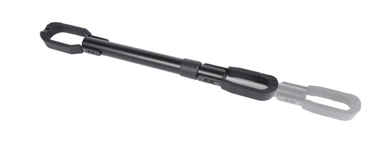

I am in the market for a service rack for a homage. I want value as I'm not going to use it much I hope. I have a dropper seat.
Most racks connect to the top tube that the homage does not have. I need to hear from people that have racks that work well and what options to connect. I want the ability to service the front shocks as well as removal of rear wheels. Preferably less than 150.00
You can buy a false crossbar, which fits between the stem and the saddle post to clamp on.
Something like this.

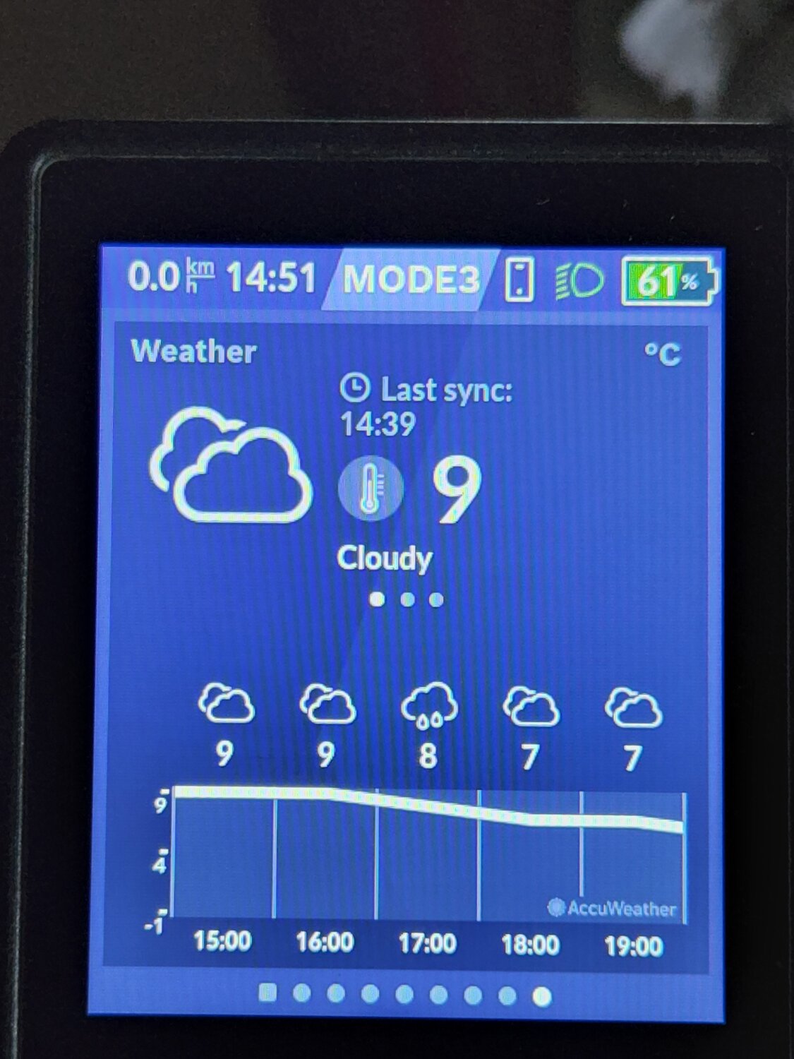

Yes, I agree, an inbuilt ambient temperature display would be useful.
The lack of it is partially compensated for by the weather screen.

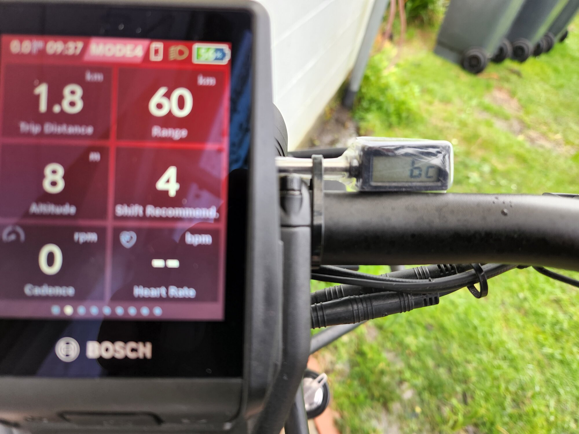

To be able to know what the immediate ambient temperature is, I attached a cheap ($13) digital display temperature probe to the handlebar. It works well but doesn't have back lighting for night-time viewing.
