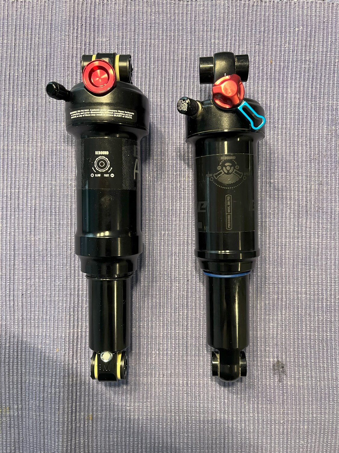

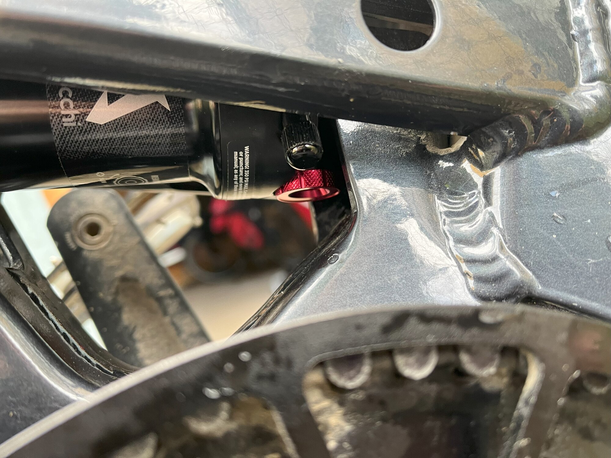

I got the same problems with the suntour rear shock like many users. Significant Loss of pressure within in short period of time. Today I replaced it by a Marzocchi Bomber Air Inline rear shock which is recommended by Marzocchi for my Marzocchi Bomber Z2 fork. (Due to the supply problems during covid r+m equipped the Rohloff variant of the homage with this fork.) A minor problem is the position of the valve which is closer to the frame (second photo) due to the shorter "neck" of the Marzocchi spring element in comparison with the original Suntour shock (first photo). As a consequence the original BETO pump provided by r+m can't be used anymore, since the valve head is too long. But a fox pump with the flexible valve head should work very well.
There was just one aspect, which irritated me. The Marzocchi spring element has got no lever for adjusting the pressure stage, although the product picture of my dealer had one. Apparently there are two variants of the Mazocchi Bomber Air Inline rear shock. I wrote to Fox to explain this difference. Hopefully they will answer soon. Since I use my Homage only as a commuter, this missing feature doesn't matter for me. I didn't use the firm position the last three years.

After 50 km with the Marzocchi rear shock it's time for a first conclusion. It does its job properly after I increased the rebound by some clicks starting by the value which is recommended in the manual. This was necessary because of the higher mass of the rear wheel with the Rohloff speedhub. Hopefully there won't be any significant pressure loss in the future.
