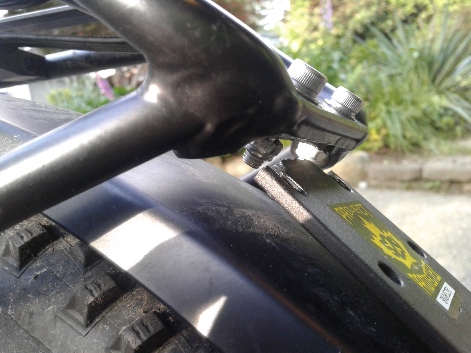

My rack bridge plate broke again on my R+M Charger. I know the drill now so I rode to my LBS and asked the service manager to take a pic and start another warranty claim. It is still under warranty for another 4 months so I am sure they eventually will send my LBS another replacement and in time it too will no doubt crack. Bottom line is that this is a design flaw. I have another good bike now so there is no smoke coming out of my ears . It is a overall a very good bike but if you expect perfection for your money you may be let down.

Hi Steve. That looks very unsatisfactory. Forgive me if I am being obtuse, was it the mounting plate on the frame or on the rack itself that broke? Also do you know if the broken component is steel or aluminium? The reason I ask is because if it is the rack, and it is made of steel, do you think just beefing up the bracket would solve the problem? In your view what is it about the design leads to the component failure? I am genuinely curious about this. I do a (very) small amount of hobbyist metal fabricating and welding at home. I have made pannier frames for a few different motor bikes I’ve owned. I have noticed aftermarket motorbike pannier frames can be pretty light on. So I am wondering if this is the problem here.
HI Bruiser. It is the connecting plate that bridges between the rack and frame. The first one was aluminum and this replacement was steel. The rack is rated at 25kg and I never approached that. When this one broke I had 2 batteries and some clothing on it. I do not know why it breaks. I can theorize that there is too much vibration etc... but I am not a mechanical engineer. The bike has 21,000 km on it so they have lasted on average about 10,000 before breaking.
HI Bruiser. It is the connecting plate that bridges between the rack and frame. The first one was aluminum and this replacement was steel. The rack is rated at 25kg and I never approachd that. When this one broke I had 2 batteries and some clothing. I do not know why it breaks. I can theorize that there is too much vibration etc... but I am not an mechanical engineer. The bike has 21,000 km on it so they last on average about 10,000 before breaking.
Hi Steve thanks for the reply. Just looking at the photo it looks to me like the plate is only supported by two bolts near the fracture point. Plus there are no washers underneath to spread the load. If there is movement/vibration at a pivot point, then clearly the metal fatigues over time. Although you shouldn’t have to, it looks like the design could be rectified with thicker plate steel. That‘s just speculation on my part though.

Similar things have happened to the Supercharger. But as i said the new Supercharger and Charger have completely different racks & rack mounts.
