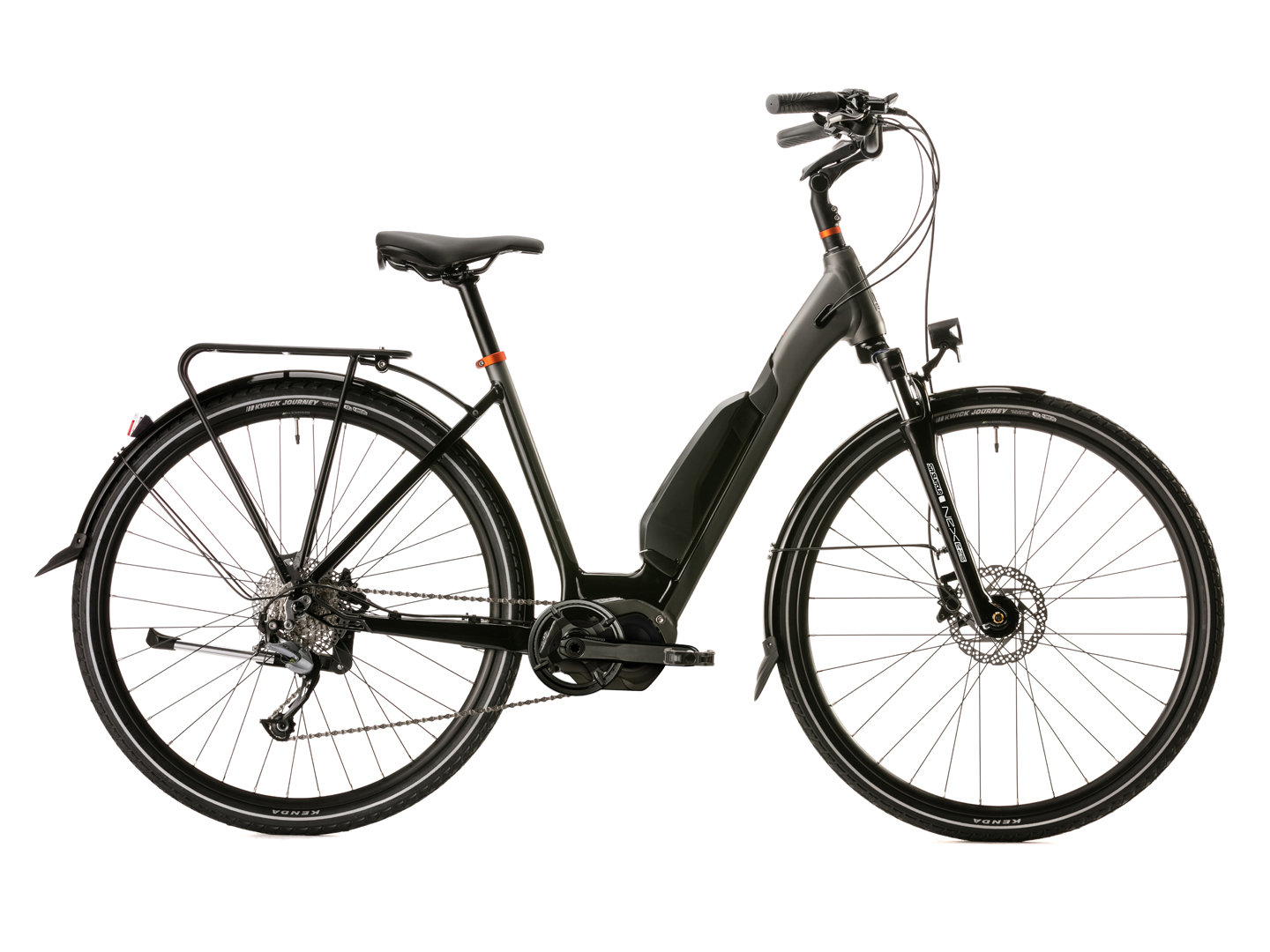

I think that integrated batteries can look good, but so can a well implemented external pack. Check out these two bikes (they're very similar, except for the type of battery pack):
Opus Connect LRT
Opus Connect LRTi
I don't think the integrated battery looks way better, and on a technical level I prefer the external battery pack.

I prefer the external battery that is well integrated... a clean design with cheap and easy replacement.
The Connect LRT with the Shimano STePS E-5000 motor and E-8014 418Wh semi-integrated battery
The regular Connect has an E5000 motor, whereas the Connect LRT has an E6100 motor.
But I agree with your comment about cheap and easy replacement being desirable, and that some companies have managed to integrate external battery packs attractively which gives you the best of both worlds IMO. In addition to simplicity, there's also greater universality to external batteries. Bosch (for example) has at least three mounting configurations for internal batteries (one of which is specific to certain Trek e-bikes), whereas there's generally only one mounting configuration for external packs. There might be different capacities, and sometimes different shapes, but within a brand generally any external down-tube pack is compatible.
I prefer the looks of the LRTi. Very stealthy.
