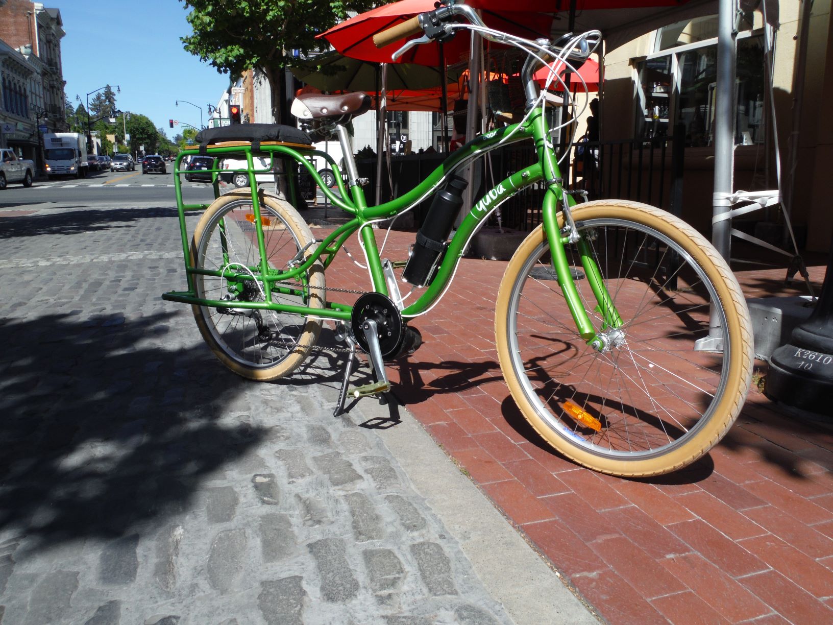

You see in the avatar my battery is mounted out over the front wheel, also. My inseam is 28". I prefer 26" wheels so my teeth don't rattle or I bite my tongue when I ride over a pothole. When I am in line at a stoplight, or when rain covers the pavement, I can't see them.

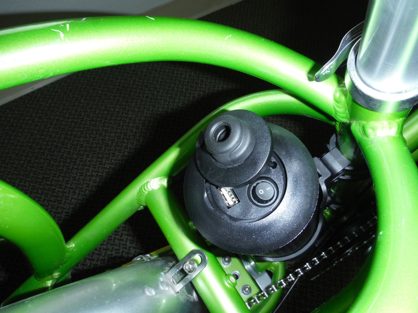

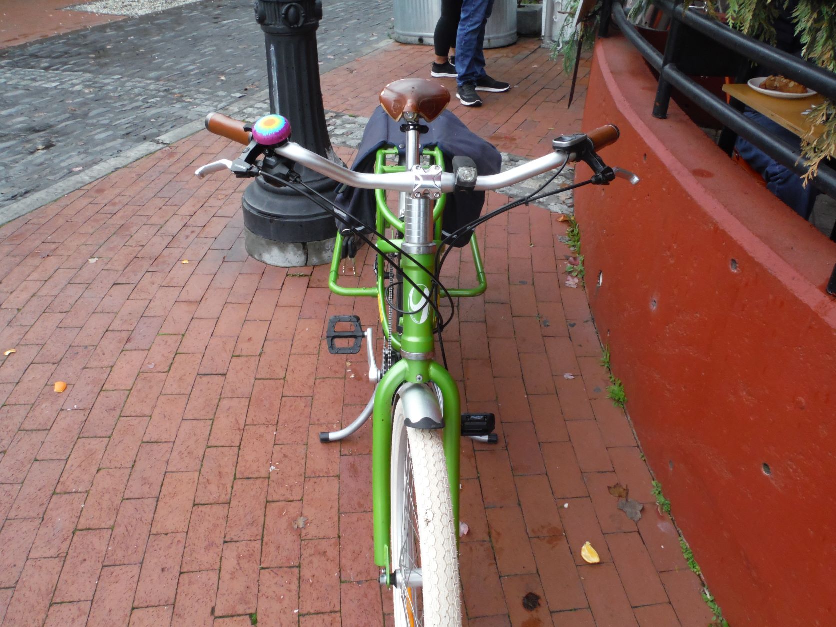

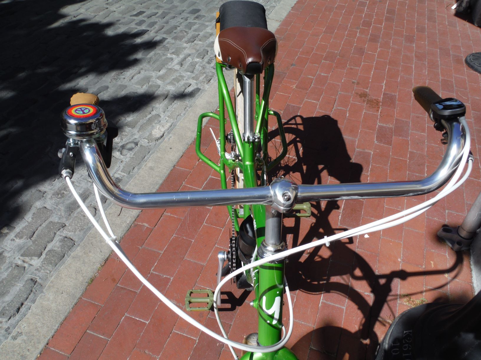

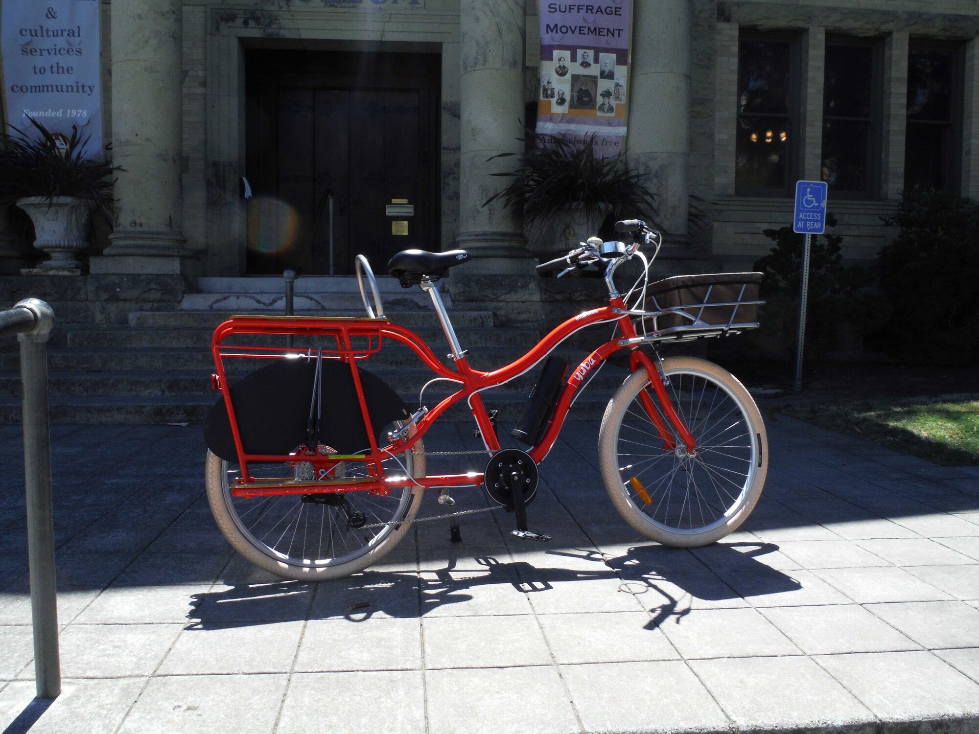

My yuba bodaboda is aluminum, about 72 lb without bags motor or battery. 5 1/2 years so far, ~12000 miles, frame wheels spokes crank bars are fine. Unfortunately this model is no longer for sale. The replacment yuba bike has a steel frame 24" wheels and a mid-drive. If I were buying now I would buy a blix packa.

You see in the avatar, there is extra 6" of frame behind the seat before the rear wheel. My bodaboda. Puts my weight on the front tire, the cargo weight on the rear. I need the stability, I don't like pitching on my chin when the front tire whips sideways. As 3 modern 26" wheel bikes have done to me since 2008. I don't understand the reference to dutch bikes, all bikes but gazelle come from China IMHO.
