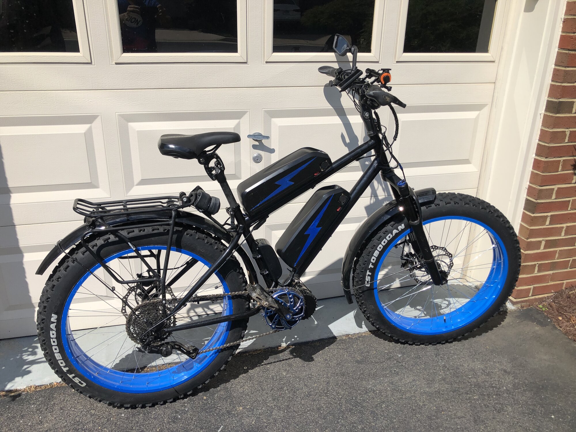

I did that, suspension seat post, a Suntour. It helped a wee tiny bit, but I lamented not having the rear suspension big time. It was the height of the panedemic, bikes were in short supply so I could only get a steel framed hard tail Mongoose Fat Bike.

I'd wait on investng in the controller. That motor with the stock controller is pretty powerful. It will snap your chain easily if you are in the wrong gear. Adding the controller later is easy. I addded a second battery, 37.5Ah total.
Also, I did have the Shift Sensor in the beginning. Later took it off. Not necessary if you know how and when to shift.

I did not have tubeless rims on my fatty, I have them now on my Z1 and my Frey Savannah CC. Get tubeless rims, that way you can run at 5lbs psi, which is where you wanna be in the snow, sand, mud, or woods. Especially if you don't have a rear suspension. I had lots of pinch flats in the woods due to rocks and roots. I eventually solved the problem with Tannus Armor inserts. I never had a flat after that.

Go with a robust hub and cassette. I went with Microshift 9 speed, steel cassette, 11-42, with matching derailleur and trigger shifter. Luna 42T Chainring. It was a good combo.

My Mongoose fatty had the cheapest, crappiest brakes you could source in China! Still using them and they work real well. They squeak, they need adjustments, but they work real well. I did upgrade my rotors from 160mm to 205mm.

You can throw away the Bafang stock chainring. It won't hold the chain. Serioulsy. I went with Luna chainring. The cranks are fine. The fatty profile should be high enough where you don't get pedal strikes.

I tried the Kenda 4.5" Juggernaut Pros, running with tubes. They sucked. Sidewalls deteriorated catastrophically.
If I had to do it over again I would have gone with a rear suspension frame with 2.8-3" tires. There is no real advantage to 4" tires except on the beach. They do get a lot looks, stares, and oooh's and aaaah's though. My riding buddy had a Sondors Rockstar, clearly a better bike in every way. Nobody even noticed him. they all came up to me to ask questions about the bike and admire it. I'm convinced it was the 4" tires and wide blue tims.

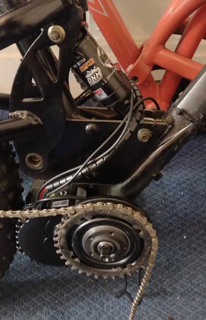

I did a BBSHD conversion on a Surly Wednesday.
A fun bike for trails.
Not a difficult conversion.
